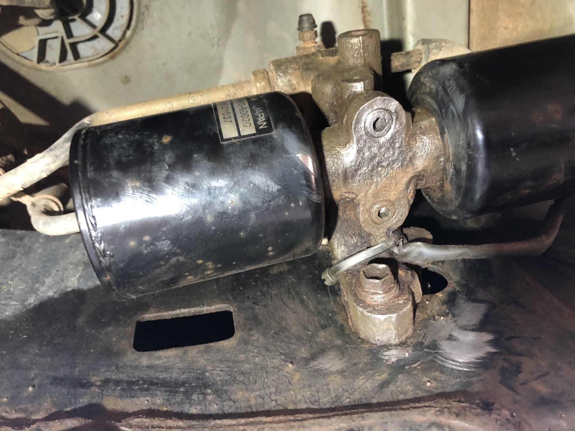

I Was down in the area scraping rust this morning, before coating with LPS3. I noticed this cord that tucked into the frame. I then realized it was attached to nothing. Anybody know what this is? Pardon my rusty underside, I'm slowly working on improving things 1 at a time.
Post cleanup pic. Still not pretty, but much better than it was. Loosened the KDSS bolts 3 turns, coated the threads with Permatex anti-seize, then coated the entire area with LPS3 rust inhibitor
I I noticed this cord that tucked into the frame. I then realized it was attached to nothing. Anybody know what this is?
It's discussed in posts 14 - 21 in this thread; generally believed to be something for a Lexus, either power for illuminated side steps or related to AHC something or other. I forget if I've seen a definitive answer, but it's a regular question once people stumble upon it down there.
