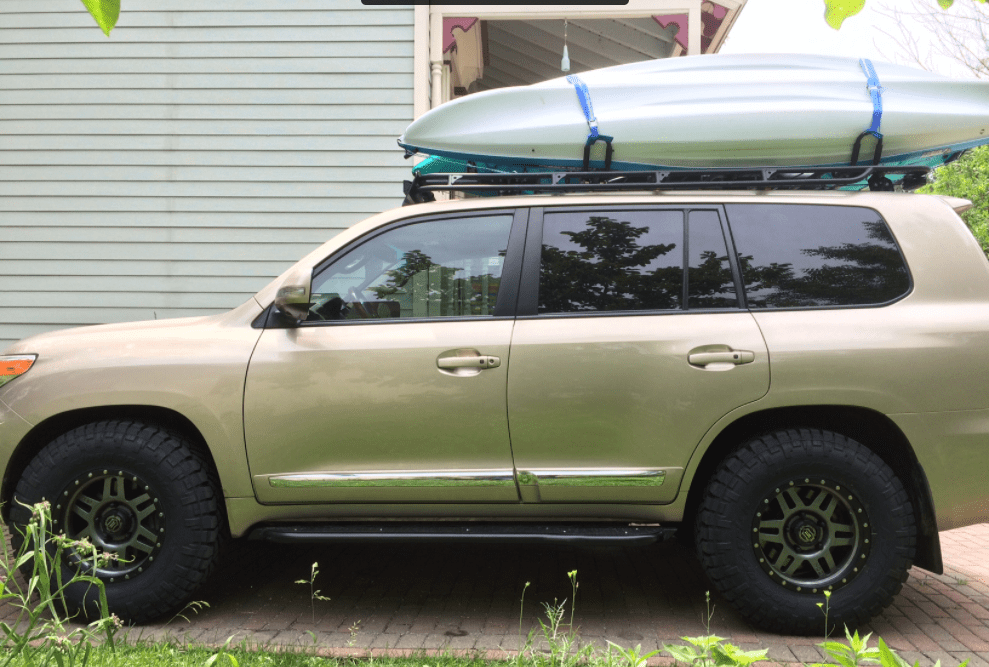

If love to see a pic of your truck with the strut spacer on...
There's a photo in this thread but it's on 34s, not the stock 31s or more typical 33s on RW wheels that many people have, so the tire proportions may not match what you have. Also I have a set of Firestone air bags inside the rear coils, so that lifts the rear about 1/2" when unloaded.

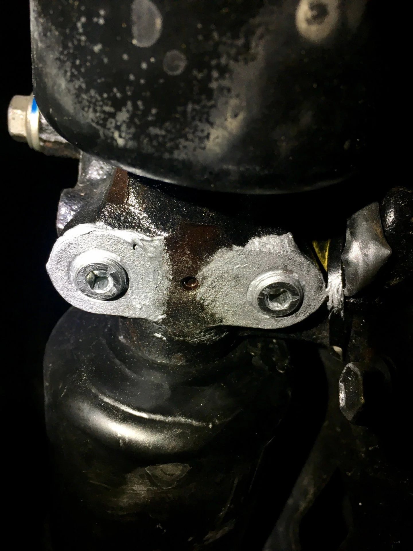

After reading this thread the other week, I decided to check the KDSS screws. I sprayed some PB Blaster on them, waited a few minutes and check them. Glad to report that they moved freely and have very minimal rust no the surface. Mine is a 2013 with 112K and spent all of its life up un
Yesterday I was crawling around under my new-to-me 2010 LC, marveling at how clean and rust-free the chassis appeared. Today I went out to specifically look at the KDSS valve and it wasn't nearly as pretty. I tried some light pressure on the bolts without success, but feared getting too aggressive lest I strip out the heads.
The lift is still a month or two away, so time is on my side. I'll follow the OP's lead and will spend the next few weeks soaking them periodically in 50/50 acetone and ATF. If I get a wild hair, maybe I'll dab a little muriatic acid on there. That stuff eats rust for breakfast, but it's as dangerous as the devil.

Just want to thank the OP about this AeroKroil oil treatment. My 08 LC200's KDSS screws looked bad upon inspection (this LC spent its first 4-5 years in New England). PB Blaster/WD40 did not help; after a week of soaking, mechanic stood under truck with long ratchet and proclaimed that the valves were frozen shut and he did not want to strip the screws. Been hesitating about visiting welding shop.
Then sprayed with AeroKroil Oil once, both screws came loose upon first try about about 3 days. $20 well spent.
Without them coming loose, my Tough Dog susp would have to wait until who knows when. Now, on to installing TD.

Its been over a year since I sprayed the KDSS vlv's with LPS 3 and there is no new rust and valves move free.
When I had the cover off I reversed the connector in question so it is on the inside of the KDSS vlv cover. I just figured it would be one less thing to get torn off by a branch.
Did you spray the LPS 3 on the threads, or did you use some sort of other Anti-Seize Lubricant for that part, and only put the LPS3 after the screws were screwed back in? I have some LPS3 left laying around (from your suggestion when installing the budbuilt sliders). I do not have any specific Anti-Seize Lubricant around, curious what others used on the threads specifically. Mine broke free after 6 days, now i want to treat them right

I put the LPS 3 on the exposed threads when the valves were backed out no more than 3 turns then torqued. I then sprayed LPS 3 on all of the cast surface of the KDSS valve. I just crawled under the cruiser with a flashlight and there is a 3/4 inch square area of light rust on the front leading edge were the cast meets the frame and the bolt holds the assembly to the frame and is in direct line from a blasting of road slush.
Not bad results for one application and a couple of years of exposure of what ever they use on the roads in the winter around here.
