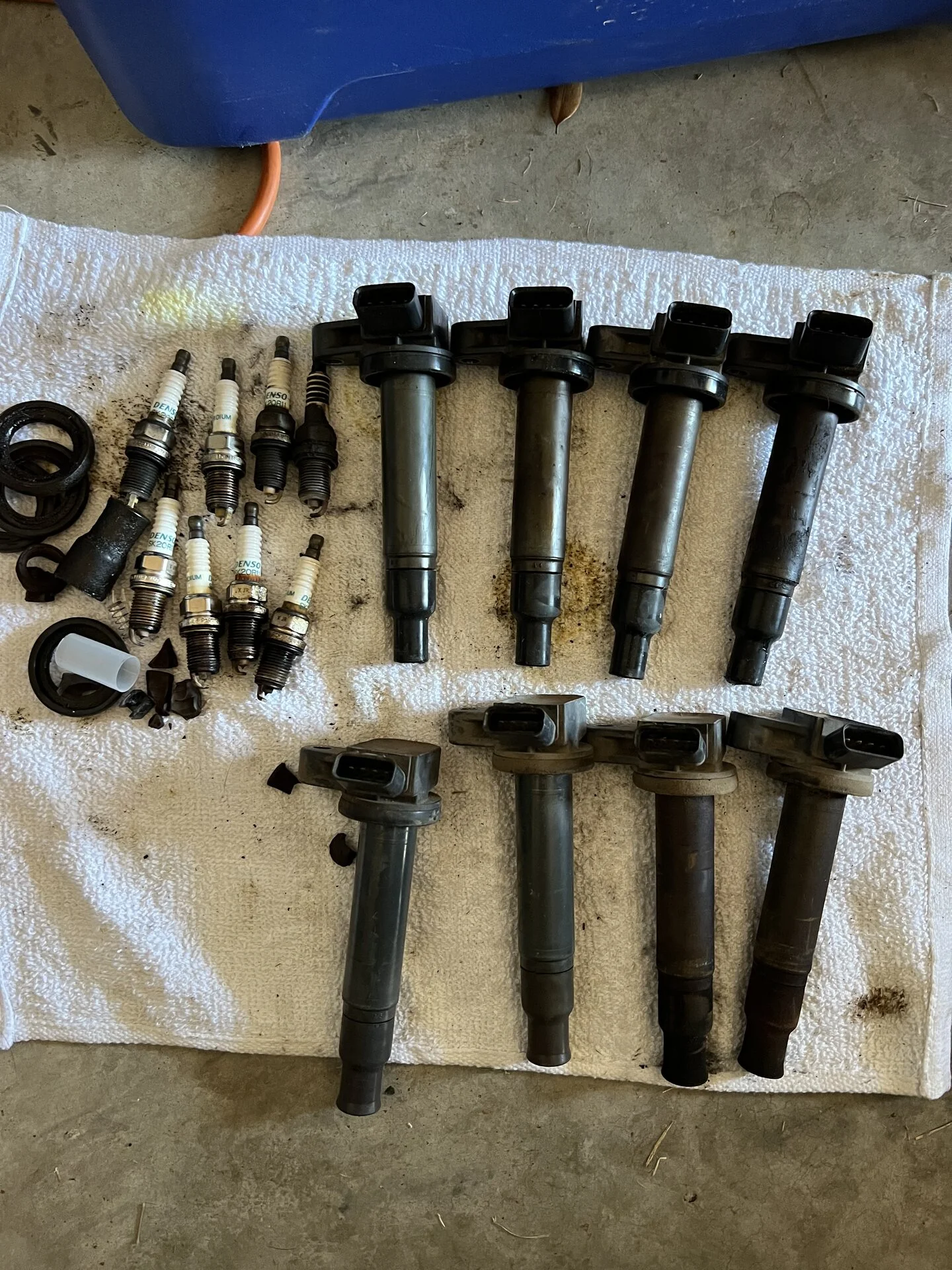

Decided to address spark plugs today to have a look guessing they probably only changed maybe one time in the 256k miles prior to me owning this vehicle.

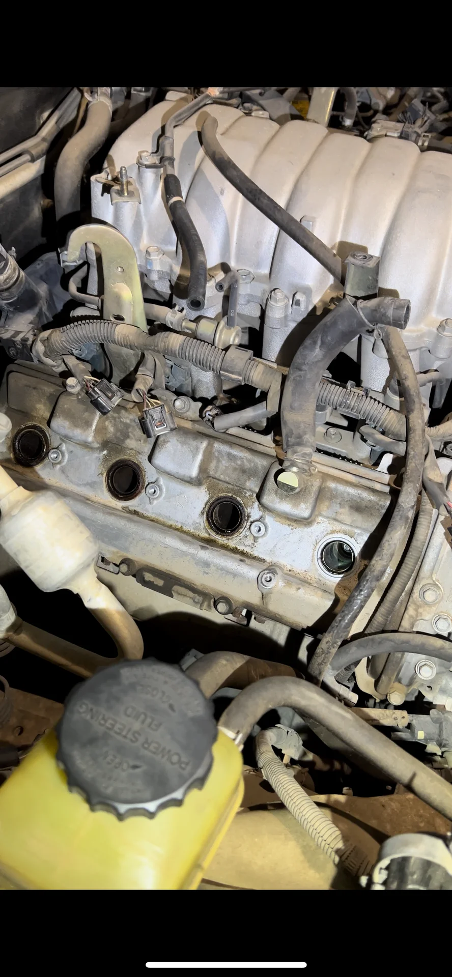

Upon removing passenger side ignition coils it became apparent that some things were overlooked..
The worst were 4,6, and 8 with 8 being the baddest of the bunch. All the coil packs were cracked or have hairline cracks 2 was the best looking one with no cracks or oil.
The spark plug and coil in the photos are from #8.

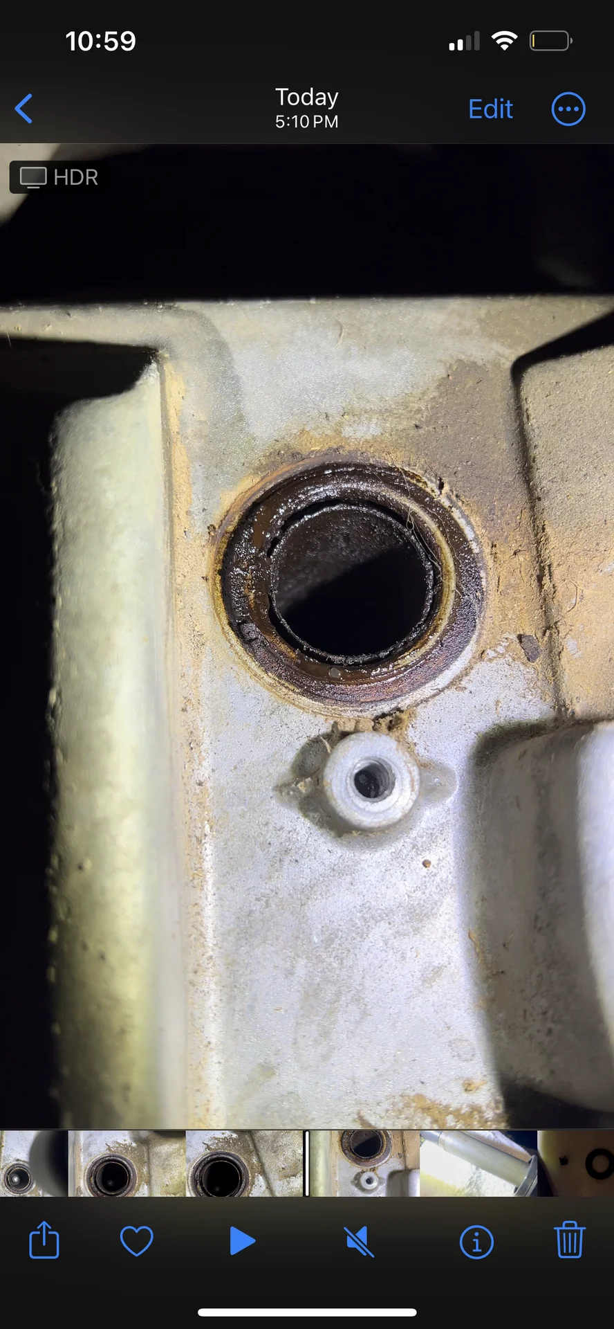

The valve cover gasket was replaced at 220k miles so roughly 35k prior to my purchase but the note is vague as it states “valve cover gasket(s) replaced.” I’m thinking they didn’t replace the spark plug seals in the valve cover. Or if they didn’t touch that side at all.
Im thinking my plan of attack will be to address the coil packs and do the passenger valve cover gasket so I can be sure all seals are replaced !!

Looks like tube seals and gaskets are in your future.
Yesterday I replaced the plugs and original coils on my 237k mile Tundra, all 8 coils were cracked. I believe 200-250k is what you can expect to get out of them. I purchased OEM Denso parts from Rock Auto, much less expensive than from the dealer.

Thanks for the lead on rock auto ! They are actually the cheapest I’ve seen online going to order a pack today just going to assume the other 4 are shot as well. the dealer price is ridiculous..

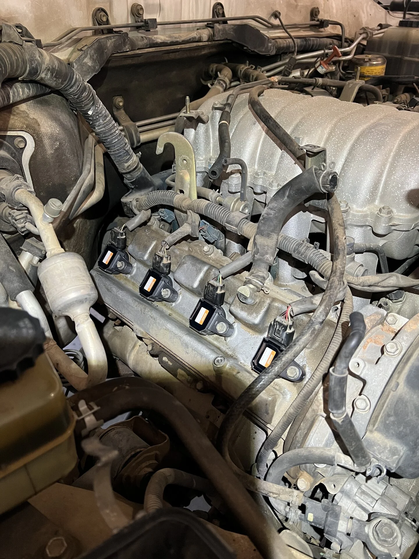

So far dropped in new Ignition coils and spark plugs all ( 8 ) greased drive shaft front to back and have put a set of 33 in tires with some 16in painted rims ( got them dirt cheap from a buddy) water pump / timing belt/ valve cover gaskets up next . Then will start addressing all bushings and ball joints as needed ! I’ll drop some pics below.
