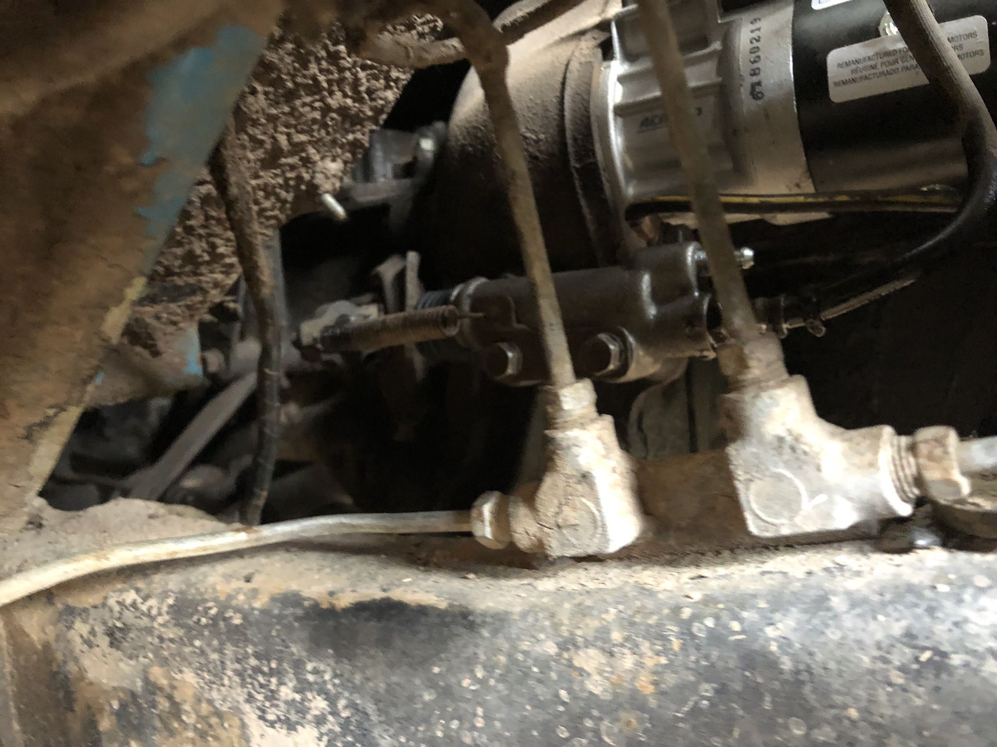

We had the original owner drop it off at my parents place in the White Mountains where I quickly got to work on it. When he sold it to us he told me it had a bad slave cylinder and even included a new one, so I was able to start it (after a jump) and drive it to the barn to get the slave replaced and keep me out of the rain. Took only a matter of minutes and it’s really an easy job when you can fit your head in the entire wheel well!

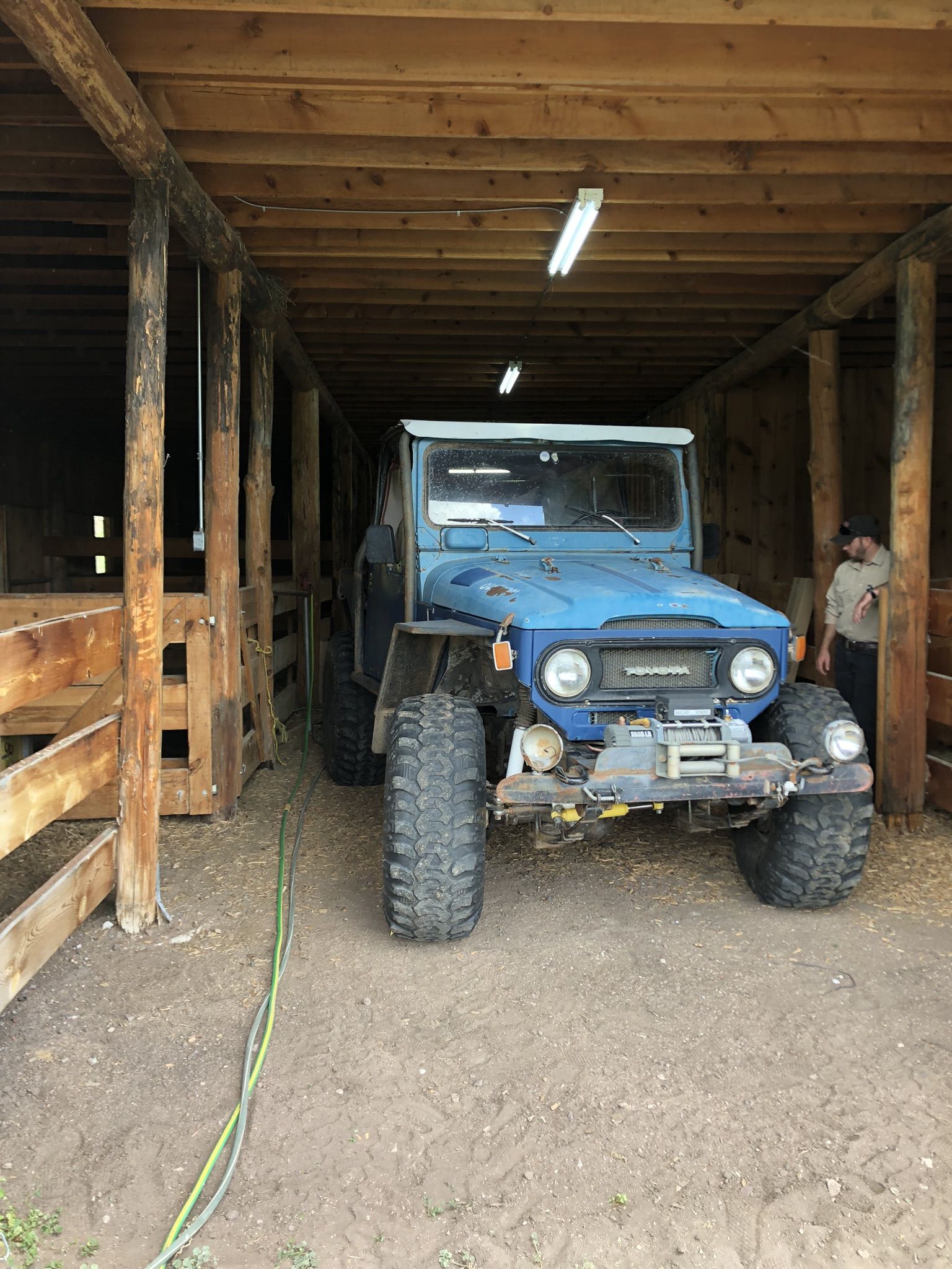

Got it replaced and bled and it was nice to have a clutch again! Took it for a short drive down the pasture and once it started raining really hard, it died right outside the barn. It would start up but I couldn’t get it to idle and after confirming it had gas realized it was very, very VERY old gas. We limped it over to the barn again and we subsequently pumped all the old gas out of the tank. I took the top of the carburetor off and emptied the fuel bowl and replaced it with some fresh 91 octane. It really liked that and started up! Without hesitation my brother hopped in the thing and drove it up the mountain. It did awesome!
