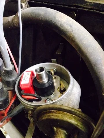

Got the Pertronix (91661), trying to install, and the black part (magnet sleeve) will not sit down in the distributor enough to allow the rotor to install far enough on the shaft. It says to press down firmly, and when I do, it will not sit all the way down. Is there a trick to it?
The magnet sleeve has a part that necks down, is that needed? Does not look like it will fit into my distributor? Can the necked down area be removed?

Here is my'71 F sits down flush hope it helps. If I remember right you might need to push down harder?:)

I wouldn't remove that piece, until you talked to Kurt at Cruiser Outfitters. Maybe just needs to have the edge cleaned up and a little lubrication to help persuade it in.

spoke with Kurt yesterday, and he had a few ideas to get it going
So I don't know what all was going on with this, but not surprised in the least bit.
After giving everything a good once over, I went for it. I took off as much material as I thought safe from the magnet sleeve (it has a necked down area for spacing, I posted a pic earlier) and sanded off excess material from the bottom of the rotor, and finally got the dist. cap to go back on. It was still tight. Hope it holds.
So then I wired it up, simple enough.
and now it runs. Drove it around the block. Seems to run the exact same as the old points, and that is fine with me. I just hope it continues to work.
Thanks to everyone for the help and all the pics.
Glad to hear it is running smoothly. Not that you feel like tearing it back apart but if you get in there anytime soon (to swap a cap and rotor for example) I'd love to see a pic of the magnet sleeve after your mods. You're not going to see amazing performance changes with the Pertronix, you'll just never have to worry about setting dwell/gap again and you're surely not going to loose points in the middle of nowhere. You can also tweak your timing a bit with the hotter spark. Thanks again!
And 0 benefit if we have full Toyota electronic ignition, correct?
I posted a pic of the modifications I made, basically removed half of the necked down area on the magnet sleeve, and most of the extra material on the bottom of the rotor. I do want to open it back up after I drive it a bit to make sure nothing is wearing out abnormal, so will get some pics then.
