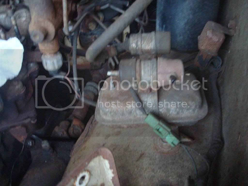

Couple more questions about the desmog....
I'm assuming I cap these? It appears that is the case. Not exactly sure what they are for.
The desmog with the factory carb schematic is different that with the Trollhole carb, so I want to make sure I am not capping something I may need for the charcoal canister to work...the charcoal canister vents to the valve in the back of this photo and there are 2 open ports now on that same valve. Is there a better way to vent the canister?
Thanks

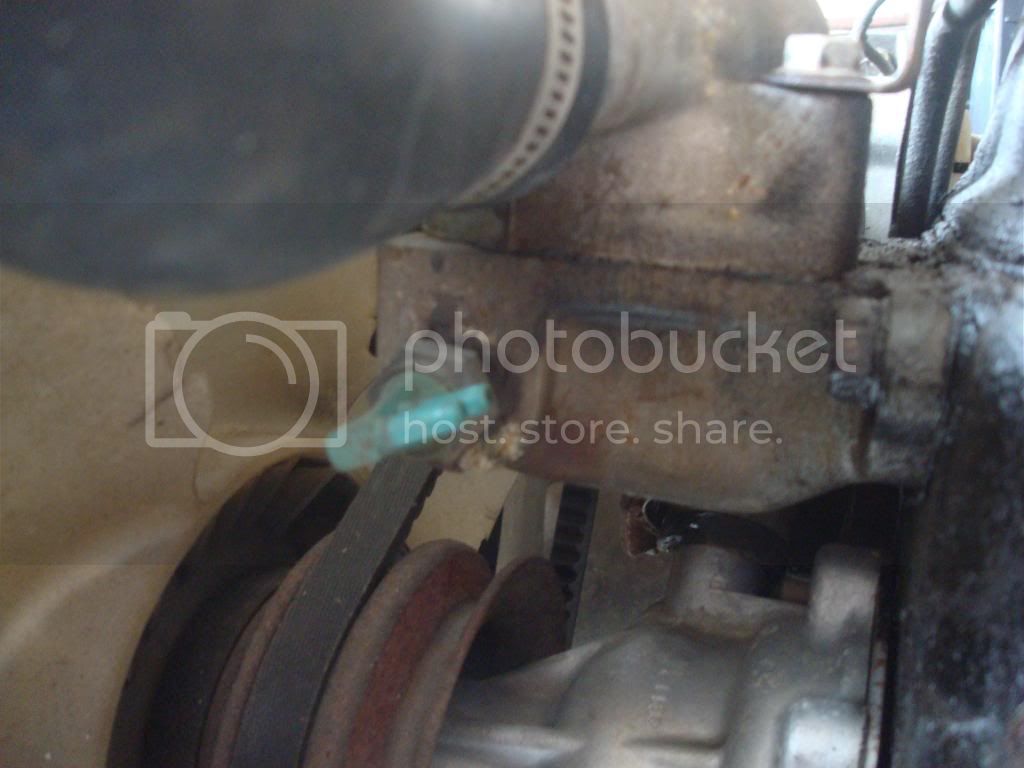

Has anyone gotten rid of the the metal pipe that is inline with the lower radiator hose? The smaller outlet on that pipe has been capped on my engine, so the metal pipe is no longer needed. I need to replace those hoses (engine to pipe and pipe to radiator) but it would be nice to just use one hose.
Thanks
