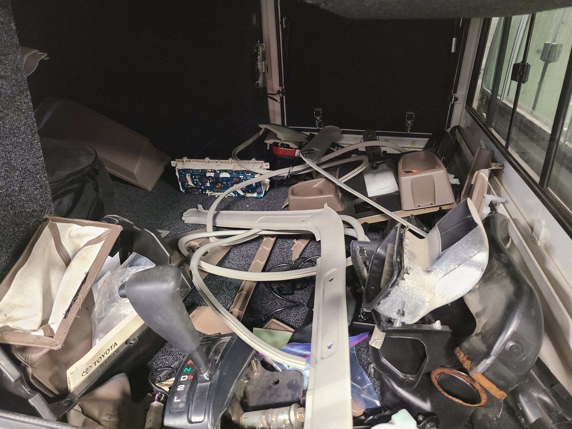

I decided to strip out the interior. Like the entire interior. I had used Lizard Skin in this truck way back in the olden days.....we used both their sound deadener and their ceramic insulation on this truck. Not to knock on Lizard Skin but it's a whole lotta hype. Sure it deadened some panels and probably reduces heat but it sucks compared to the system and products we use from Second Skin Audio. Somebody a while back had mentioned that Lizard Skin was all marketing.....the dual products and the cost. I said no way. Well I think they were right.
In fact, this truck had such a small amount of sound deadening in it, I had put Dynamat over the Lizard Skin. TOTALLY wrong. First you do the butyl product....then you do the spray in sound deadener. Live and learn.
We're going to do things differently and probably incorrectly on this truck because the Lizard Skin isn't coming out. It will be quiet and cool when we're done. Incorrectness and all.

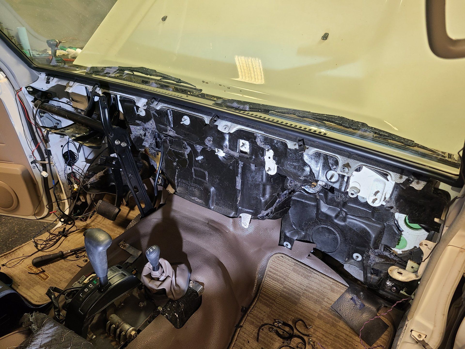

Easy to strip this truck down.....maybe an hour.

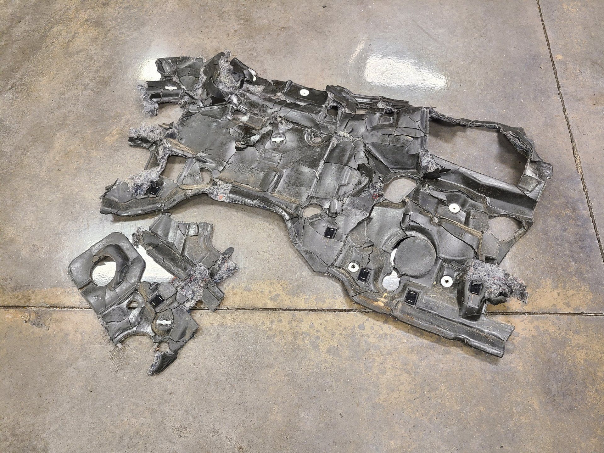

For the record....this piece is my most hated piece on the whole truck. It came out. It went in the trash. Firewall insulation. Crumbling. Annoying.
Way better with it gone.

Way different with EVERYTHING gone

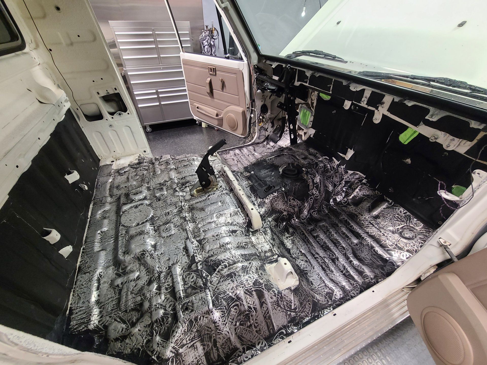

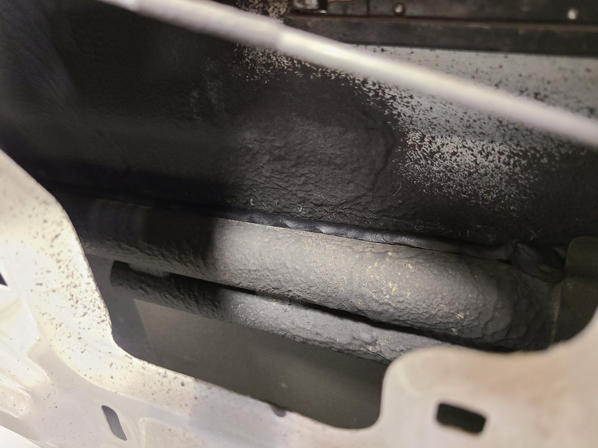

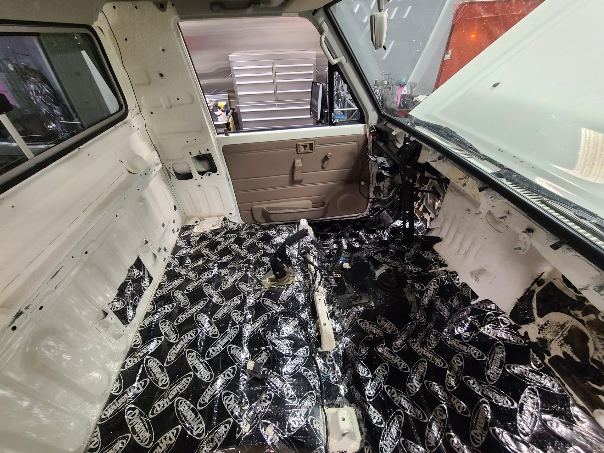

A few big issues....number one....the rear wall of the cab was never done with any sound deadener. I was adamant about having paint back there for some reason. I really tried to make this truck as OEM as possible. The bare skin wall along with the rear wall of the bed create a reverberation chamber between them. Horrible for sound, noise, harmonics. We did a lot of work in this area on the #2 build and we will do it on this one. Both in the truck and on the outside the cab. Maybe even do the back outer wall of the bed(only using the roll on/spray on deadener for these sections)
So we cleaned, scuffed and installed our Second Skin Damplifier Pro.....this is the thicker of the Damplifer products. 2mm.....on the back wall. It will be top-coated with Spectrum then covered with trunk/subwoofer material. Just like the #2 truck.
We also did the firewall. It had some bootleg Stinger butyl on it that was hardly fully adhered. Peeled off as if were clay stuck to the Lizard Skin. Again, the butyl sound deadener over the spray in stuff is not the right way to do it. I've been testing the adhesion of the Damplifier on the Lizard Skin and it has been excellent. It will not come off.
Our intern had the not-so-fun-but-better-than-working-on-a-sticky-wiring-harness job of scuffing the sound deadner in the truck. We'll be coating it all with Spectrum. A all-in-one ceramic and sound deadener. Brush, roll, spray, slap it on with your hand...

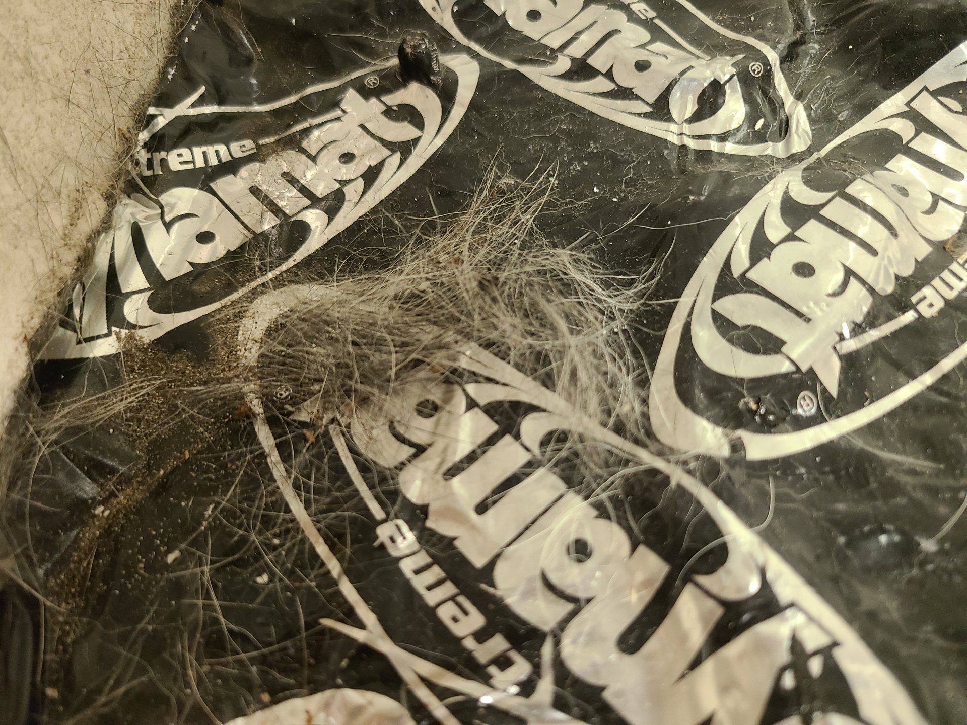

Dog hair. Everywhere.

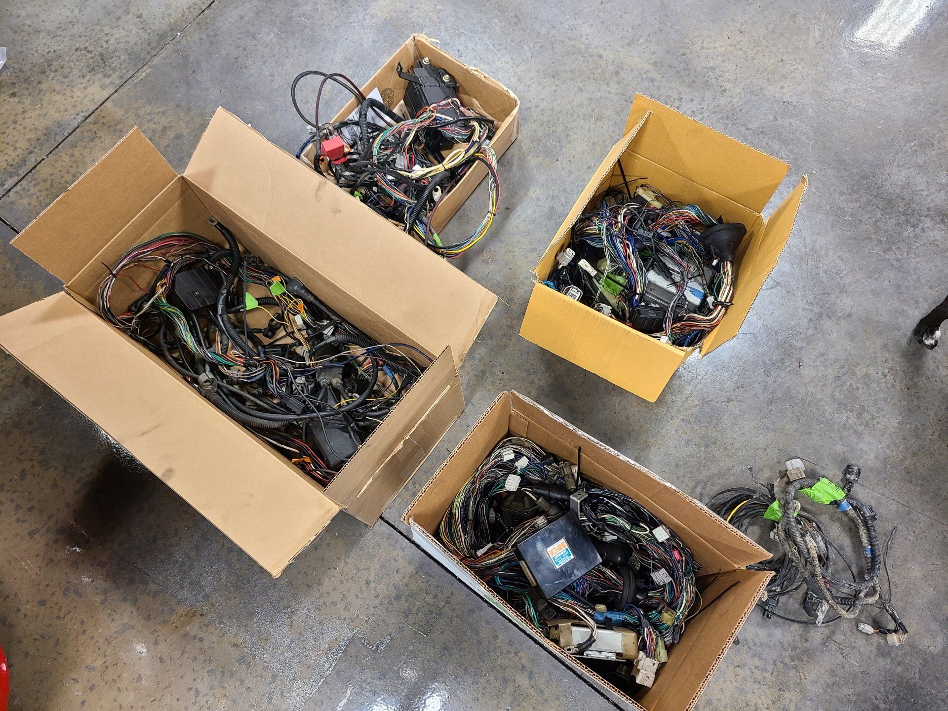

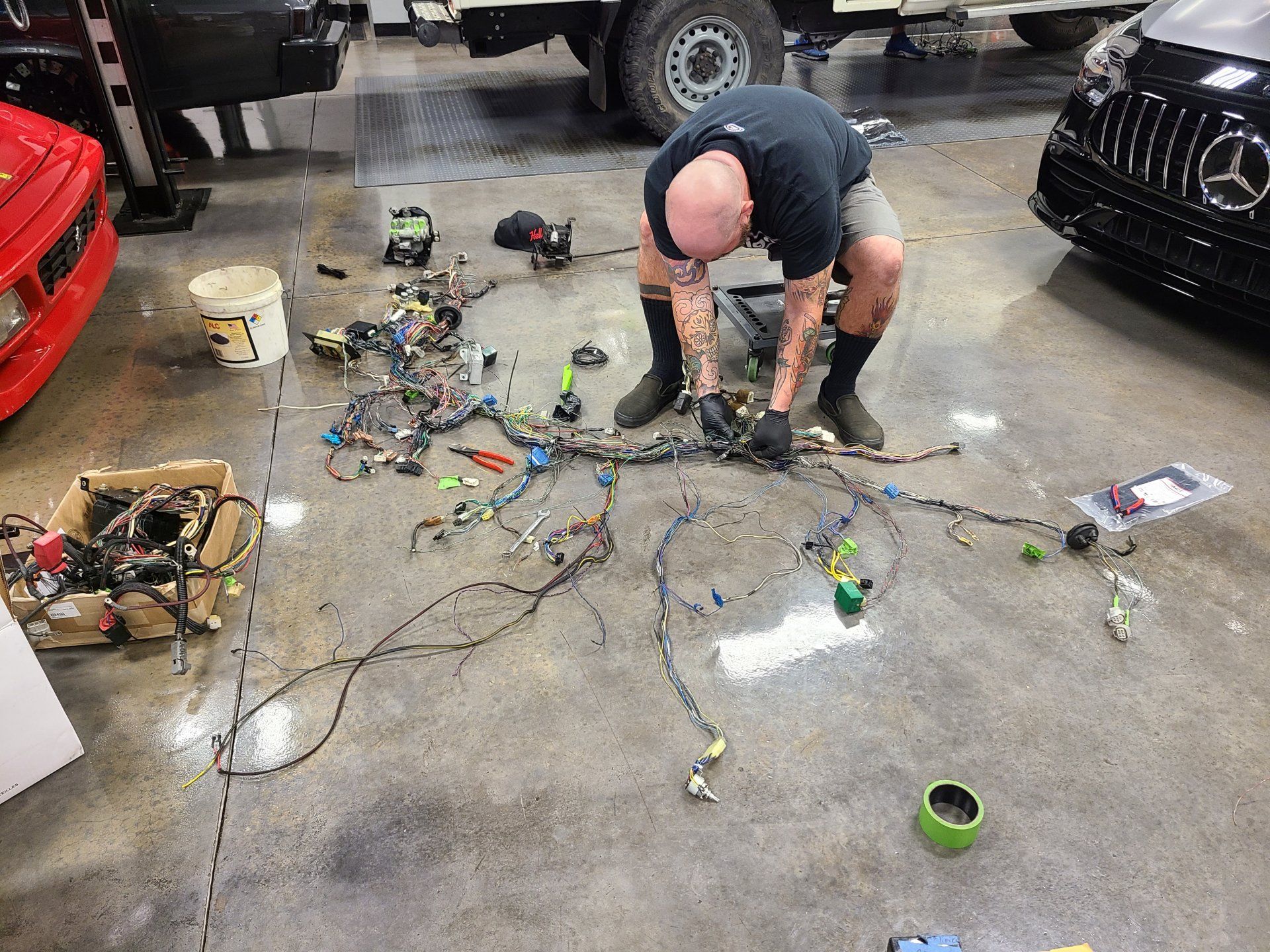

My lead tech got back today from vacation.....welcome to this fun. We boxed it all up so it looked nice.
Taylor is one of the better techs I've ever worked with or who has worked for me. Probably the best actually. Watching him work on this stuff is mesmerizing. He was stripping stuff out that we don't need and trying to figure out what the last guy did. Lots of laughs and "what the hell"s. A little tricky because the HDJ81 was RHD....so we have to adjust a few things. Some stuff like the cruise control from the FZJ80 will work with very little modifying. We took a look at the cables today and I think the FZJ80 throttle cable will work for this motor.
Between the 3FE harnesses we do, the one for the #2 truck we just did and this one....he can look at the harness and know what it is. He has built 100s of harnesses for 240SXs over the years.....the guy was a pioneer with those cars and motor swaps. He's a wizard.

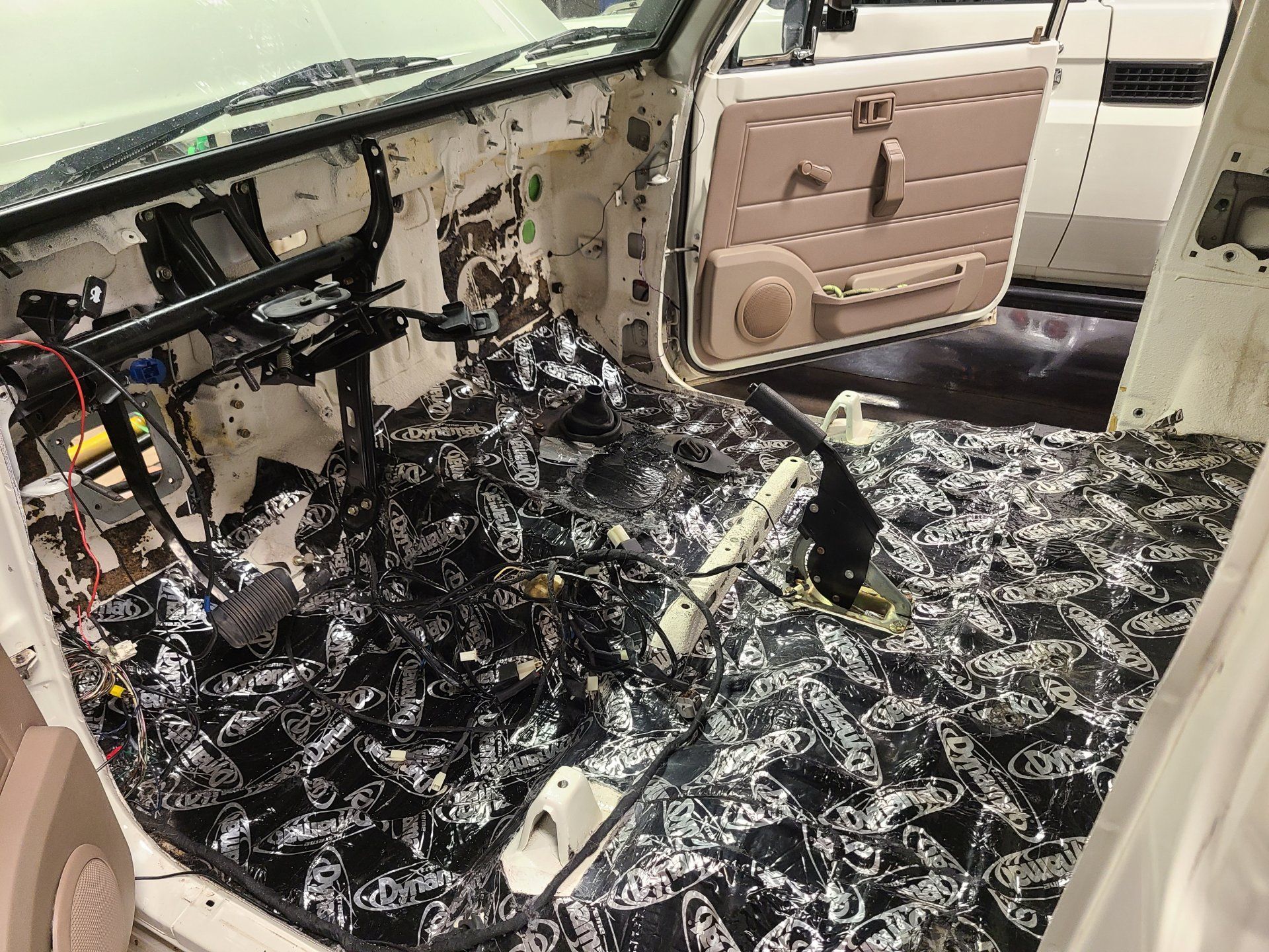

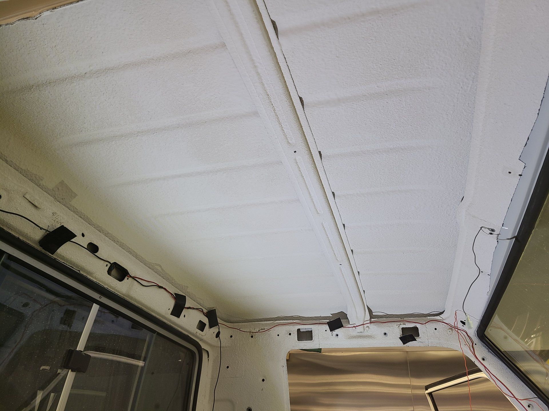

We stripped the headliner and overhead console today. Again.....Lizard Skin just not cutting it. We will install Damplifier, maybe put a coat or 2 of Spectrum over it then use a jute material with aluminized foil on both sides. We use spray adhesive to hold that up. There is zero heat that gets into my #2 truck thru the roof. Amazing. All the wires will get secured differently. We added that for the overhead console lights. Ugly.

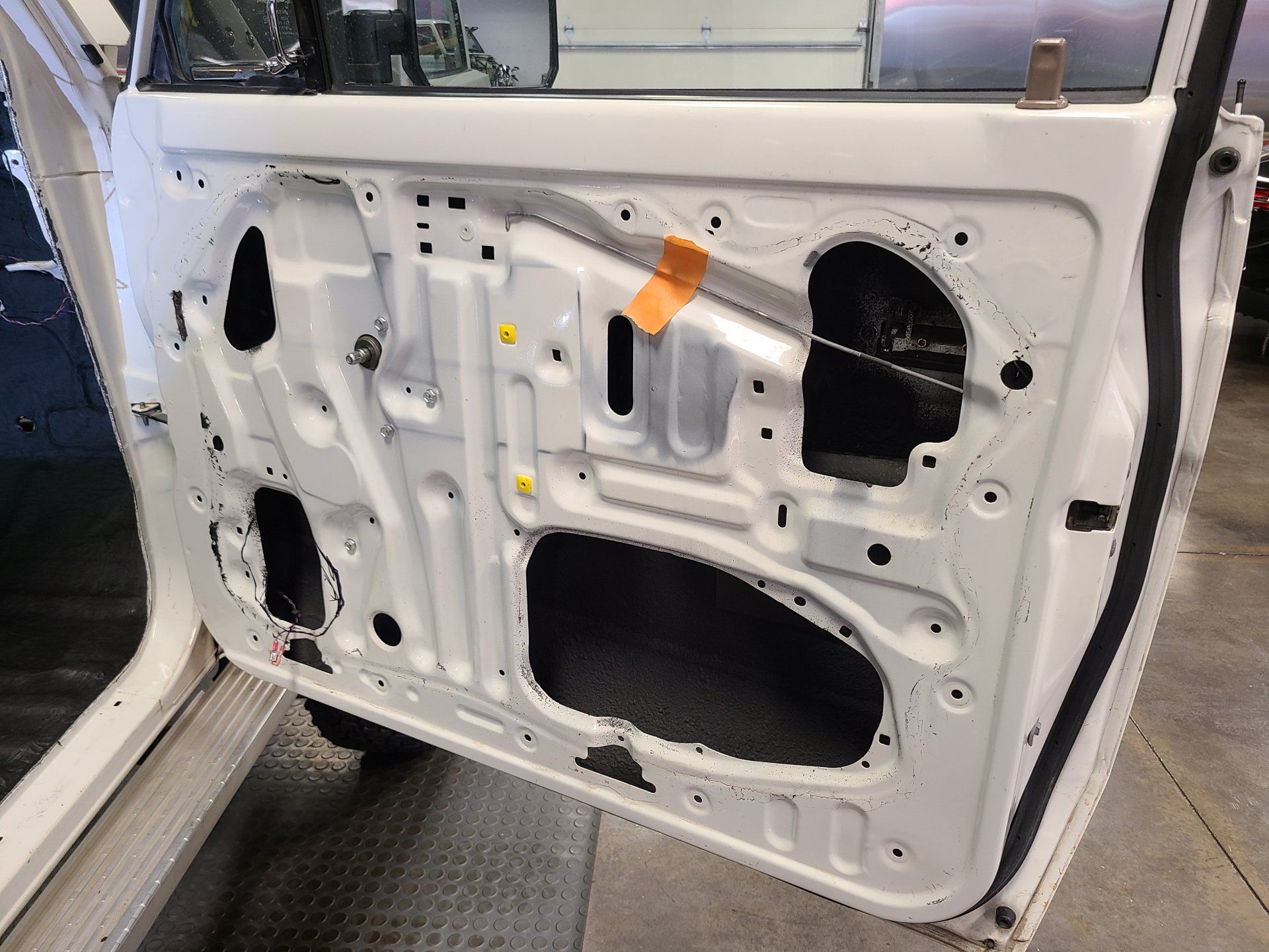

Doors stripped down....we had only sprayed them with Lizard Skin. We'll add some more deadener and I am going to try some foam on top of it this time. I have some stick on dynaliner that I need to use and this will be a good application. Foam is good for behind the speakers that are in the doors. We also cut out sheet metal fillers for that big opening in the door. Did this on #2 and it was great. Helps keep out a lot of road noise. Probably good for the speakers too.
Really cool trick if you do your doors, pack some butyl adhesive in between the door skin and the side impact bars. You can use the sound deadener or butyl strip.

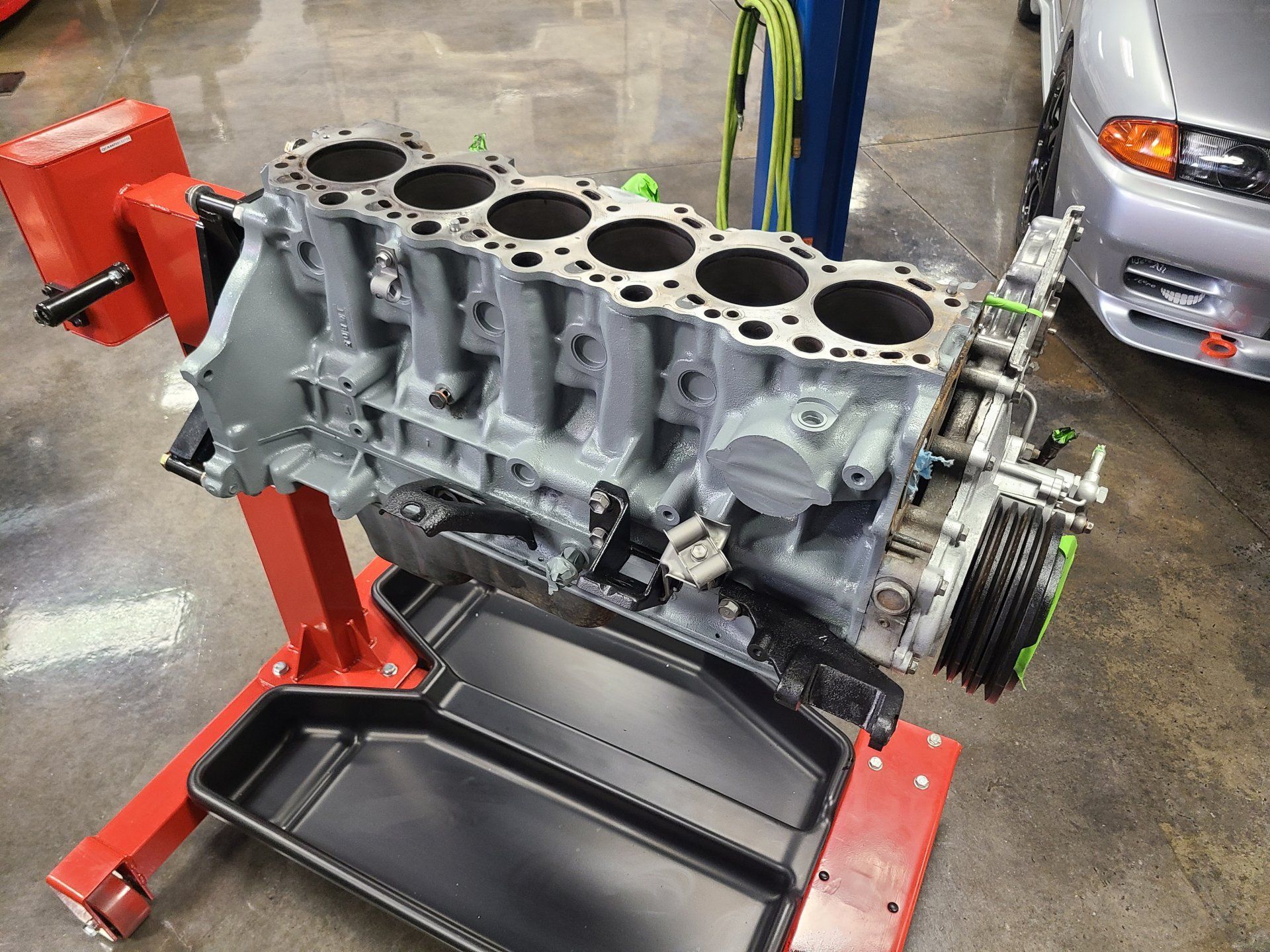

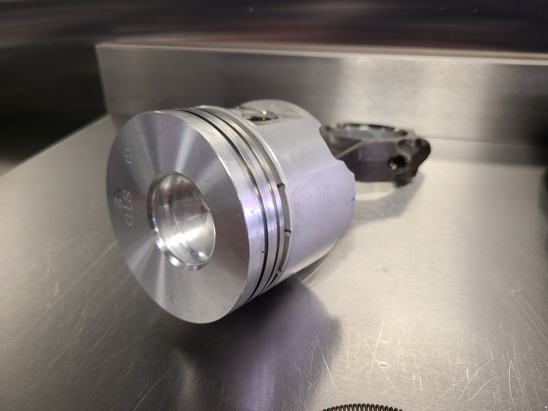

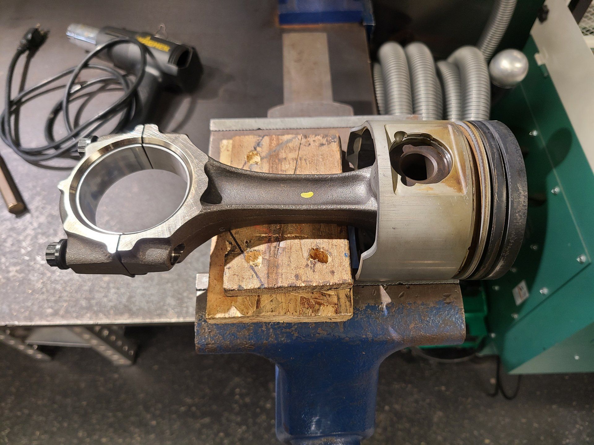

Spent some time yesterday on the bottom end of the motor. Replaced the piston, installed the new bearings.....

This is good tech... as I've been gathering parts for the eventual strip down of my truck's front console area the firewall insulation has been a quandary. Do I spend the coin on an OEM firewall insulation piece? I did for under the hood. But the existing OEM firewall insulation is clearly just a repository for fesh-fesh. Seeing the state of yours after only a couple years settles it. I'll go Damplifier Pro and Spectrum just like the back of the truck... and like you're doing now.

Once the new bearings were in, we measured the piston protrusion per the manual.....front of piston, rear of piston.....average of those numbers. Did that 6 times then figured out which gasket we needed. We needed a 3 per the manual. Ordered from Partsouq....should be on the way today.
Bearings weren't horrible.....nice to know new ones are in the motor. Along with rod bolts. We went with Taiho bearings and OEM bolts.

That firewall liner was SO fragile...even when it was new. My #2 truck had one but it was really nice. Didn't crumble at all. We used it but we Damplified and then Spectrum'd under it.
