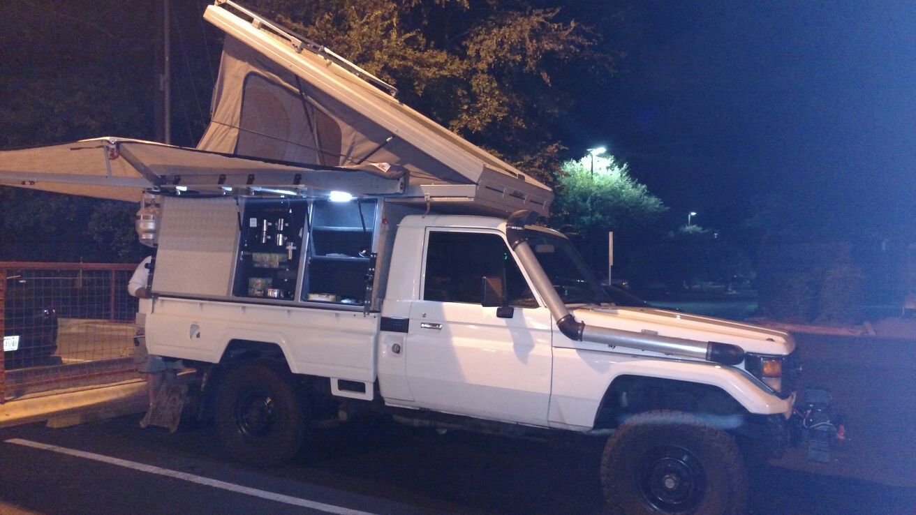

I've been reading all the Troopy builds and I really would like to go that route next....was thinking about having Big Country maybe come up with some kind of cool canopy that I could access from the inside of the truck...which would require a really custom rear door.
I met a guy at Expo that had the coolest tray/canopy/tent modular setup....really really cool. They were working on an 80 series with the back cut off and the tray/canopy/tent added. Sounded cool and based on their offerings, it's going to be really nice.
Maybe the rear roof will come off my 80.....the next next next build.

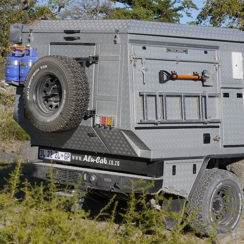

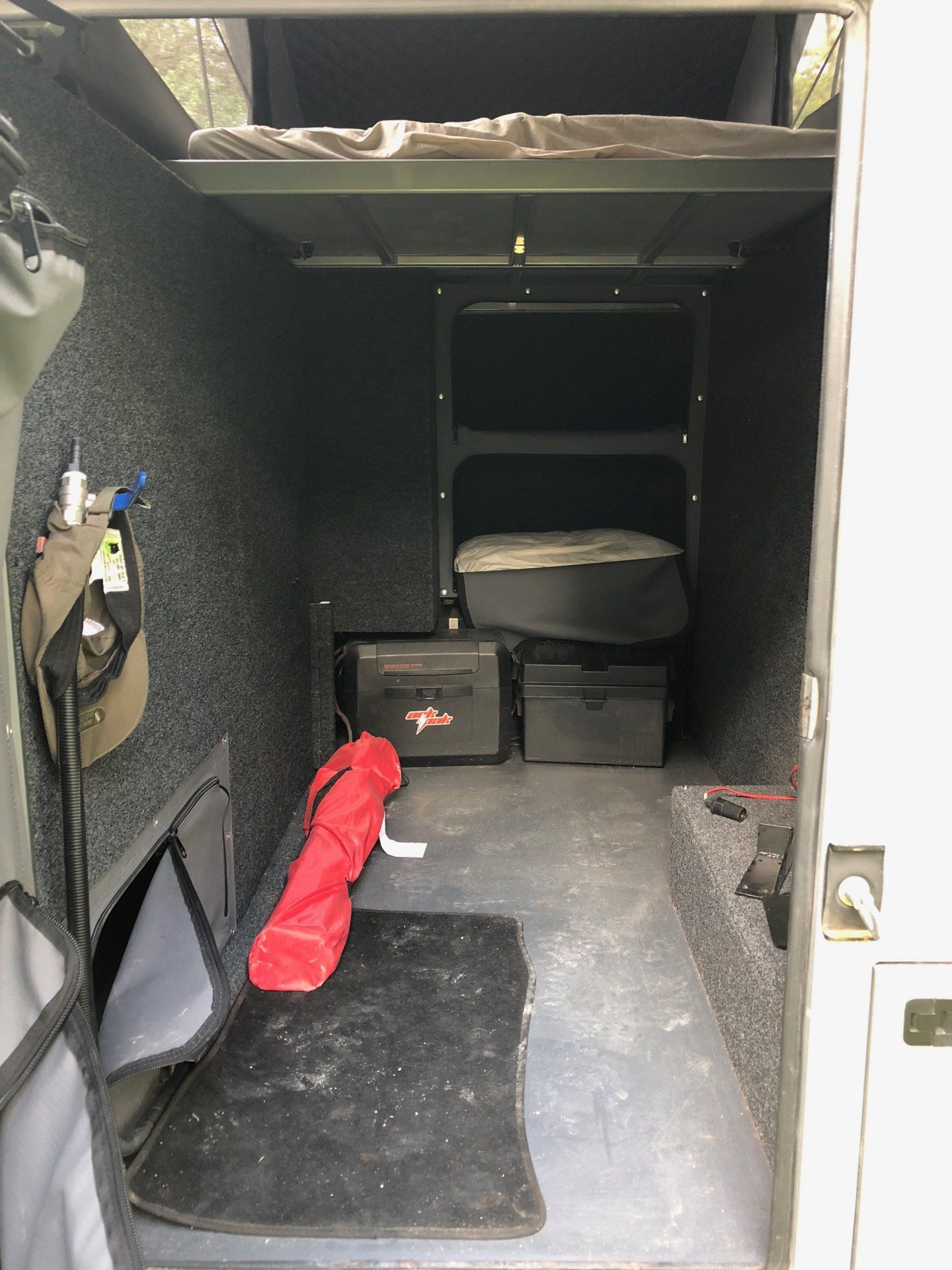

Did you see this guys setup? He’s on here. The floor of the tent rises up like in the troopy
I have seen it! WAY COOL.....Alu-Cab slide in. Totally bitchin' and his truck is SUPER cool...one hell of a build. I was waiting to see pics of the inside.
So the tent's floor raises up so you have room to stand inside. I guess with the tent OVER the cab a foot and a half or so, you gain the room that you lose in the back there where the tent's platform doesn't come all the way to the back of the canopy. Neat.

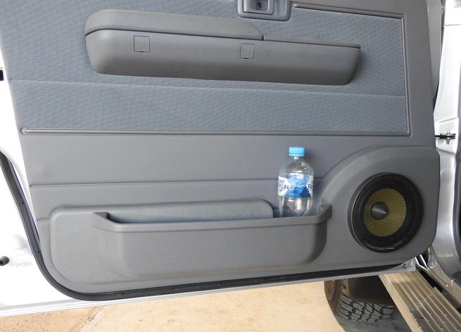

Just in case anyone didn't see my other post, I'm bringing in an overhead console for this truck and some speaker panels for the doors...if anyone wants a set, we can split up the shipping. I think 5 sets of door panels can go in one box. The pockets are not included but those are easy to get. Overhead console is a 79 series thing only. PM me for details if interested.

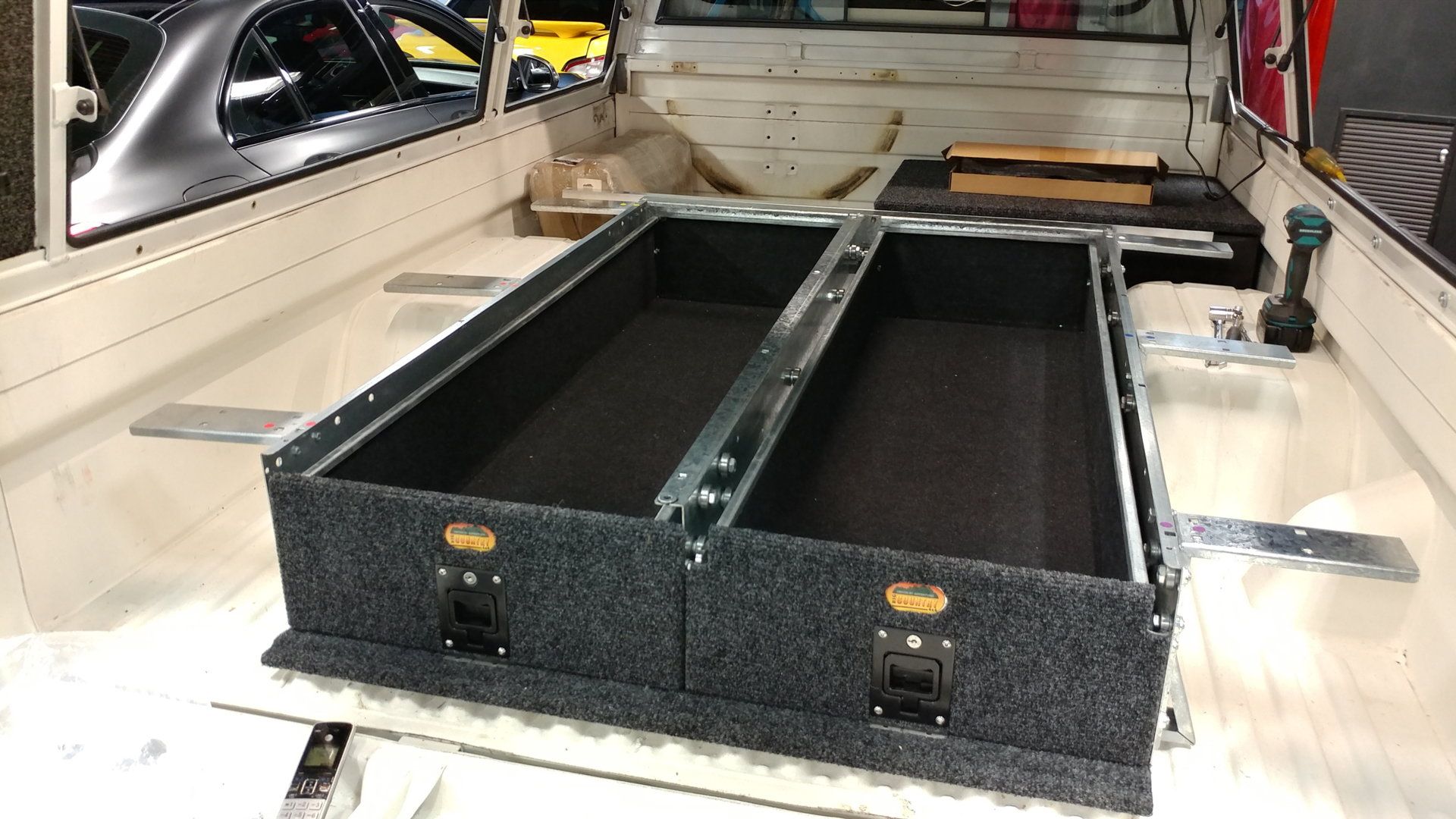

After the canopy was on an secured, it was time to build the drawer system. Pretty standard deal for drawers. We were watching a 4WD Action video at lunch the other day and saw these exact drawers advertised by a sponsor on the program...different name. Not sure where exactly they came from but I got them thru Big Country 4x4.
Parts were all color coded and labeled so you know where they go.
