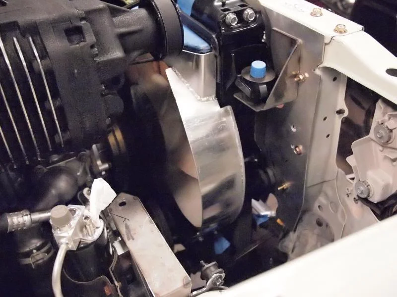

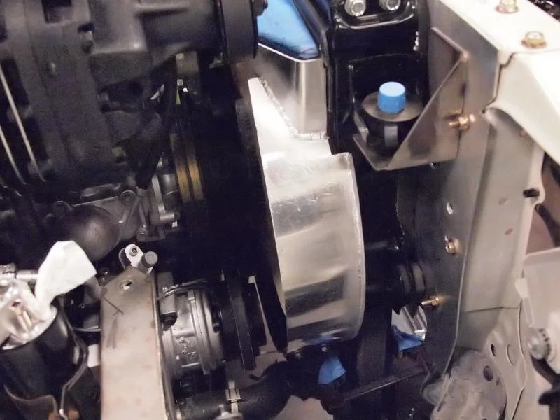

We finished a couple of important pieces this week....had to make half(actually kind of a quarter) of a fan shroud as the way everything lines up on this truck necessitated the cutting of the right part of the shroud to clear the fan. I'll have this piece powdercoated flat black and it should blend right in. Kind of a neat piece.

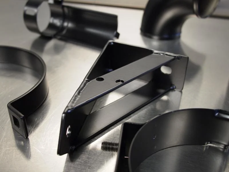

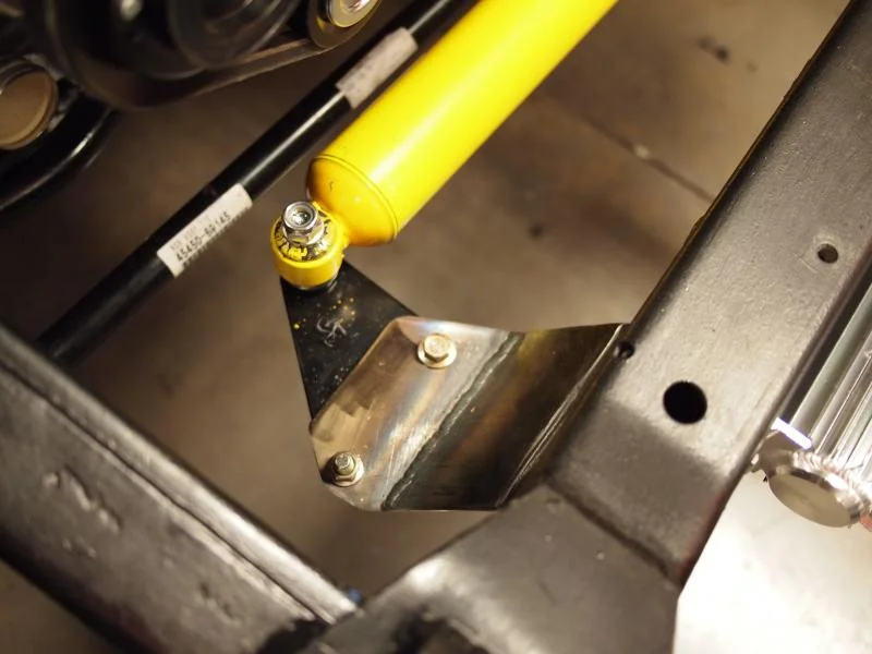

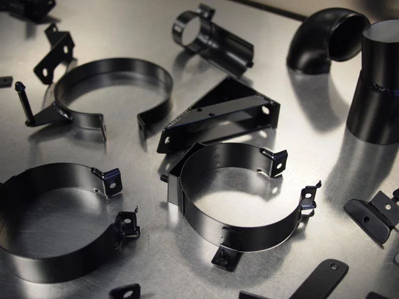

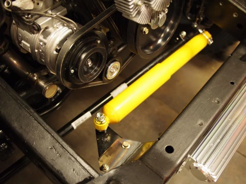

Because we had to move the front crossmember forward(to allow the radiator to drop in the frame), we had to fab up a bracket for the steering stabilizer. Part OEM bracket, part our bracket. We'll build an extension to the passenger side frame rail now that the rad is out. We finished up all the brackets for the trans cooler, condenser and things that mount to the rad support....off to powdercoat for those on Monday. Would like to button up the front end for the last time once we have all of our pieces back.

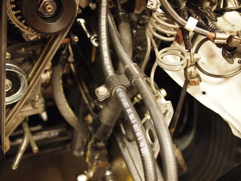

The boss(me) made this cool bracket for the power steering lines....used the clamp off the old power steering cooler tubes. Trying to keep it all Toyota. The only way to go.

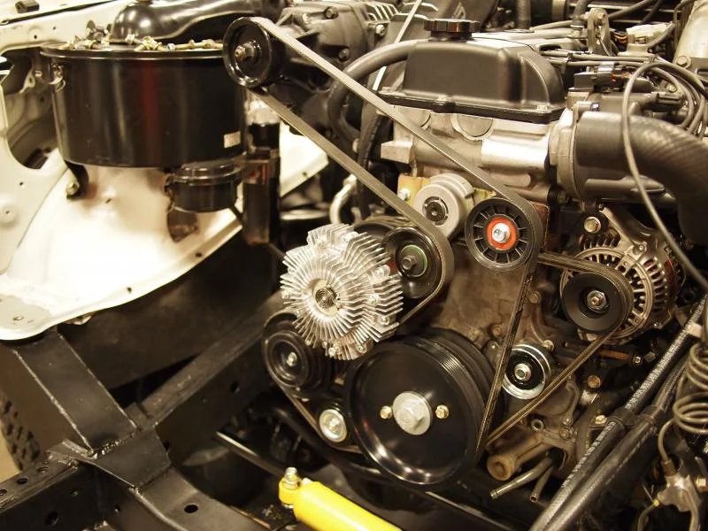

Cool shot of the motors face....probably the last time we'll see it. Once this puppy is buttoned up, I plan on driving it a LOT.

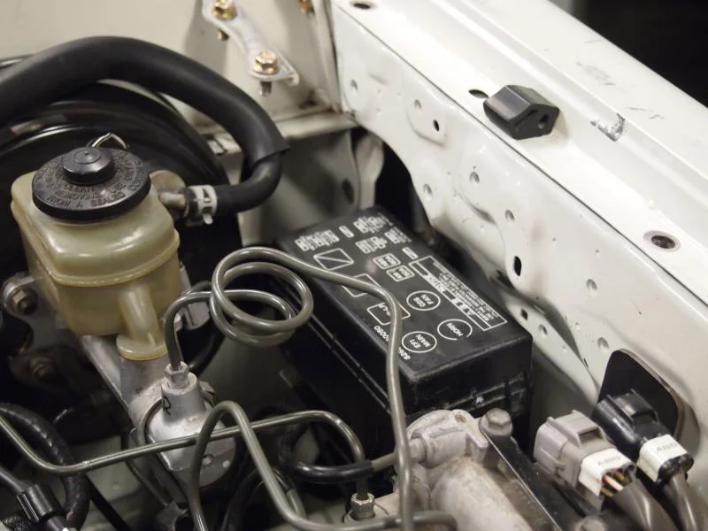

New location for the engine compartment fuse box.....will probably necessitate us having to extend wires. Not a big deal. I think it fits more towards the rad support on the 80 series. Made a bracket to hold it in...just like OEM.

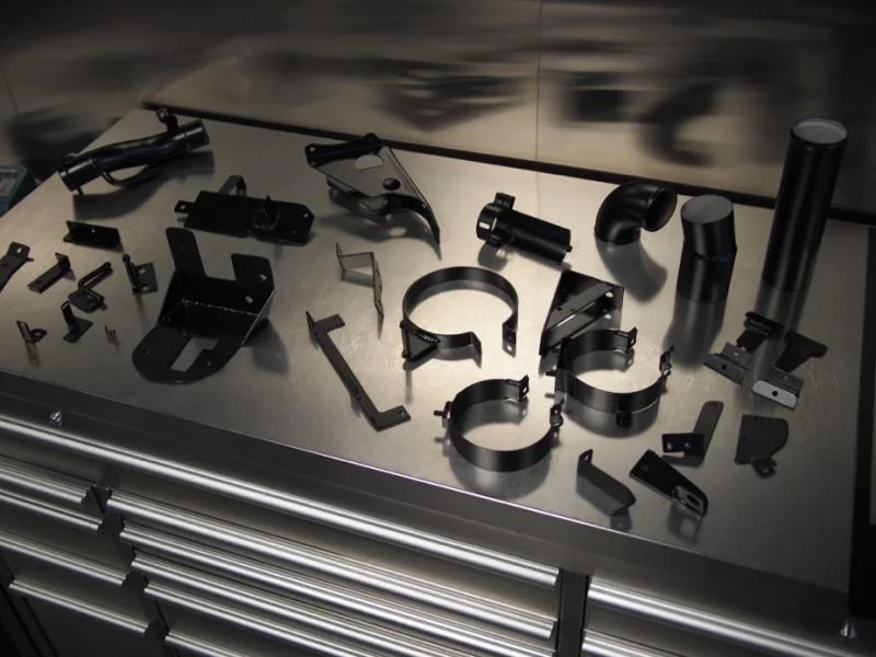

Lots of progress this week...lots of freshly powdercoated parts which is always fun. I decided to paint the inner fenders of the truck, they were kind of beat up from all the fitting/building/etc. Most of the scratches would be covered or hidden but I'd know they were there, I'd rather have them nice and fresh. So those are off at paint....back on Monday. We'll put the front end together for the last time at that point as everything is fit/painted/coated. We'll run some wiring and things will be good up front.

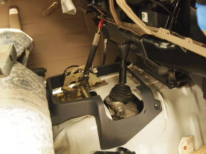

Worked on the shift levers today.....they have always been one of my primary concerns BUT I have an ace up the sleeve....my lead tech. He can do just about anything.....an incredible wrench. From day one I wanted this build to be legit....to look and drive as a proper Land Cruiser should....nothing worse than looking inside of a custom build and seeing things that just aren't right. Without any reference pics for a 79 series factory auto, we're going to have to do things are own way while trying to achieve a factory look. Looks like we have things pretty good so far. We did the 4WD selector first....made an aluminum plate to shift it up, forward and to the right. That was pretty easy. The gear selector won't be as easy....lot of things going on with it. It's also quite high and not really ideal but we'll get it. That will be next week's goal. Then it's wiring. Then it's driving.

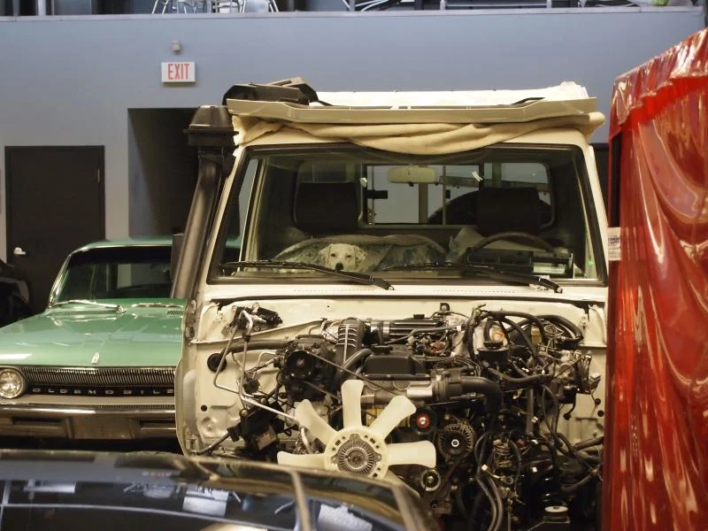

The dog approves of the truck....perfect window height. Even better than our daily driver 45 pickup.

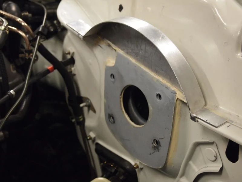

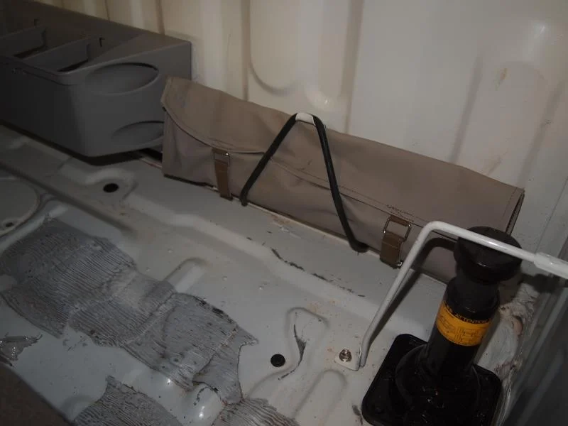

Had the inner fenders quickly sprayed....they were beat up from the fabrication portion of the build and probably from the miles this body has covered in shipping. Got the jack and tool area done up. Made a cool little shroud for the 80 series booster as it looked a little screwy the way I cut it out a long time ago. Didn't really have a good way to blend in my cuts either so we ended doing this. It will get powdercoated....should look pretty good. I probably should have just got the proper booster but I didn't. When I build a 4 door, I'll do it differently.

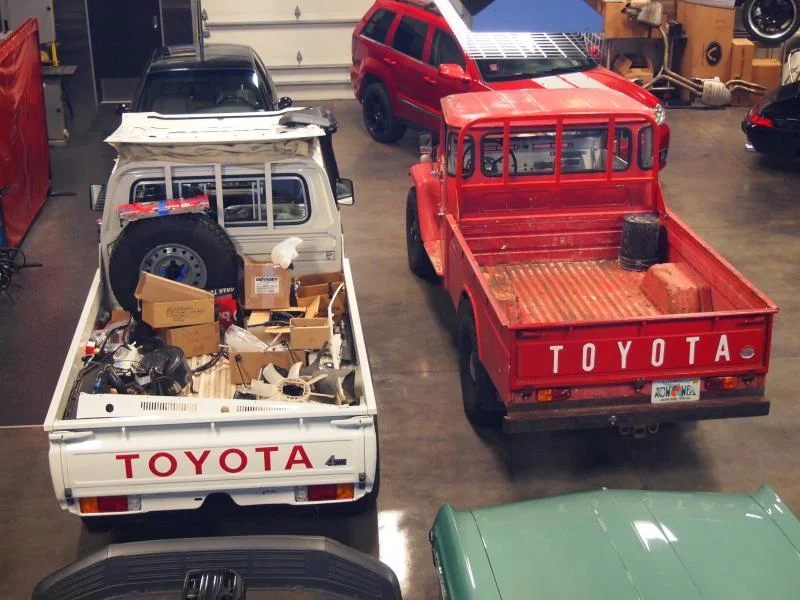

66 FJ. It's my baby.................until the white one is done. Red one gets a light restoration once the white one is running. Motor rebuild(3FE), new body mounts, maybe some bedliner in the cab or something. I'd like to clean up the engine compartment a tad and make the 3FE a little cleaner. We kind of shoved it in there with the intention of coming back to it once it was all built and running. That was 2 years ago....it's been my daily driver since.
