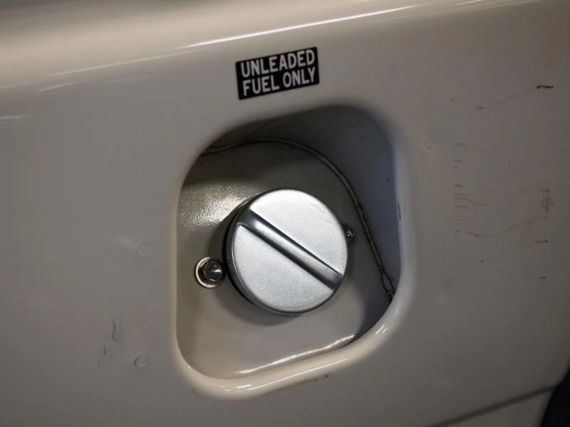

Small accomplishment from last week
What was that cap off of?
Sent from my phone using IH8MUD
It was off eBay actually.....not sure if I have the bag it came in with the part number. I see it listed all the time.
If u find the pn i would be interested. Looks nicer than my retrofit 60 series one.
That looks like a regular FJ40 fuel filler cap.
That said, beautiful build and beautiful chronicling for those of us who would love to have a truck like this as well.

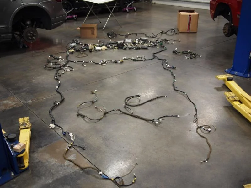

Opened up the one box I wasn't looking forward to opening up....the dreaded wiring harness box. What a mess. It's going to be a big job but I think we'll figure it out. Fuel pump harness was cut on my harness...only $12 from Toyota....a nice surprise. The rest of it looks pretty good. Kept it laid out today so we could get an idea of what's going on. I think the sheer size of what will be kept is going to be the hardest part of the whole deal....not a lot of space behind that dash for the keeper wires.
Going to start by getting the engine ECU mounted....figured out it will be placed on top of the glove box liner. Perfect spot.

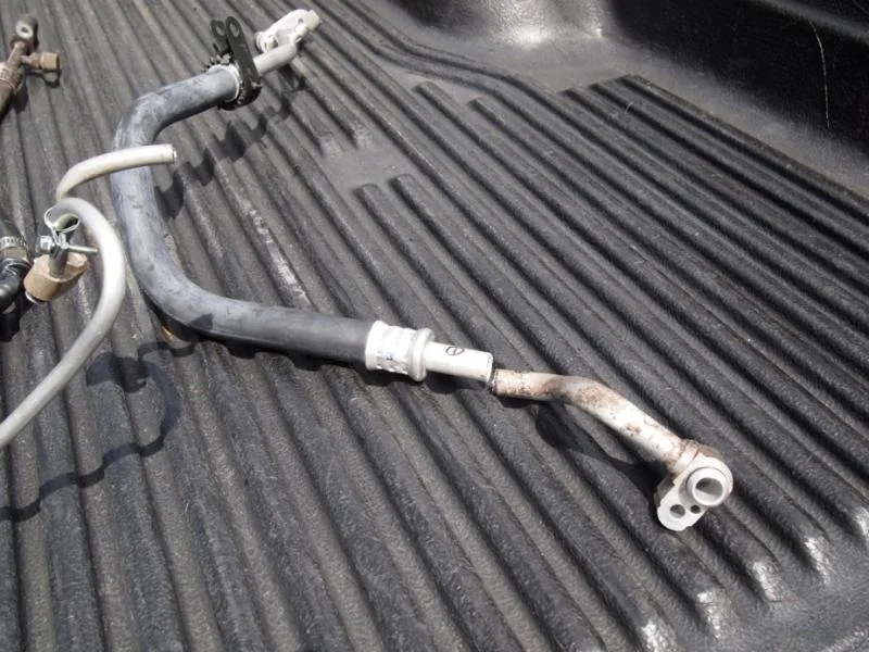

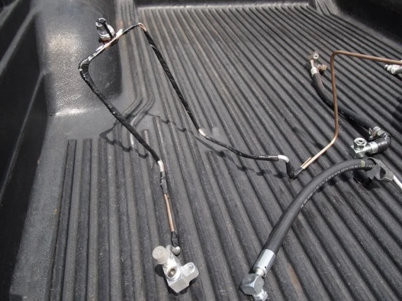

Mock-up AC lines....not the prettiest but they got the job done for us. Hopefully new lines tomorrow....I'm sure they'll look a little better.
Looks like the remains of one of those robots from the original "Transformers" movie. Remember if all else fails you can always use shims and duct tape. :)
I think the young gun in the shop used copper welding filler, electrical tape, copper tubing from the brake/fuel lines and pieces of the OEM aluminum AC lines to put it all together....lol. I'll give him a passing grade for ingenuity but a failing grade for looks. I'll be shocked if they all turn out OK....hopefully we'll see them today.

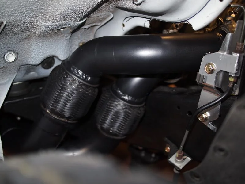

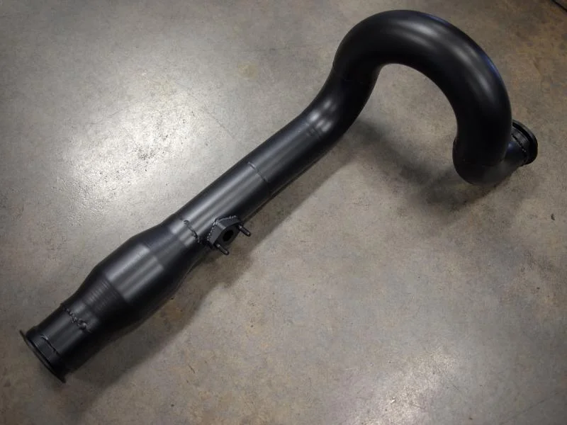

Just got the forward pieces of the exhaust back from thermal coat....downpipes and cat-pipe that will go under the cab. I didn't bother thermal coating the muffler portion of the exhaust as it is fully under the bed.....seemed like a waste. The rear section around the gas tank will be done in the AM....we'll mount it all up today I think and then it's back to pondering the electrical stuff.
Downpipes installed....

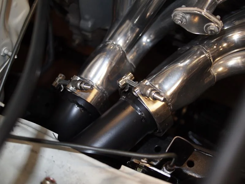

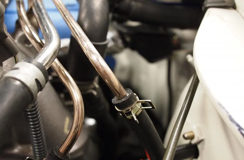

Couldn't help myself from buying nice and pretty new little clamps...ordered a dozen which resulted in an order of kit with about 80 so I can replace everything...I'm out of control. This is the line that runs from my charcoal canister to the tank....we had to relocate the canister to the passenger side....hard lined it over with the purge line and the brake booster line from the relocated throttlebody...3 nice lines running across the back of the motor. Clean, clean, clean and we haven't even cleaned it yet.

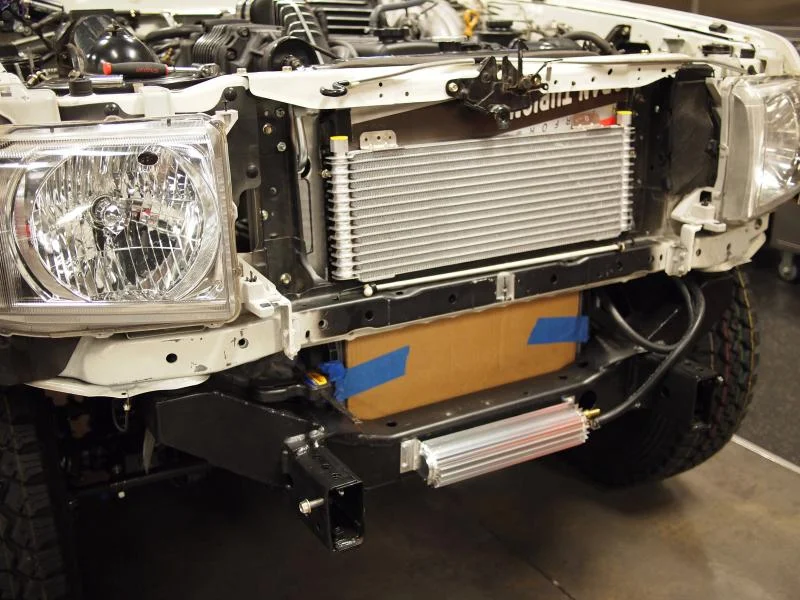

Few pics from this week.....my assorted spring clamp selection, a pretty new custom AC line and the eventual home of the new trans cooler.....found out the truck did not have the brace that supports the hood latch(installed it yesterday) so I ordered one....it's in the US so it should be here early next week. Kind of amazing(to me at least) just how many parts are in the US for this truck...pretty cool to get them thru my local dealer too.
