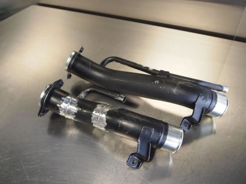

More stuff crossed off the list today....fuel filler for rear tank(only tank on my truck) is done...had to shorten it a little and slightly change the angle of it. Not a big deal. Finished the passenger side mudflap(almost). Had to rotate the flap part and trim it down to make it work right(it has 3 holes for the stock width of the metal mud flap mount...the addition of the mud flap extension adds another hole...I would guess there are specific mudflaps that I did not get with my rear fenders. I don't want long flaps....just about 3" will do. We'll tidy that one up tomorrow...pic shows the uncut flap. Drivers side will more than likely need some clearance work for the exhaust although Toyota was kind enough to put a cutout in it for the exhaust...just so happens that I think it might clear my exhaust. Because of my bed mounts, we're having to do a little inner clearance work on the metal flaps...pretty easy.
I guess the Unleaded Fuel Only/Diesel cap/sticker could cause an issue....a costly one if somebody chooses the wrong fuel. I think I'll find a new cap.

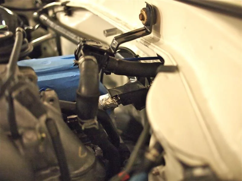

Received some underhood goodies....since I bought a used supercharger, some of the parts were missing and some were just crappy. I found a slick 180 degree silicone hose in 3" that was the perfect size to get me over to my relocated air filter canister. Almost as if it was designed specifically for this application. Decided ot not measure the AFM....it's 3.5"...had to order a 3.5 to 3" adapter. Need to get the supercharger mounted up for good at some point I suppose....we keep adding parts on...things are getting crowded under the hood. When I started this, I thought I'd have underhood room for all kinds of things. Not so.....
Heater valve was installed....modified the factory metal tube that snakes from the block to behind the plenum and up to the valve on the 1FZ. I had a bunch of misc bends and heater hoses from the 80 series system......made a cut or 2 and it fit better than OEM(from what I can tell, OEM doesn't use a whole lot of aluminum tubing...just a little piece...it has a bunch of complex moulded hoses). Mine will be good because its serviceable with 80 series parts and it works. Operation of the temp control on the HVAC panel is as smooth as can be. Cross it off the list.

Originally it did.....Unleaded Fuel Only stickers courtesy of my Toyota dealer.
The fuel cap from my fj62 fit the 79 filler neck. Just sayin. And it doesnt say diesel on it
Sent from my phone using IH8MUD
That's what I need....I think I ordered one a while back but it's 'hiding' somewhere. Not sure where the diesel cap even came from. Might have part of the fuel filler assembly. I've lost track of a couple parts(maybe more) over the past 2.5 years.....lol.

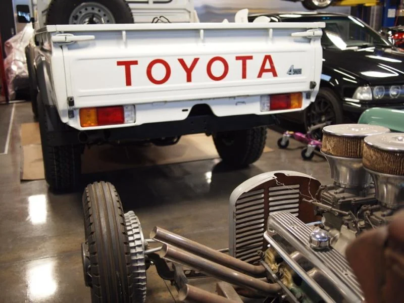

Finished up the rear of the truck....got the fuel filler sorted out. I used the one for the cab and made it fit our rear tank...just needed a little taken out. Lines up perfectly.
Sorted out my tail lights....my rear tail light panel was really tweaked. A fork lift must have gotten it at some point. Fortunately where the major dent is, I'll be able to cover it with my license plate(hopefully....not sure how the rear bumper will fit). In any event, we straightened that out and popped in the lights. So basically, the back of the truck is done.
Drivers side mudflap is done...didn't need any mods for the exhaust. I like them with the shorty flap on them.
