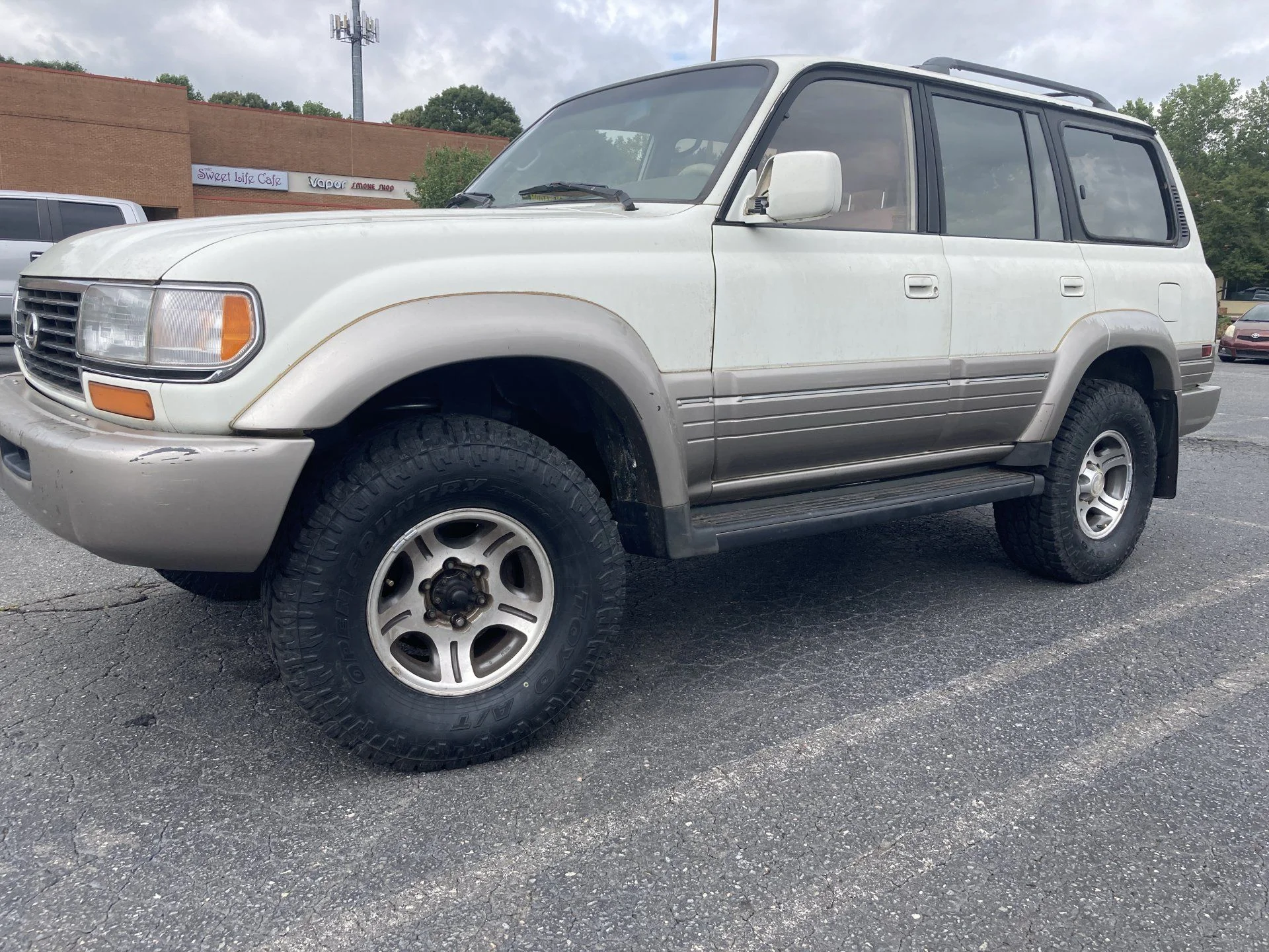

Annual update: The springs on the truck were saggy as could be so I bought @AJR 's 2.5" OME lift because Sarah has the same one on her 1997 LX, so it's a known entity...BUT, I instead ended up installing the HDJ81 springs I got from @slceso a few years back. Turns out I gained at least an equal lift to the OME 2.5". Some corners are actually .25"-.50" taller than her OME. So, since I want the stuffed look with the new Toyo AT2's I might have to revert to the 80 take off springs I acquired from somebody a few years ago and throw in some spacers if needed.
I drove them back to back today and the HDJ81 springs/new OEM Toyota shocks rides just a bit rougher than the OME 851/860 with Rancho RS9000 shocks. Of course, the OME lift is a also carrying a winch hidden in the front bumper. There's also the issue of Toyo's vs Milestar's. Pretty sure the Milestars aren't E-rated. Both trucks are still eminently drivable, I'm just coming from worn ass 303K mile springs.
