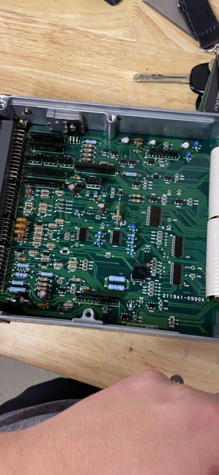

They often look fine. The caps I replaced in my 4wd ECU looked totally fine. They just dry out and quit performing. Not saying yours are definitely bad, just that looking at the ECU can't necessarily rule it out.
is there a testing procedure? The FSM and AllData shows no mention of actual ECU repair
Not that I know of. Easiest would be to swap in a different ECU if you can get one cheap or borrow it.

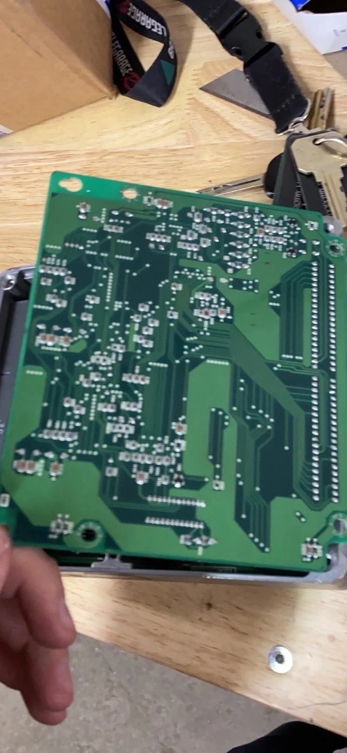

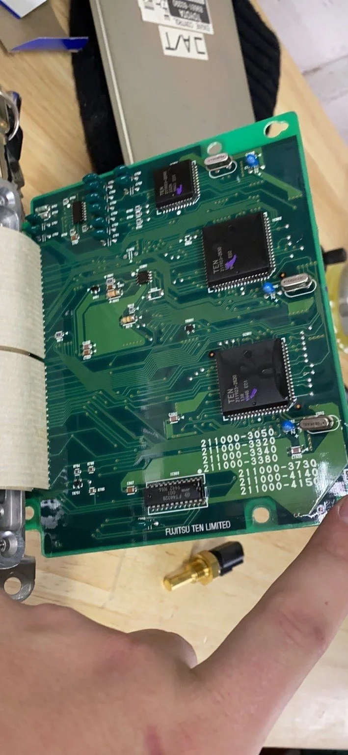

Tore it out again to double check some things and grab some pics. It’s clean as an effing whistle, no corrosion anywhere and bone dry. The conformal coating hasn’t even started to crack yet.
