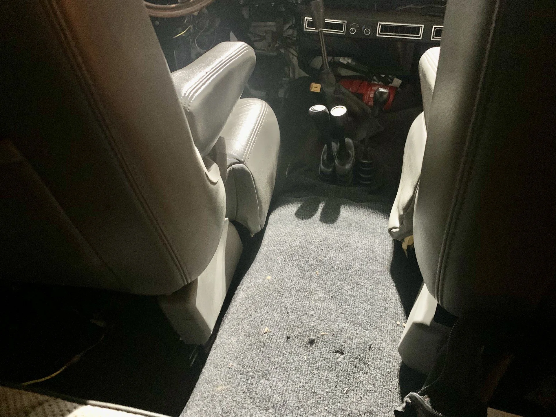

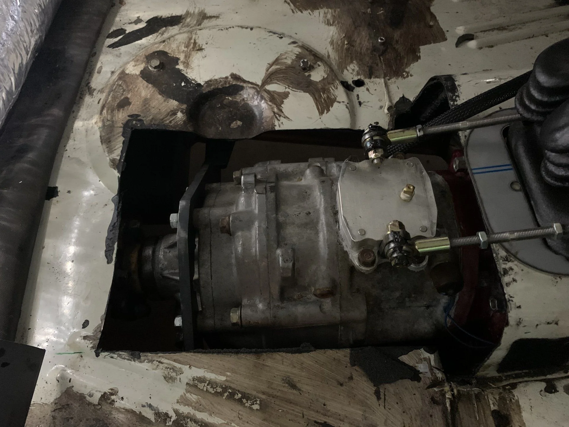

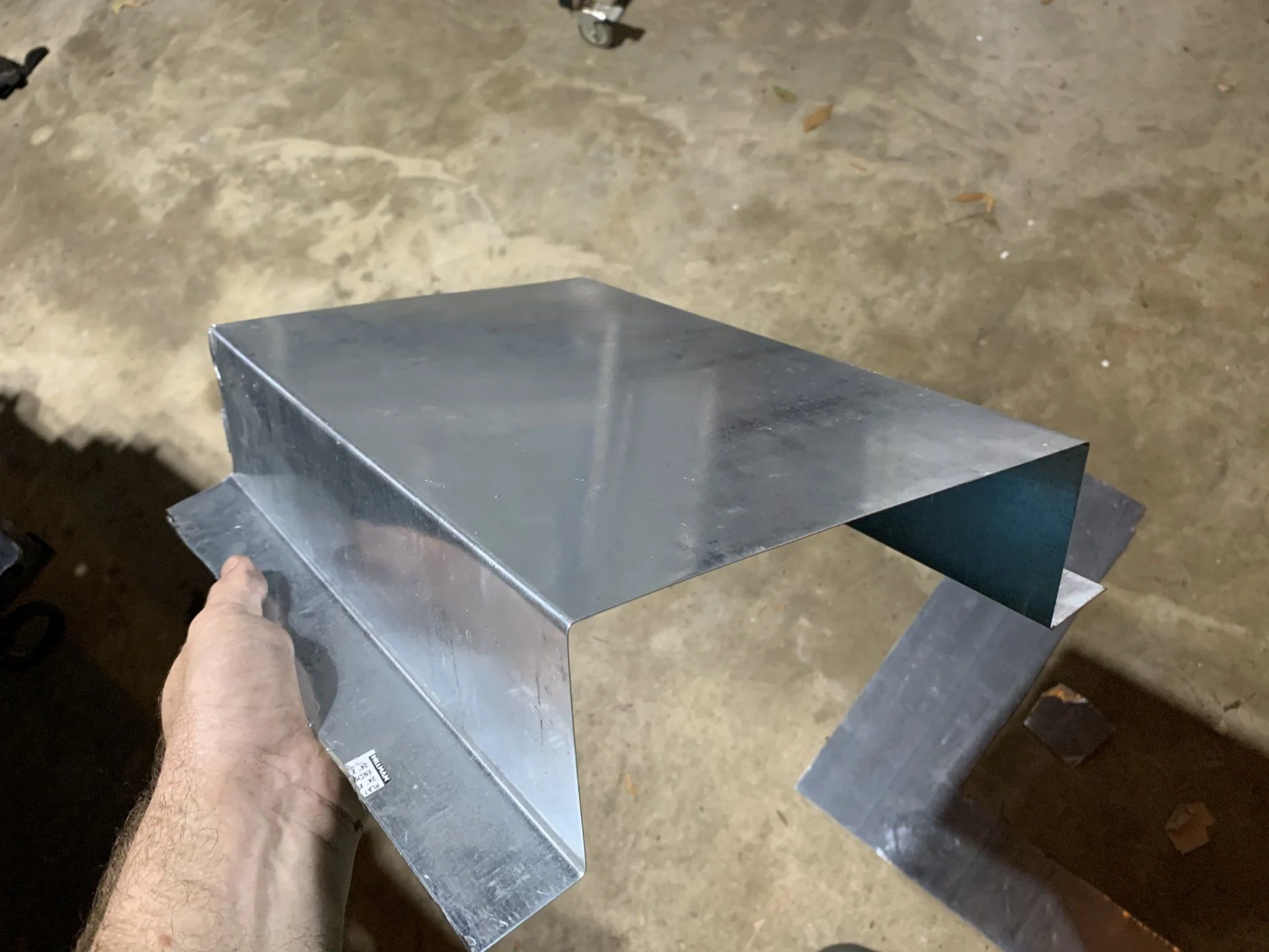

There were two holes for the old shifters and then a huge hole for the longer cases. If there was any question if I am a professional transmission tunnel builder..... I’m not. BUT holes are plugged and there isnt 10,000* air blowing on me at all times. The triple stick part took a min to make it all work. If I get bored, I’ll redo it. Center console should be able to go back in.
the carpet has a layer of sound dampening attached to it from the previous owner. I think I want to get rid of the carpet, but its still in right now.
Buddy let me borrow this little portable brake. Was pretty cool.
