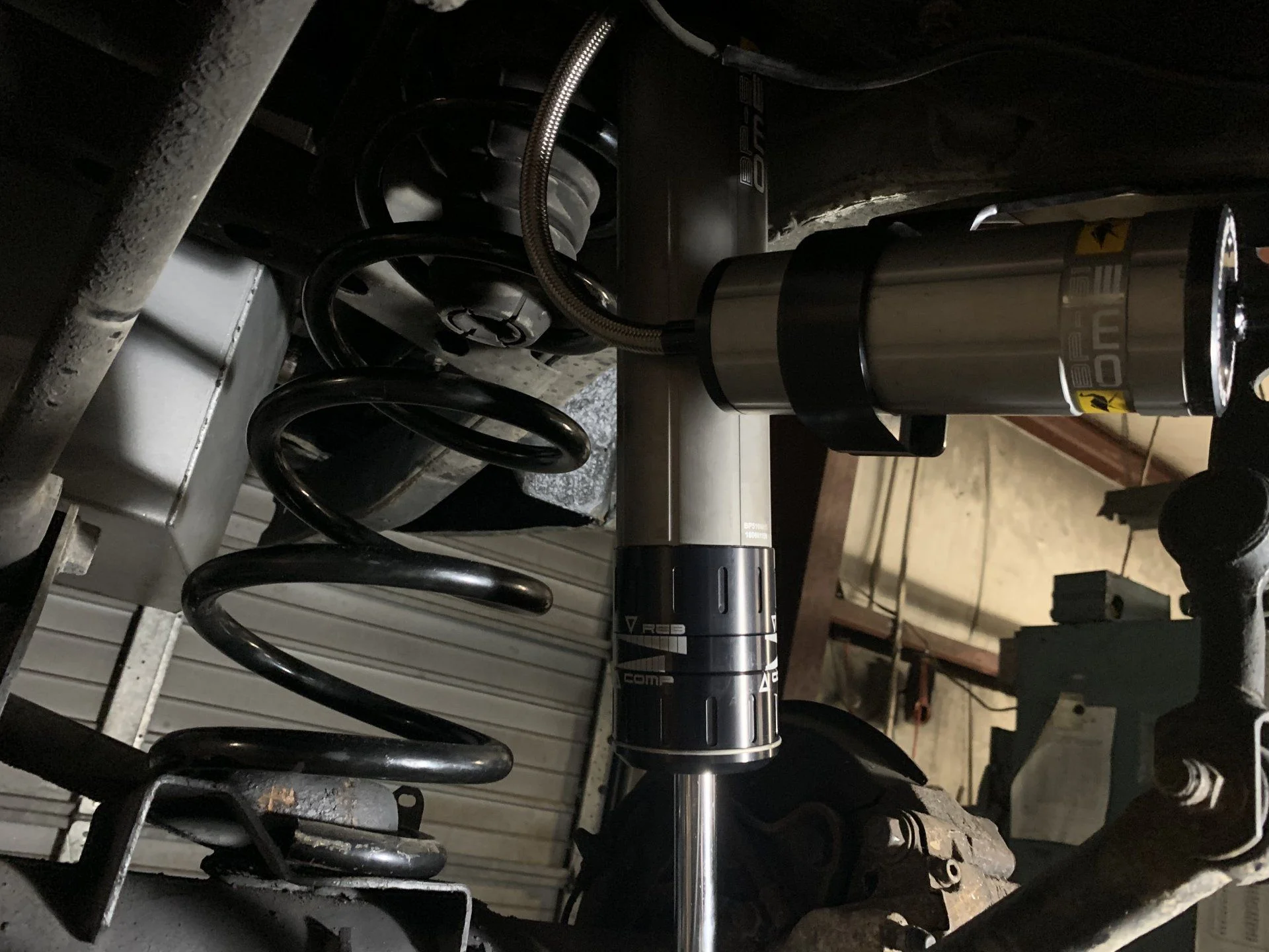

it sits perfect right now... going to add 500lbs to the rear... package just showed up with some rear 0.8” spacers and some 1.2” spacers...
—>what should I put on in hopes that after it squats, it’s right on the first try? I’m thinking 1.2”.
In the big scheme of this build, swapping springs and/or spacers isn’t that bad, but if I guess right, one less thing to do later. I think the spring rate is right, just need to set ride height.

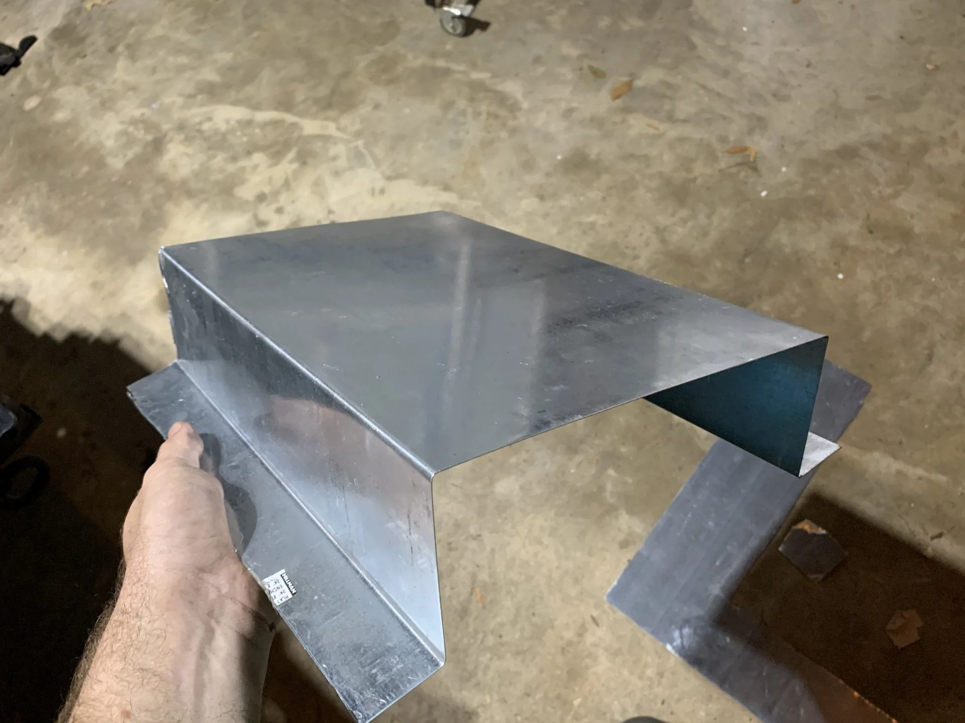

Intake was easier than I thought. Besides looking like a high school kids Civic, it all went on smoothly. I’m going to have to scuff it up and paint it black though.

I will need some sort of proper air box. This will work for today. Wouldn’t work at all without the MAF hooked up.

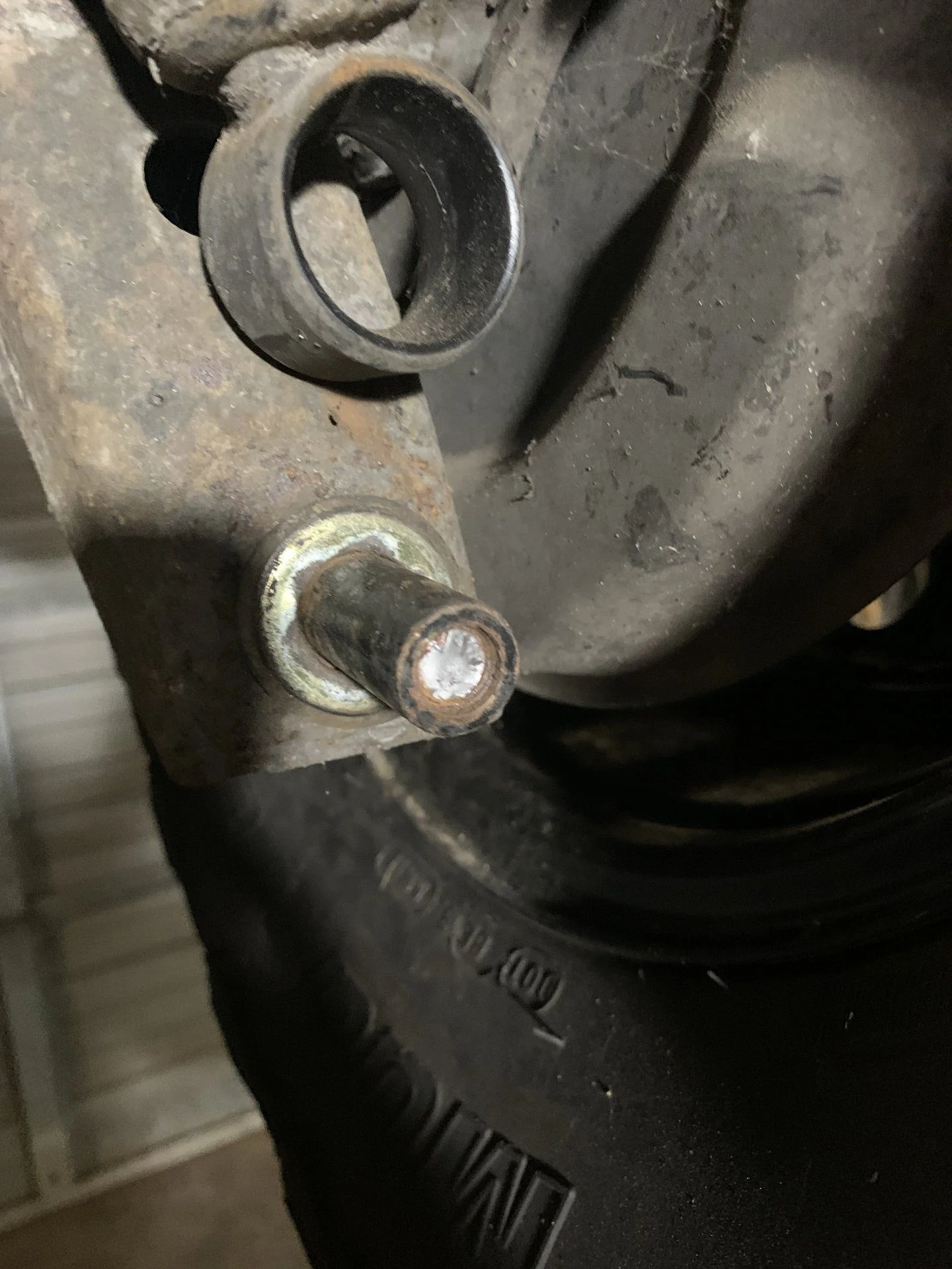

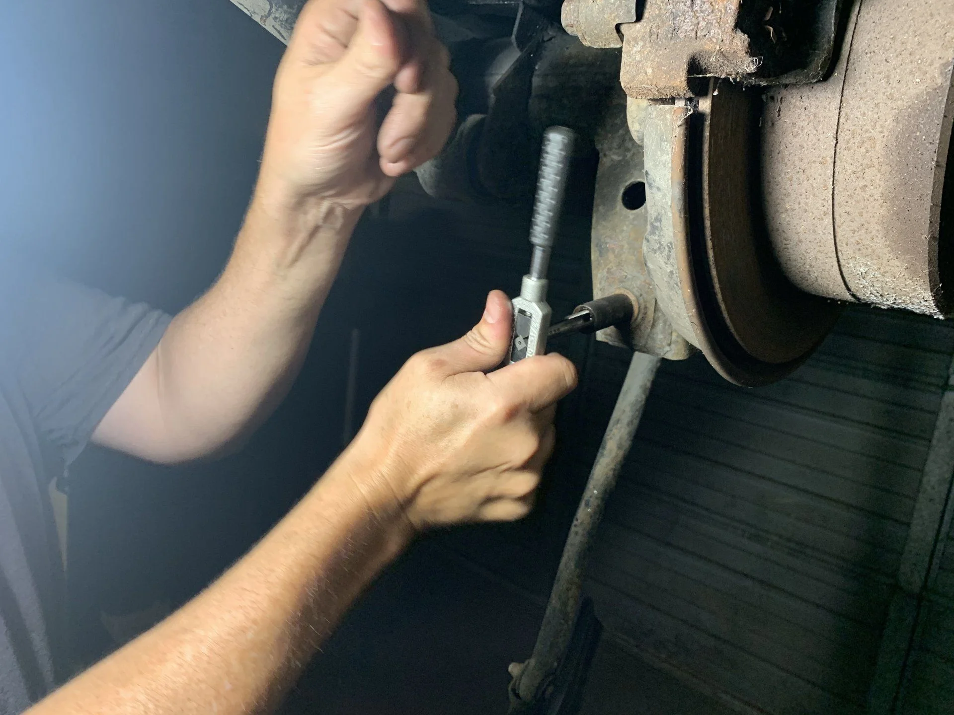

If I hadn’t broken off this lower shock bolt like an idiot, I would have had 45 more minutes to do something else. Oh well. The jackass that designed the whole 80 rear shock setup is on my s***list

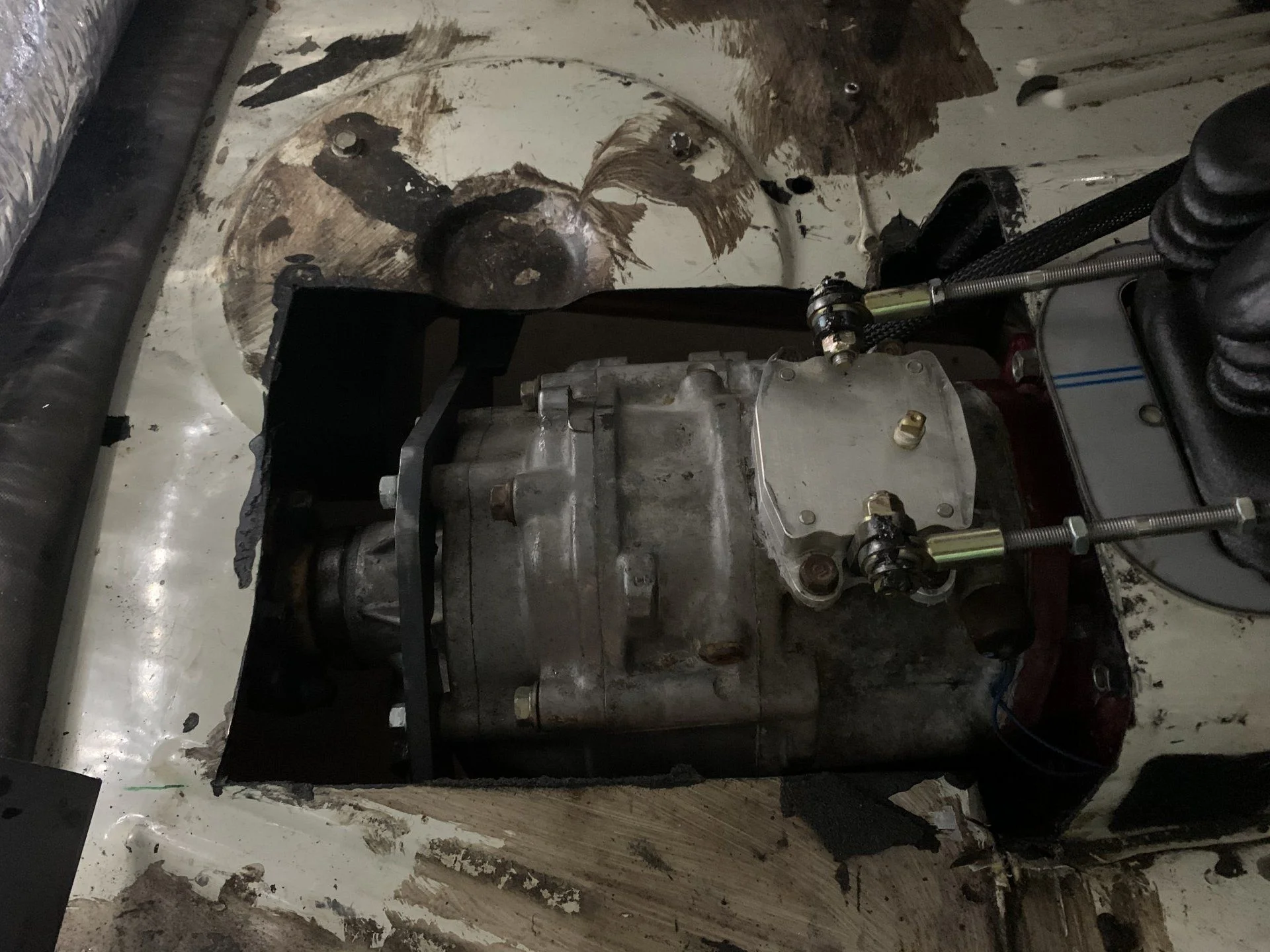

There were two holes for the old shifters and then a huge hole for the longer cases. If there was any question if I am a professional transmission tunnel builder..... I’m not. BUT holes are plugged and there isnt 10,000* air blowing on me at all times. The triple stick part took a min to make it all work. If I get bored, I’ll redo it. Center console should be able to go back in.

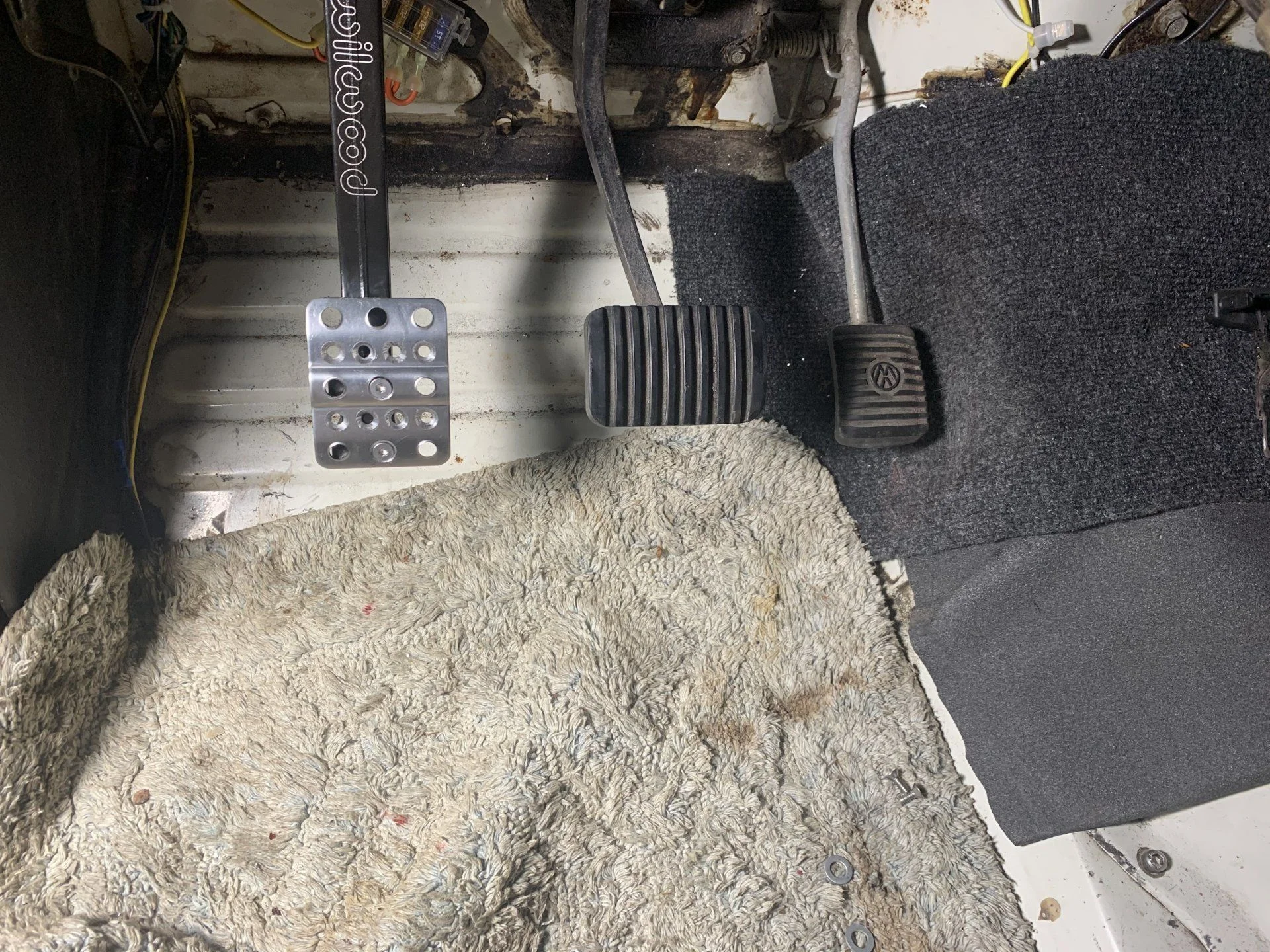

the carpet has a layer of sound dampening attached to it from the previous owner. I think I want to get rid of the carpet, but its still in right now.
