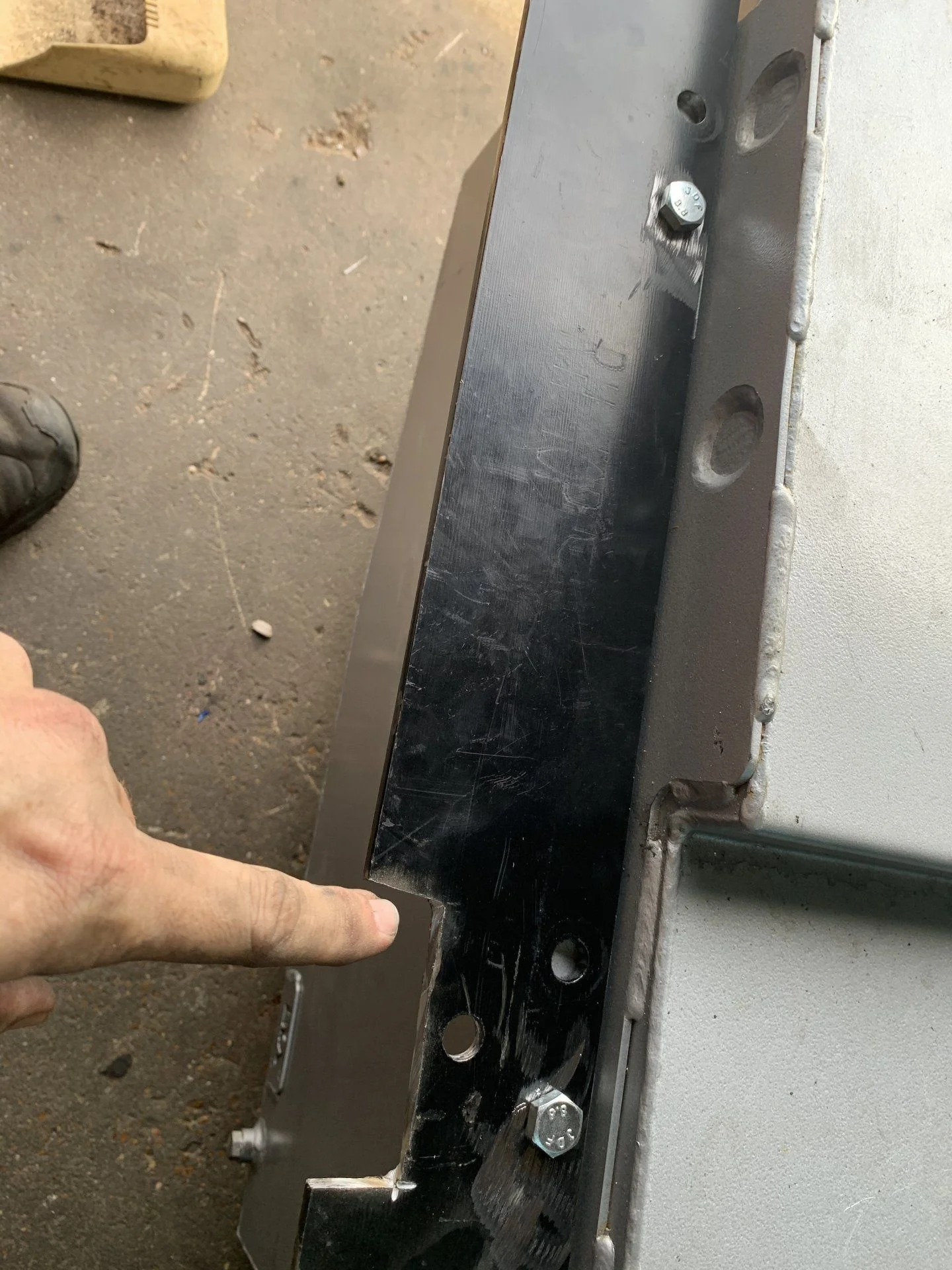

Got to play some today. Once you accept the cut-off wheel life, you just chop chop when needed with no delay. The 80 suspension is in the way just this | | much.
this little pinch weld lip was easy to remove, so 27” of it is gone now. I’ll weld and seal it back.

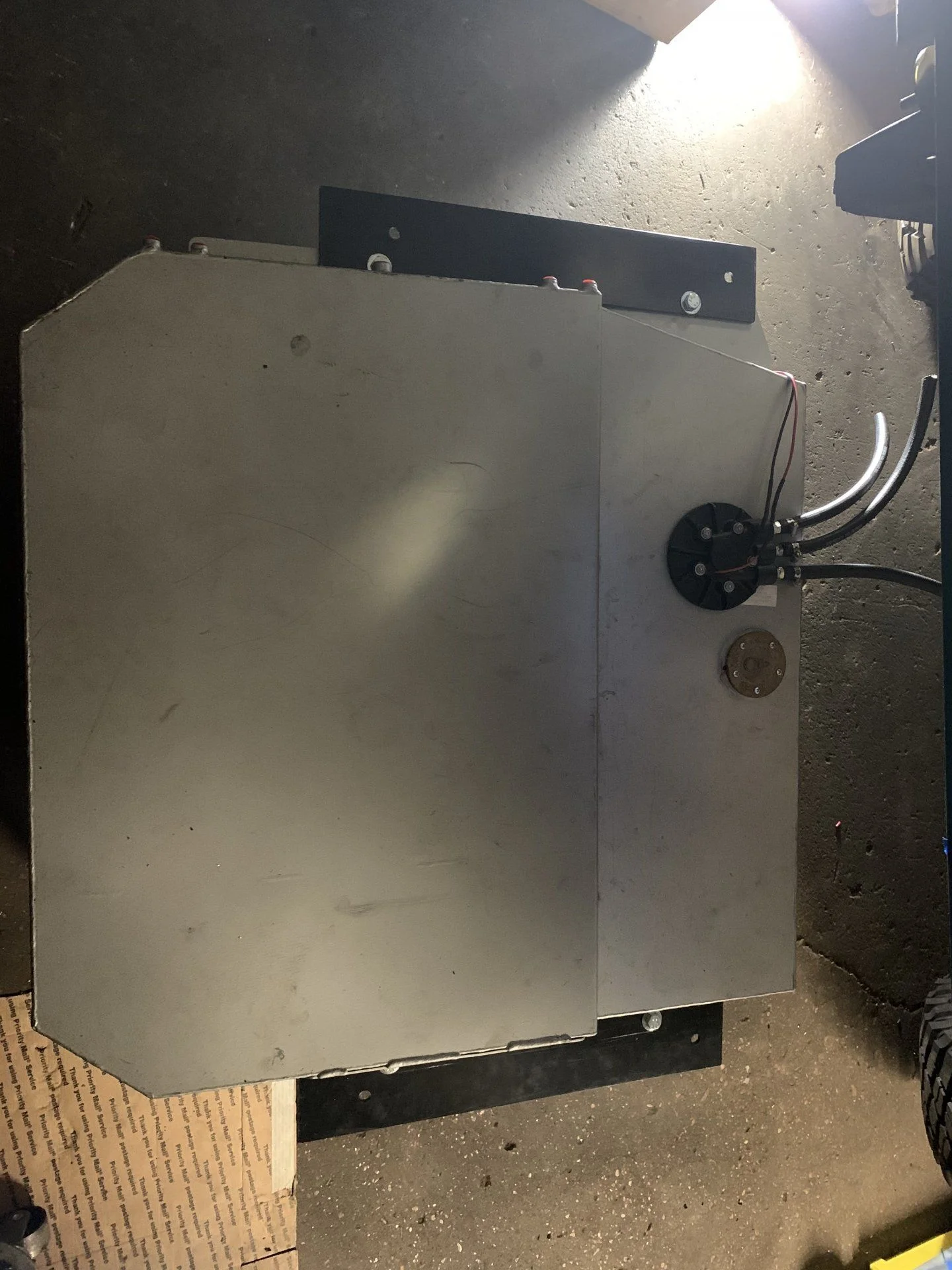

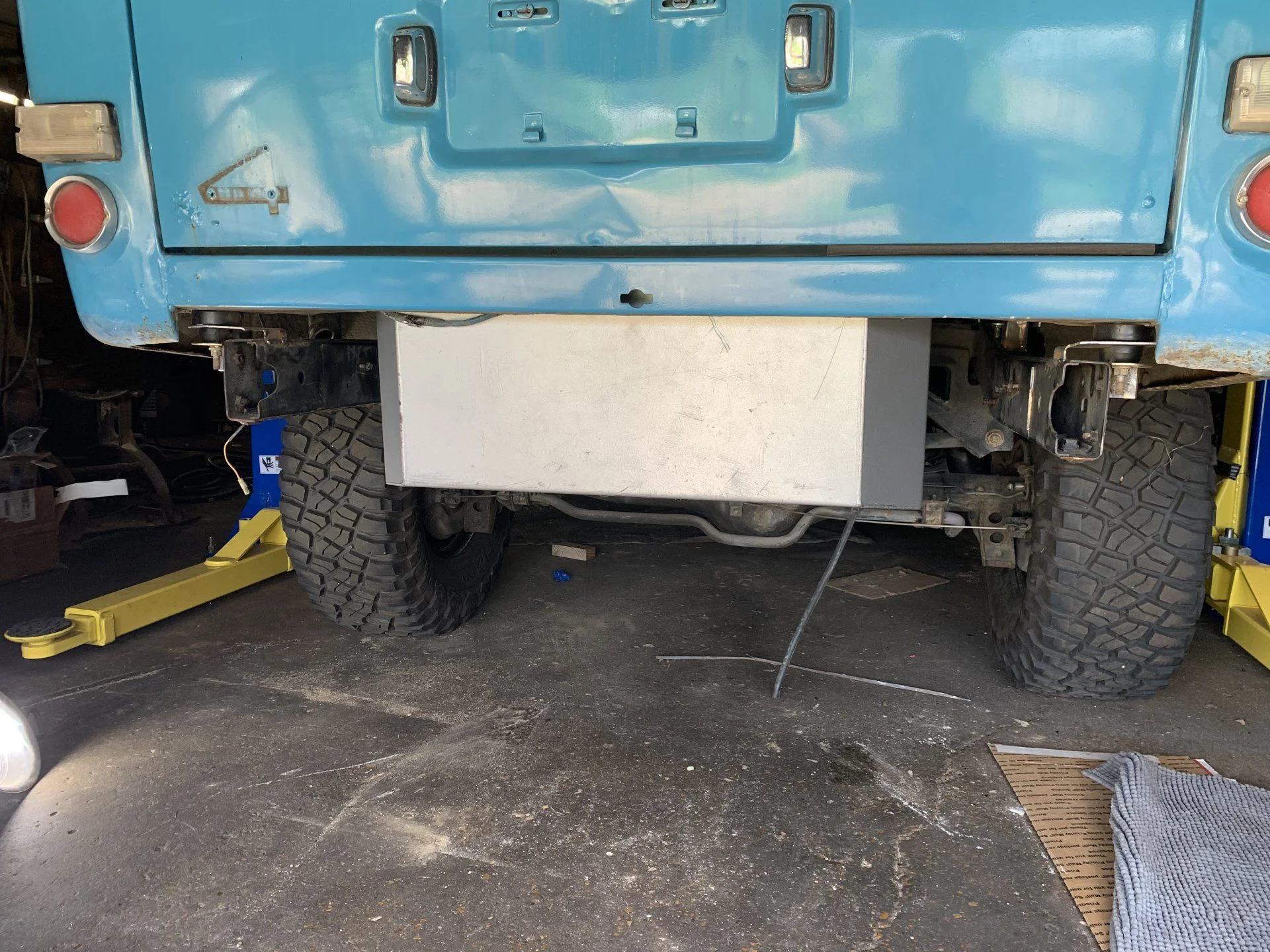

This crazy huge tank fits now. Waiting on the new fuel pump set up to be delivered Thursday before it’s bolted in. The stock 20-ish gallon is too small. This 55 gallon is crazy huge. A 35-40 gallon would be perfect I think. Going to have to fab a skid plate. Rear bumper will cover it some, but damn, she’s meaty.

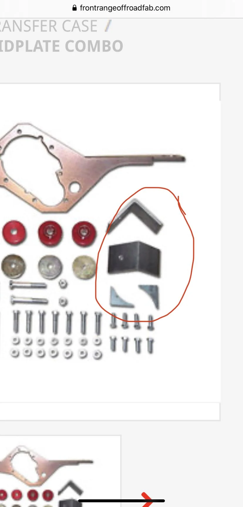

You need to beef up those transfer case frame mounts.

what’s wrong with the mounts?
There is a gusset you probably can’t see in the pics. It’s not just a piece of angle.

Edit:: you can’t see it in my pics, but there is a welded gusset on the 90* mounts

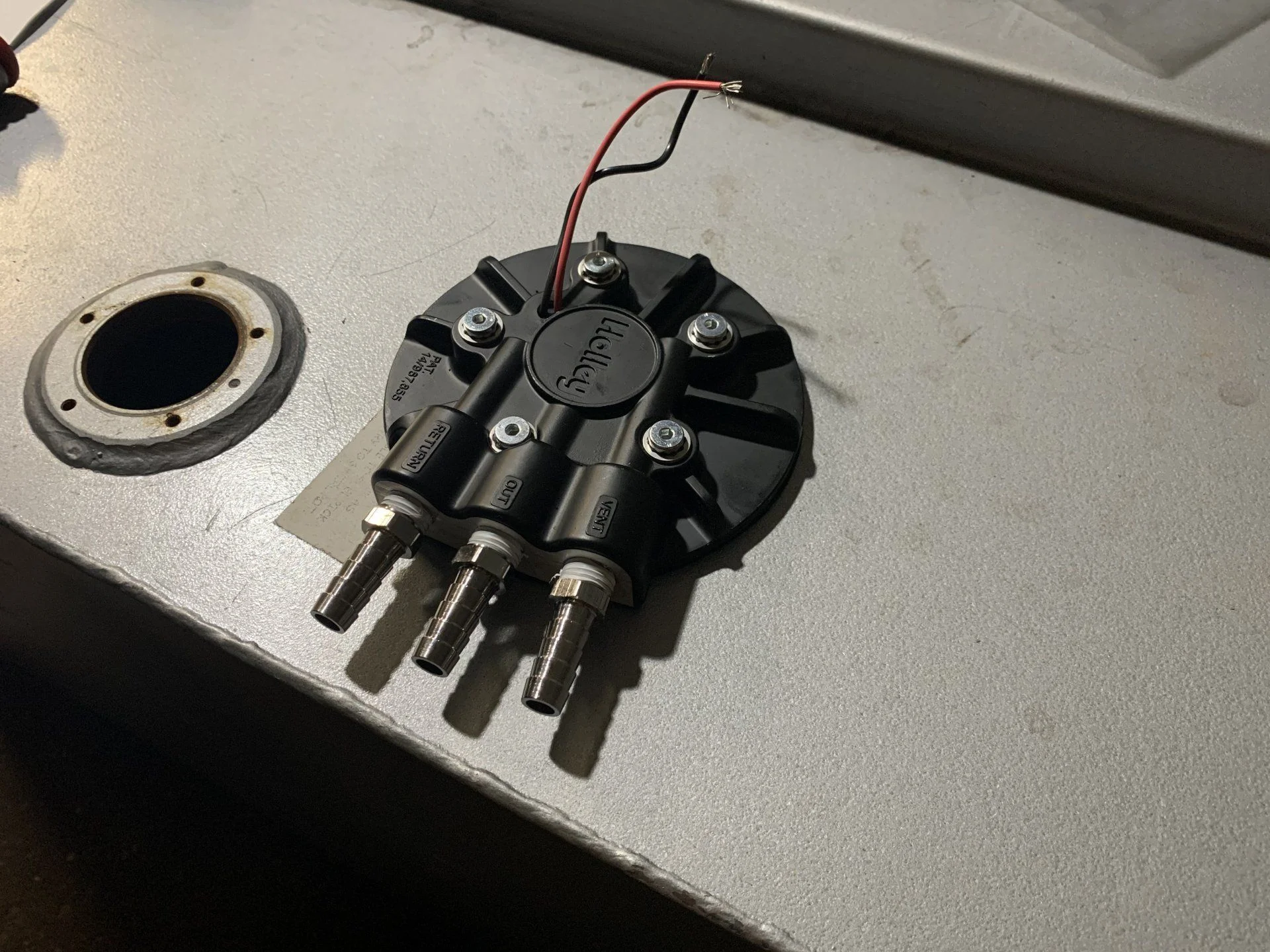

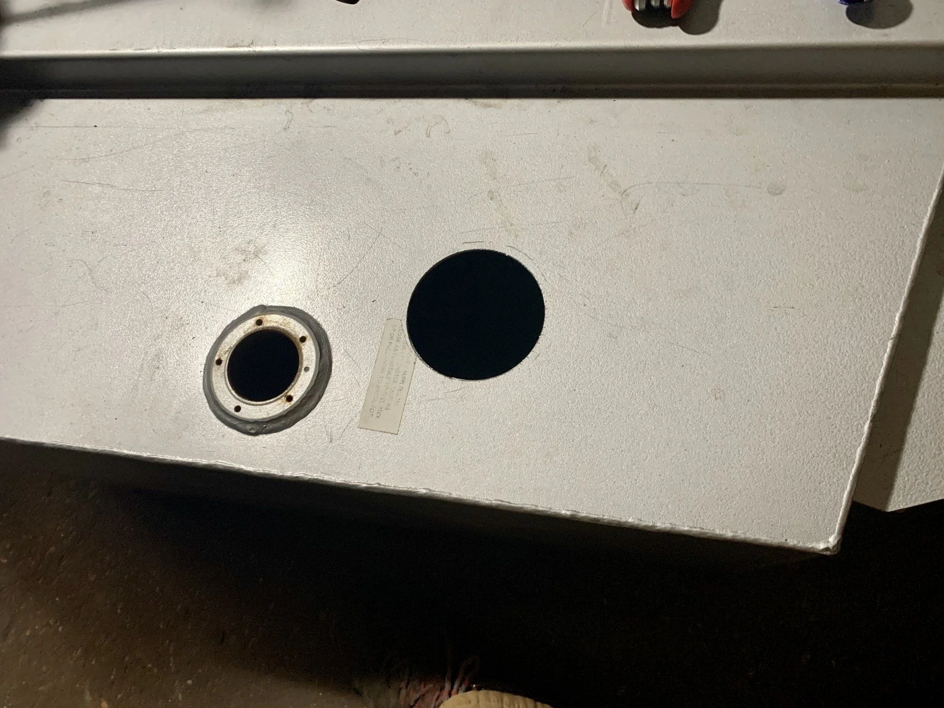

-finally after much much deliberation and measuring and looking and moving this thing around, I finally cut a hole in this bigass tank and installed fuel pump. It’s a Holly setup and come with a Holly Hydramat pickup, if any little part of the mat is touching fuel, it’ll work.
Holley Diecast In-Tank Retrofit Fuel Pump Modules 12-136
due to the body being in the way, I had to mount it toward the front of the tank, but bent some aluminum and was able to push the mat about 2/3 of the way to the back of the tank. I will have to be very very low on gas and going up a very steep ledge for it to starve.
the fuel gage sender arm was extend about a 10” and fits just 1/8” off the floor of the tank on “E”

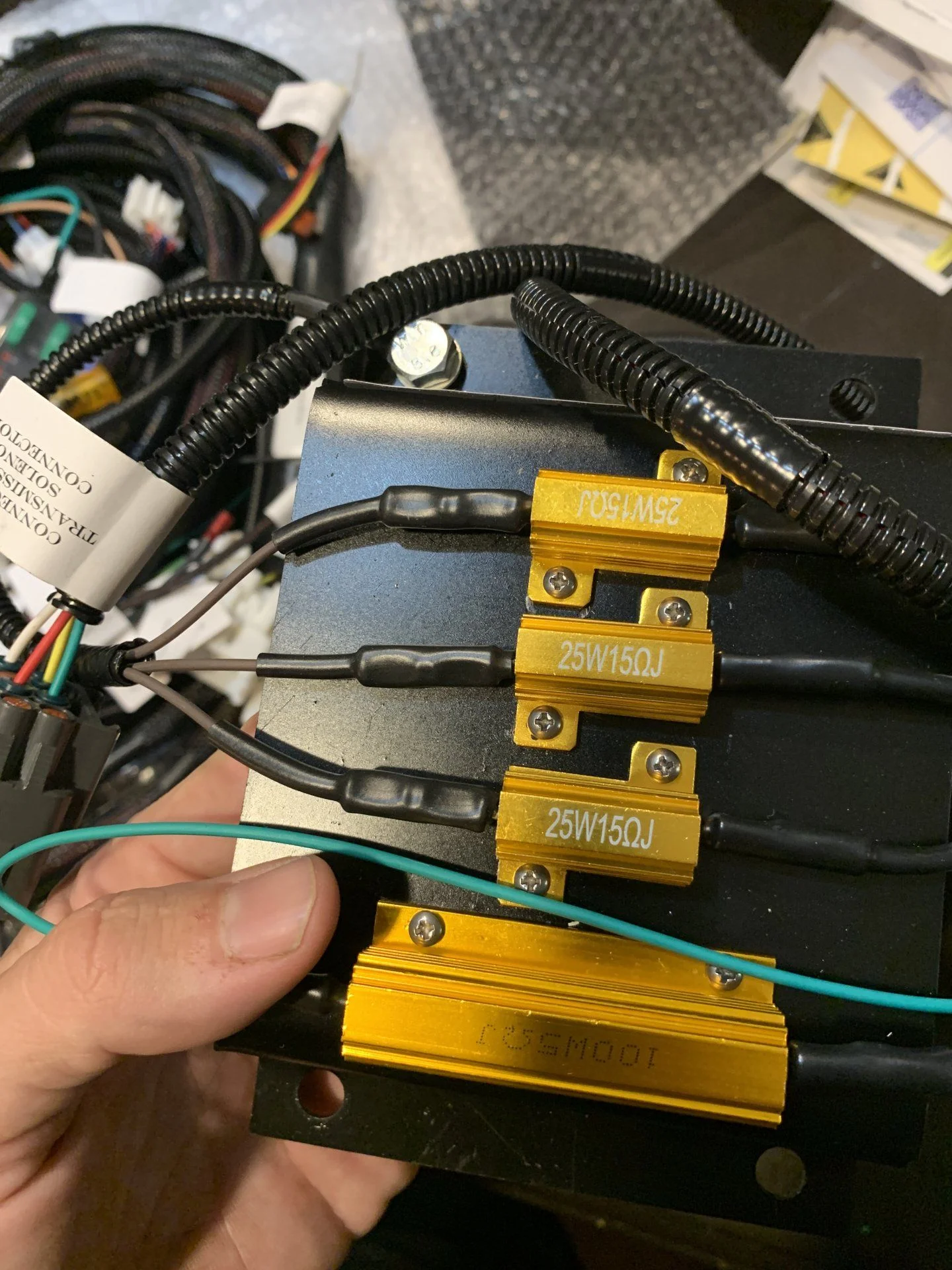

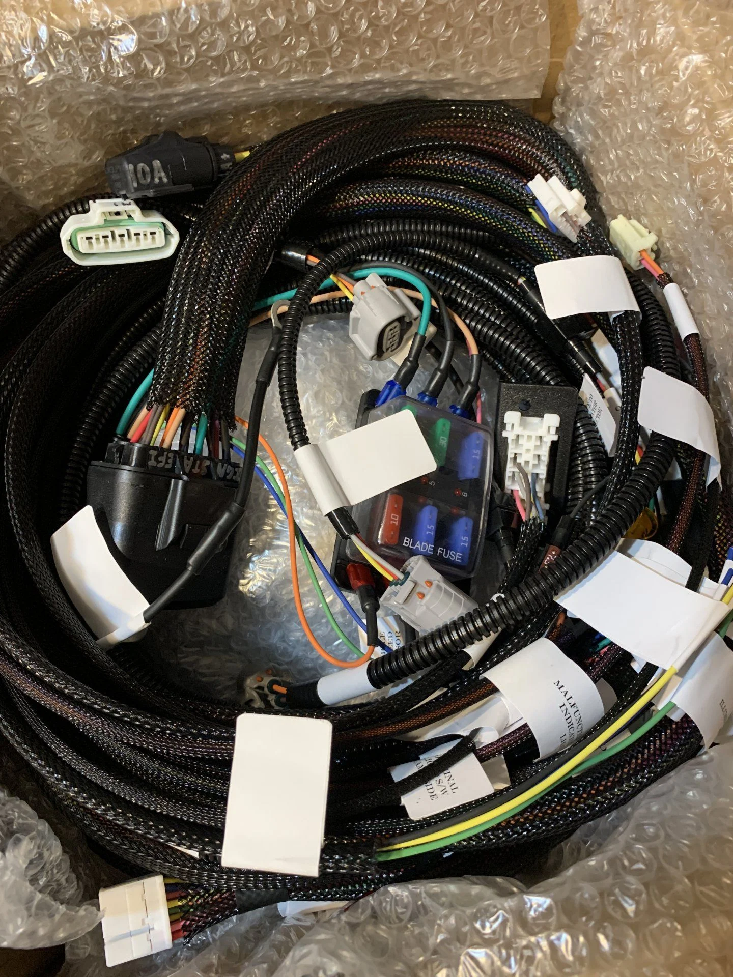

harness finally showed after 4-5 months.
It’s very good looking as well. Really excited to plug it in and cross fingers I’m not missing too many parts on my end. I still haven’t scrapped the LX in case I need a part/plug.

fought this ridiculous tank for hours and hours. The bracket that came with it had to be cut to fit ANY 55. There are only so many was your can flip 2 brackets around to try to make them fit, but I damn sure tried each way a minimum of 4 times each. After cutting them, had to drill new holes to push it backwards some for my 80 chassis. I nearly broke my hand only 7 times fighting this thing.
but it’s in....
it is huge. It will get a skid plate. Will look better with a bumper coving a lot of it

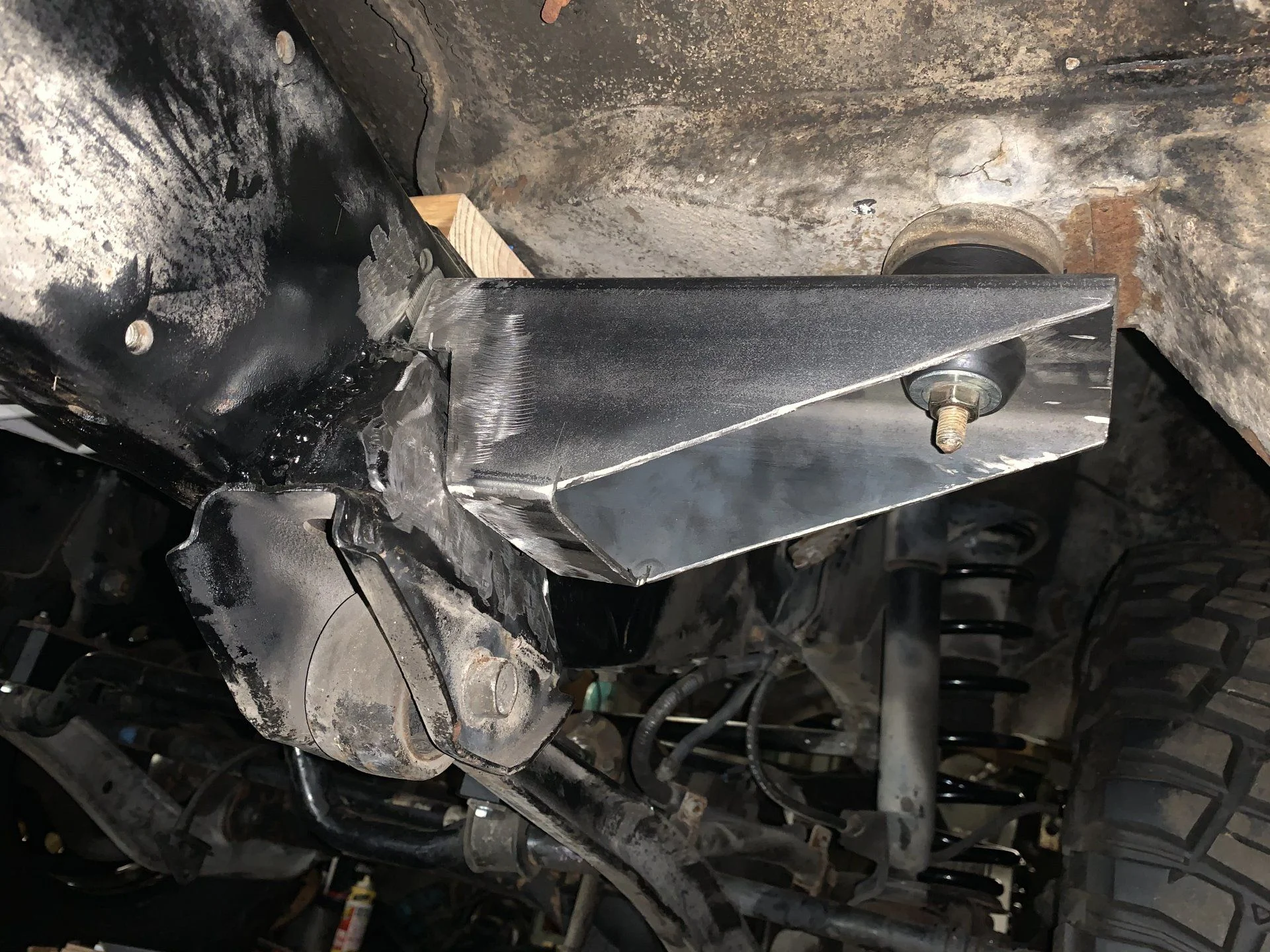

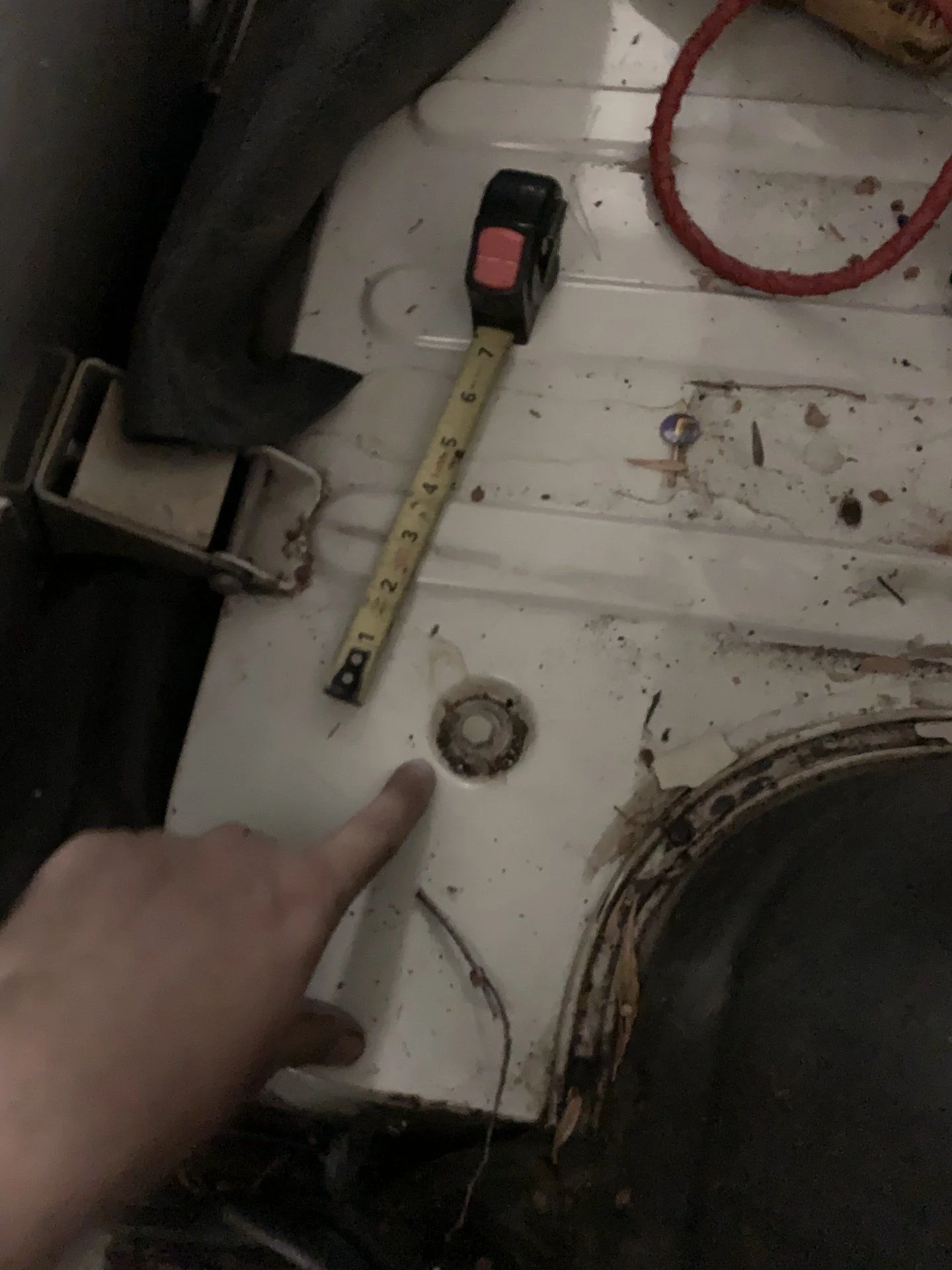

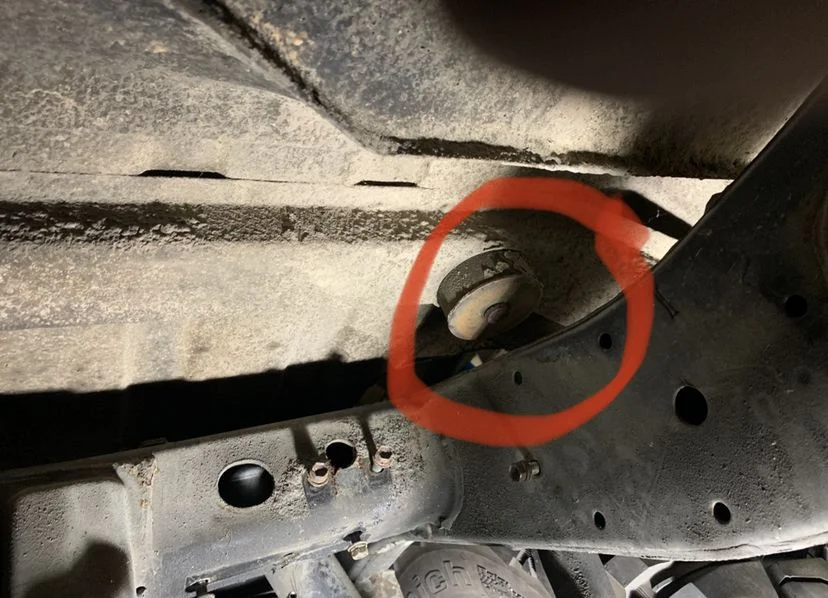

Made 8 body mounts. About 30-45 each for my slow ass. They aren’t beautiful, but the body won’t fall off. Used 4Runner/mini truck bushings and cobbered-fabbeled each mount.
I scratched my head on this one dumb one for too long. Once I saw it went all the way through the body under the back seat, it was an easy fix. I finally drilled a new hole over 3” and BAM, she in.
the ones under the driver seat were easist to access, but had to measure, cut, measure, fit, grind, fit, to get it.
