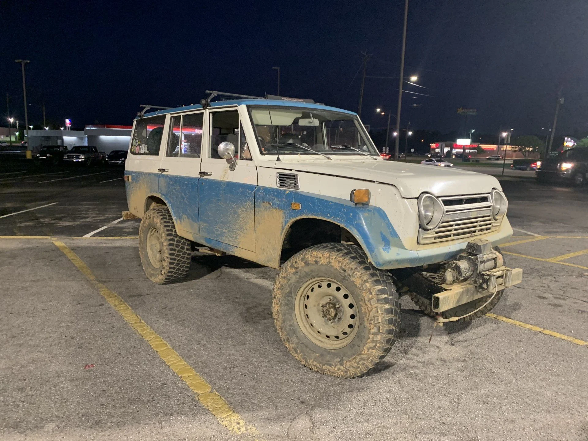

Builds “It’s only a motor swap and an axle swap” FJ55, 2UZ, 5 speed, 80 axle build
More
Let’s see.

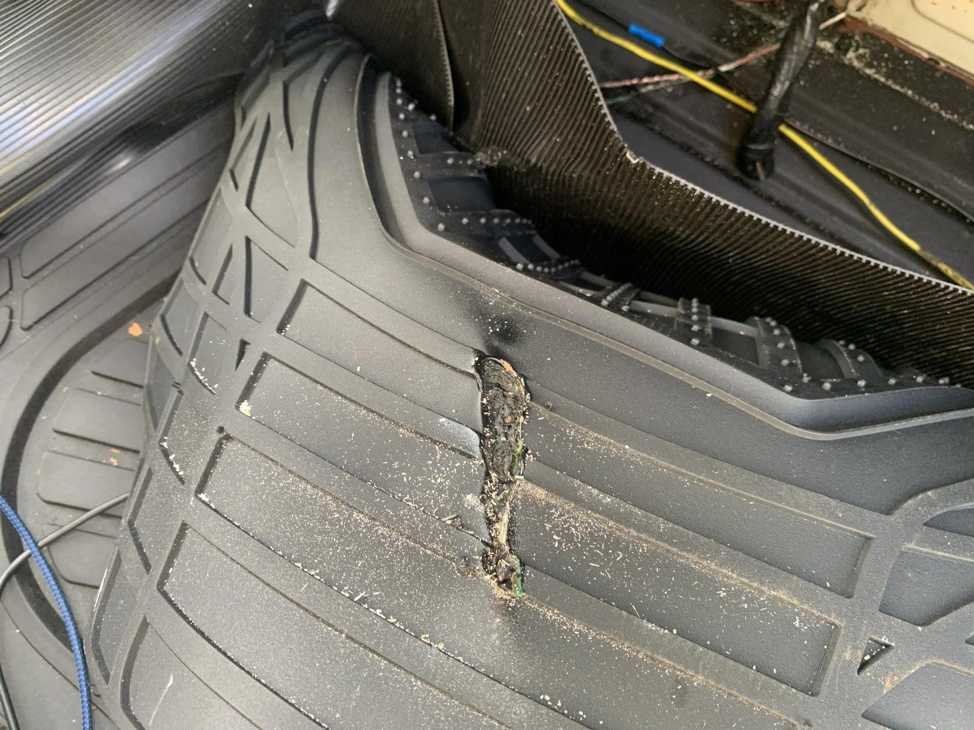

The day I wired up the radio was 6 days into sitting in hospice watching my father in law die. I may have been drinking too much that night and not wire in a fuse....
This lead to the wire chafing, grounding out, and a small electrical fire, melting the floor mats, and filling the cab with smoke on the way to the SSS in Arkansas. Almost became the FryingPig instead of the FlyingPig. It was exciting.
Glad u got the fire out in time, electric fires are no joke
To all of the haters’ joy, I had more electrical issues on day two. After hours of poking, prodding, blowing fuses, blowing more fuses, hot wiring, we bypassed something in the ignition that is grounding out. The ECU is hot wired right now essentially. Oh boy did the leaf spring 2Fers love that I was having issues. It is something in the 1973 wiring, not something I did, which makes me happy.
yessir. I shut if off immideatly (which didnt matter really) has a fire extinguisher in the cab, and my son dove for the ditch ASAP. I had visions of it burning to the ground in front of me for sure.

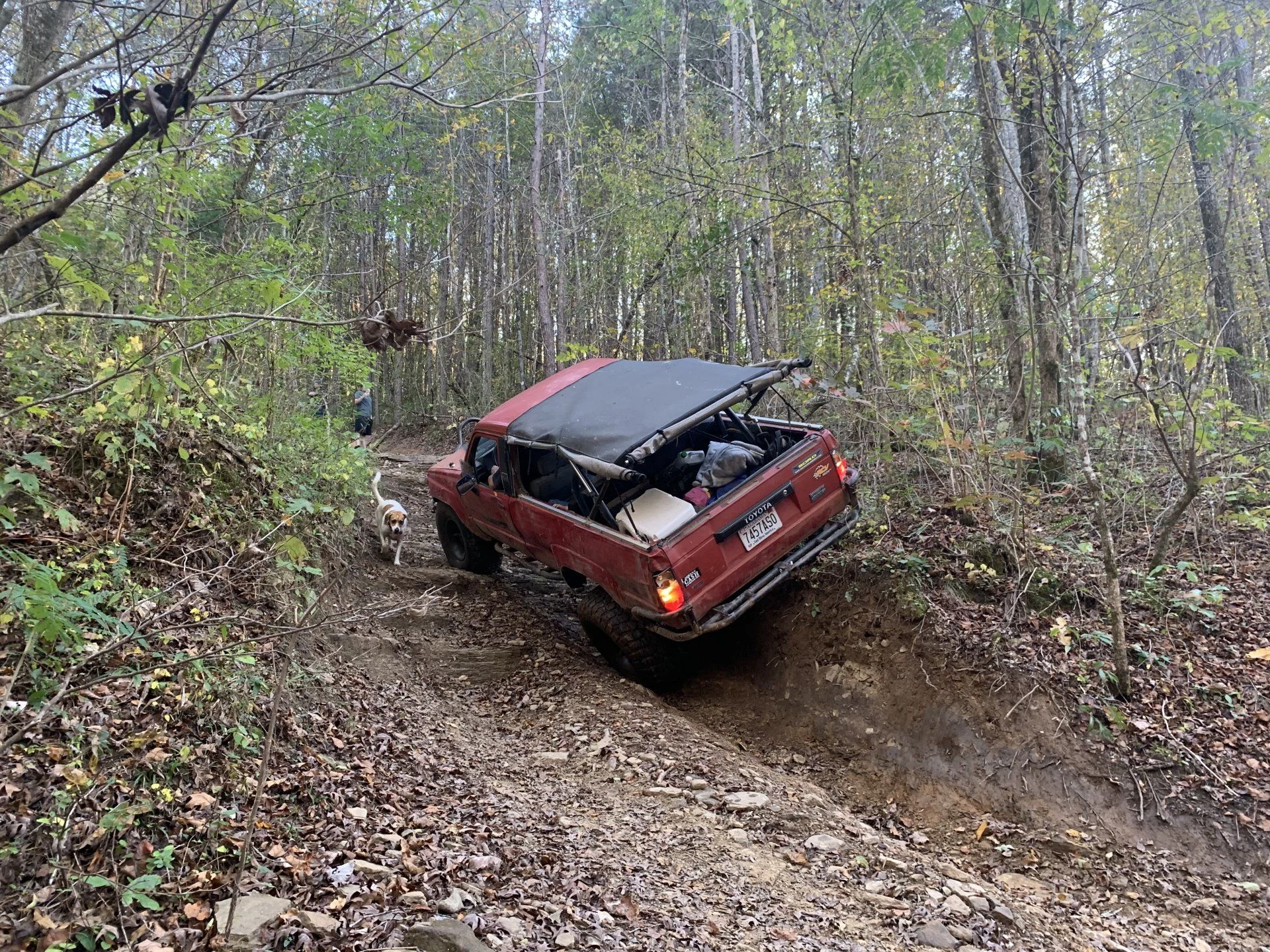

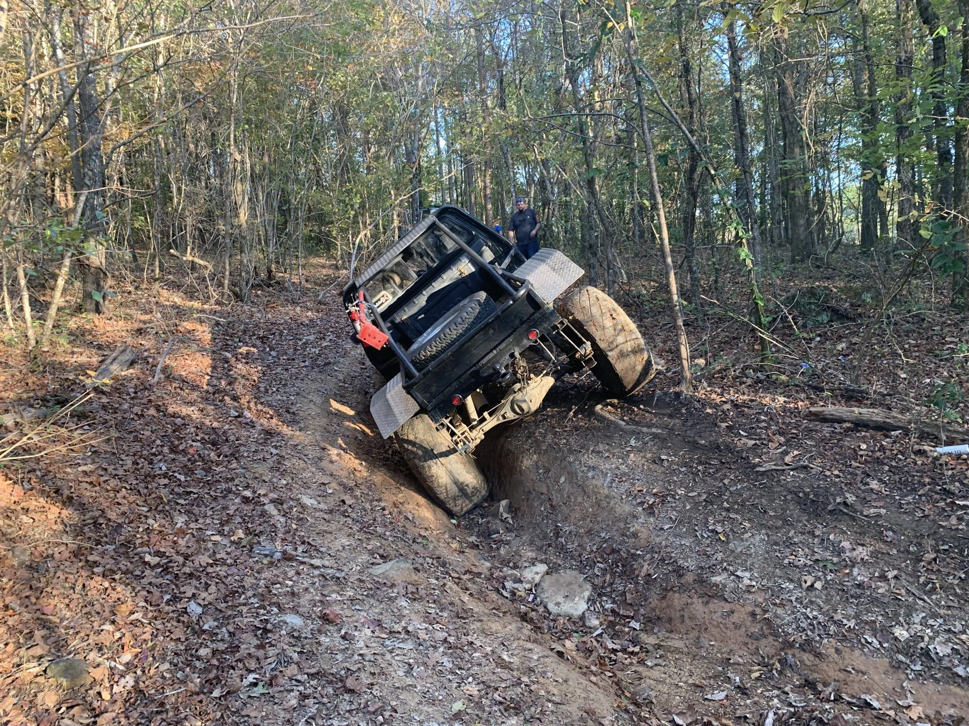

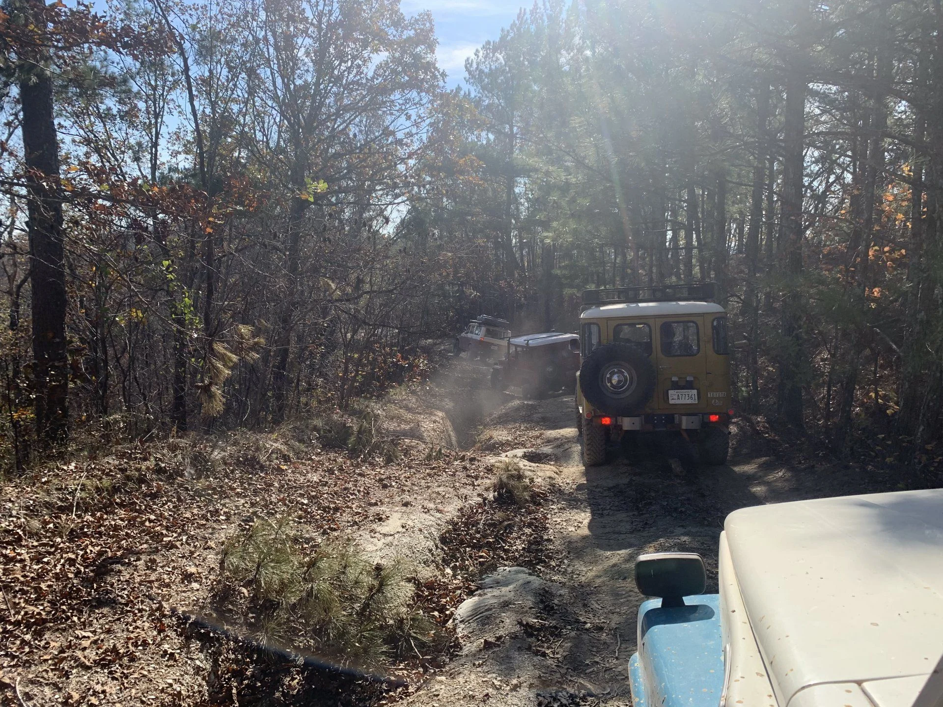

Had a great time with the welded diff, trailered, mini truck guys yesterday. 80 miles at 80mph each way, and some pretty solid trails too. 80 suspension works great. No issues with my rig.
was supposed to an “overland” trip, but it all worked out
