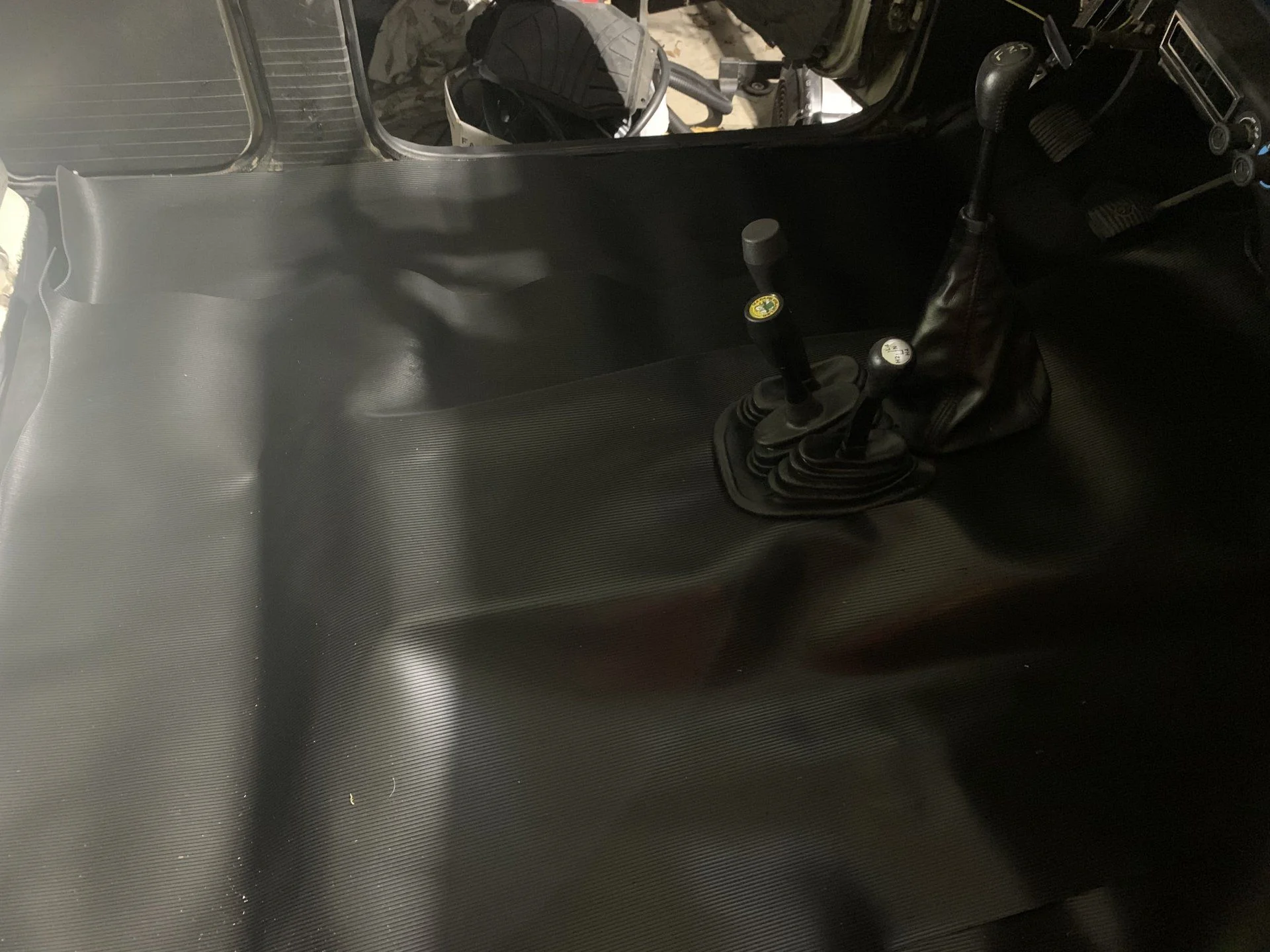

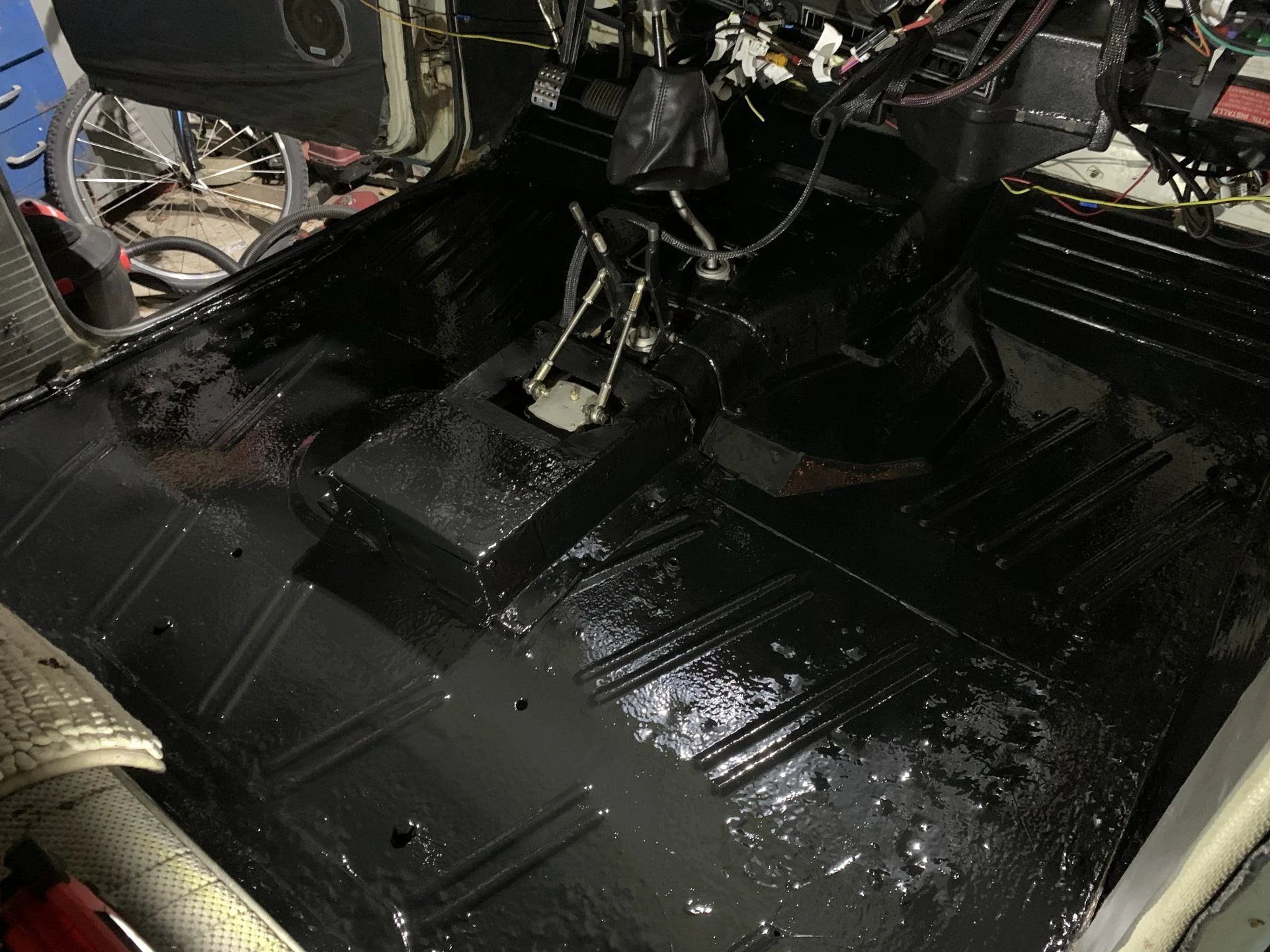

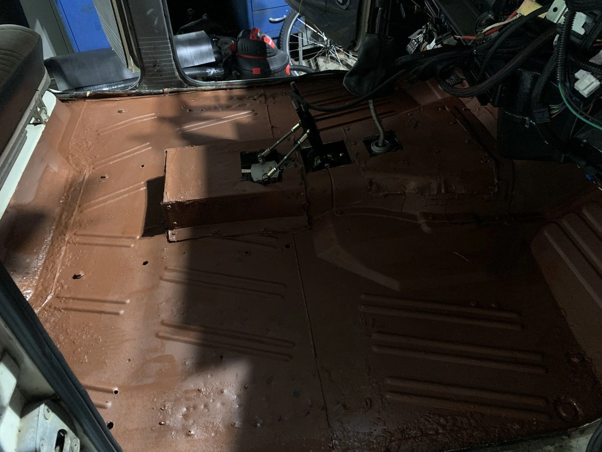

got the inside sanded down, rustoleum base layer, then two more layers of sound deadening paint.
got this thin rubber mats from Lowes and put them down. Ive never driven it with the windows up so I’m not sure how well the sound stuff works really.

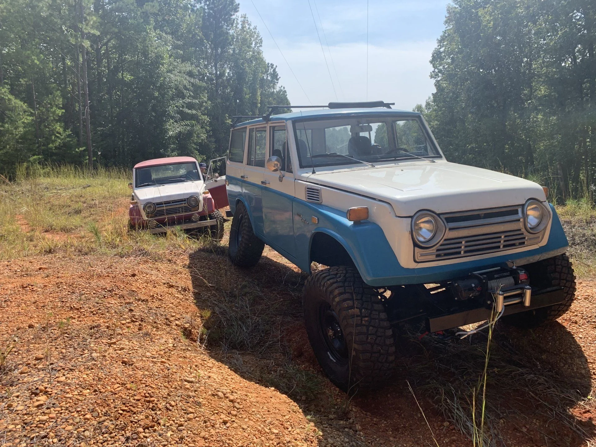

Ive put 150+ miles on it with no real issues. The rear output on the Tcase and PS is oozing some, but it drives really really great. Hits 70-80mph pretty fast and is a blast on dirt roads and fields.
Getting rear seal, front driveshaft, hubs, and a few little things done, and then go ride some short trails next few days

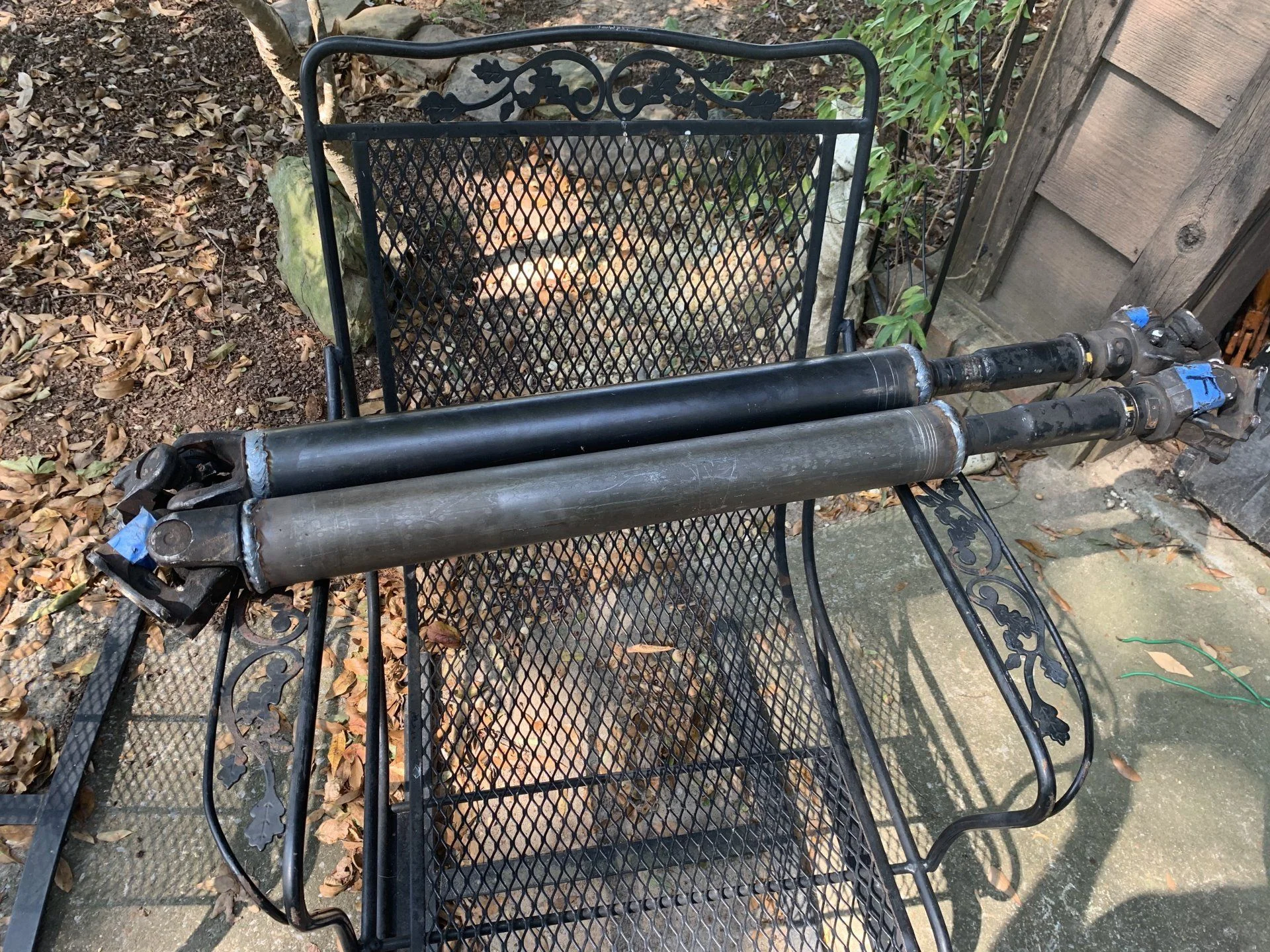

Have a thick wall and a regular front and rear drive shaft. Never know when I’ll need it.
little lake action with the boys. They all agree I need more than one working speaker and that this is the only cruiser I’ve ever had that “sounds like a race car”

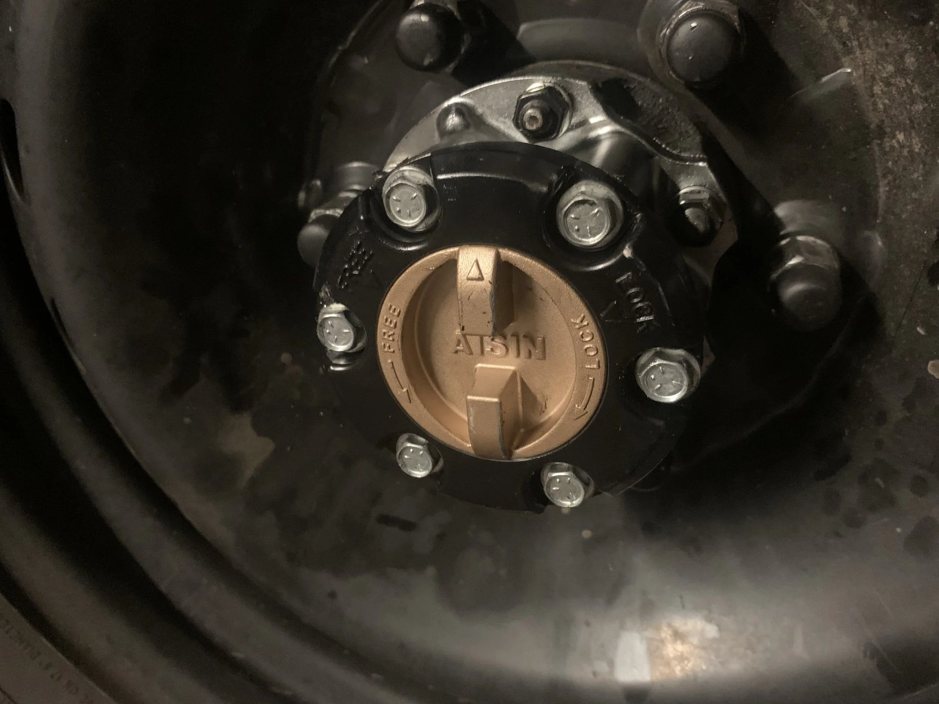

-got manual hubs on

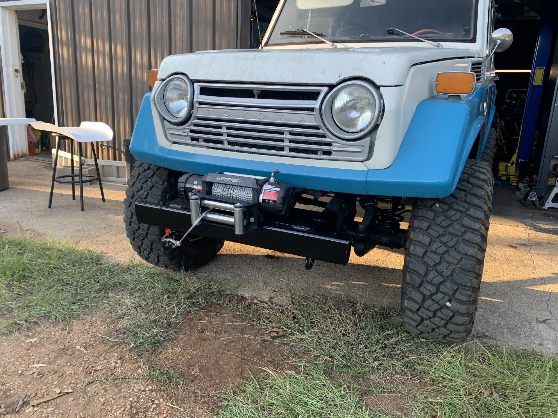

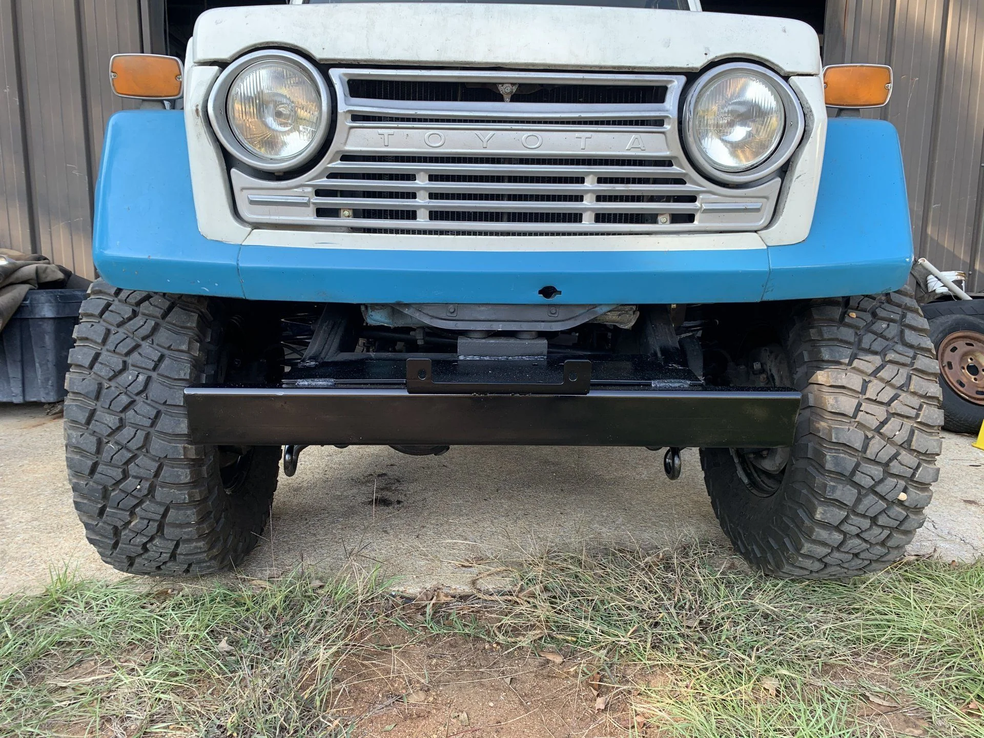

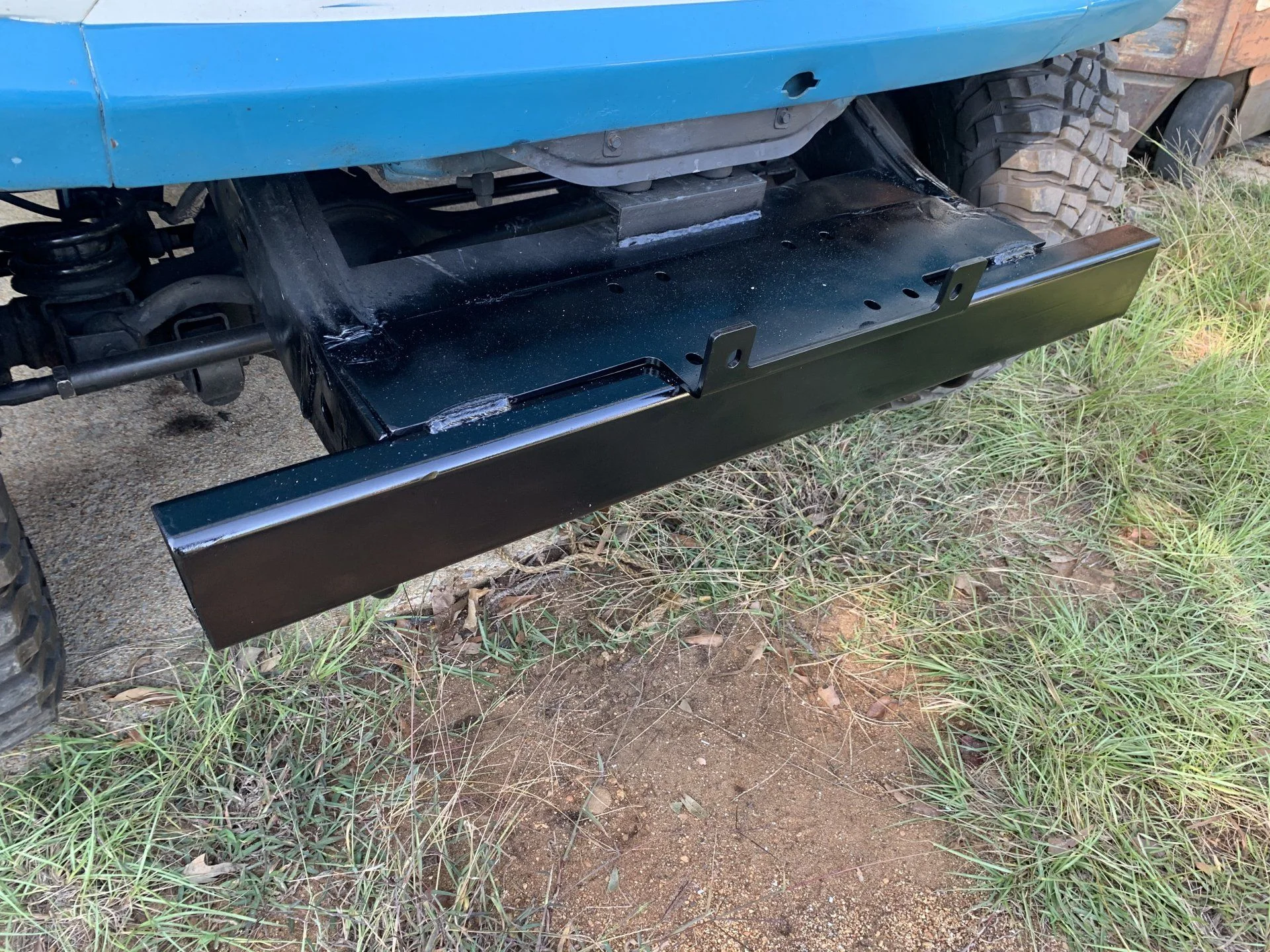

Had this winch and winch plate in my storage room from three Christmas’s ago. Never made it onto my sons 4runner before he sold it.
Original plan was to mount it below the frame and hide it like JMacks, but with the curve in the 80 frame and my “body lift” I think mounting on top filled that gap better and it sits about 3” father back too

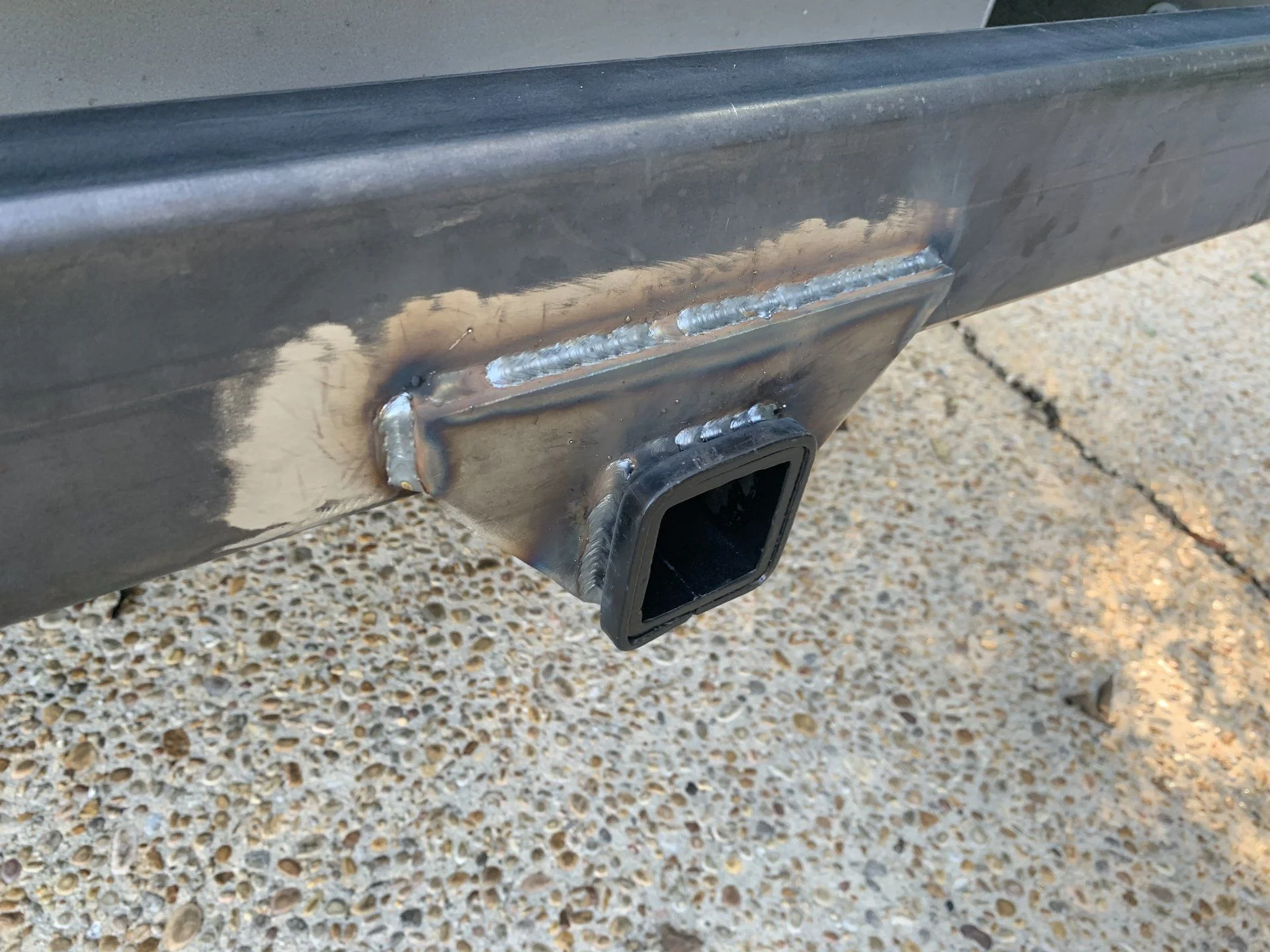

4x2x1/4 tubing. Tried to make it blend into the angle of the snout some.:meh: I went ahead and welded it on. I can’t think of a time when I won’t want a bumper or winch. It all fit together so well.
a synthetic line and low profile fair lead will clean it up some too.

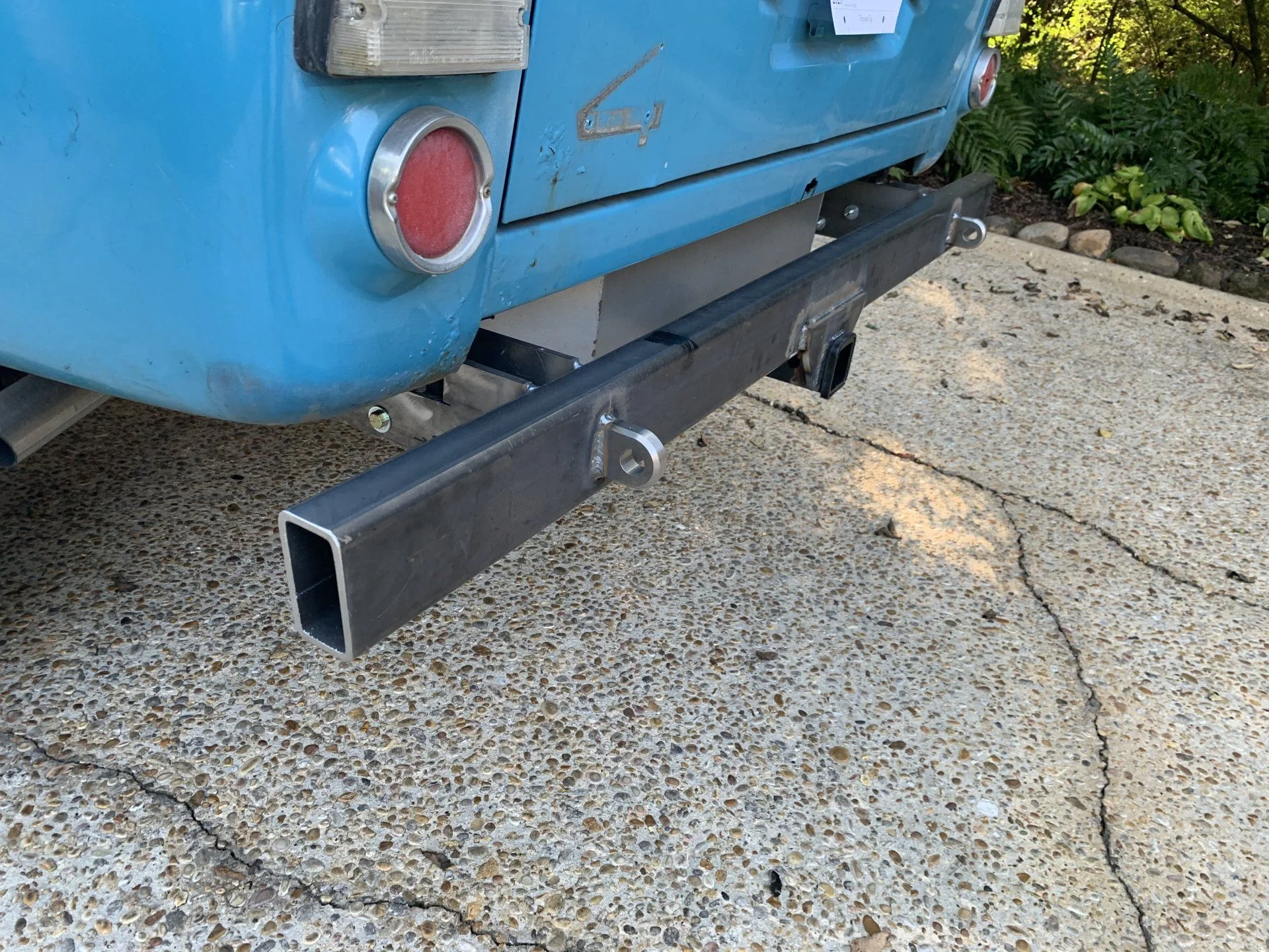

got a lot of the fab work done for the rear, but ran out of time shuffling two kids in sports around.
Got rear bumper mostly done. I want to build some sort of rear 1/4 protection. Haven’t decided what yet. Need a 90* drill for the last bolt hole on both sides and some braces/box in plates.
Going to paint this silly gas tank black. Really need to order my skid plate material.

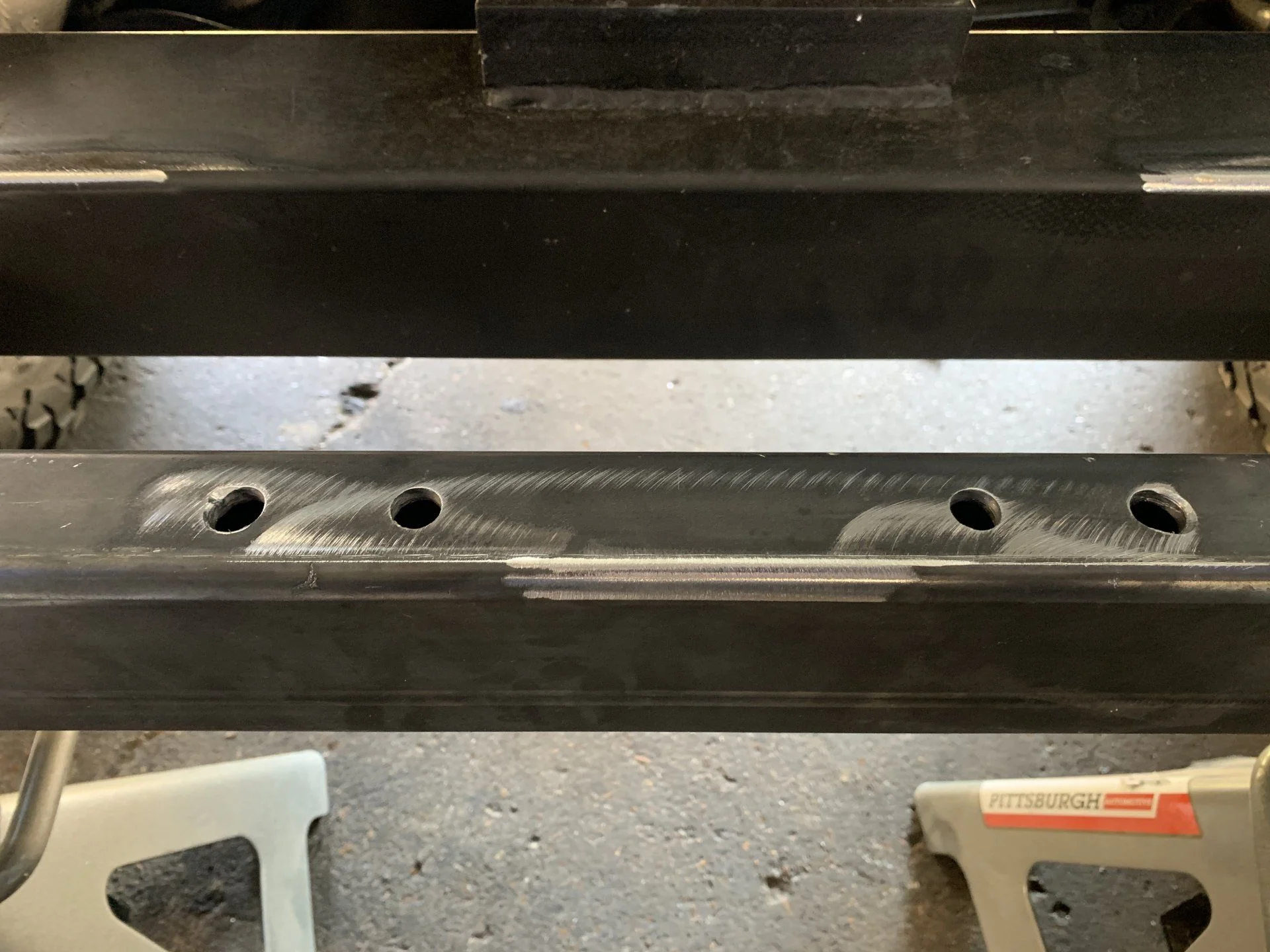

more C- to B+ welding pics for your enjoyment!

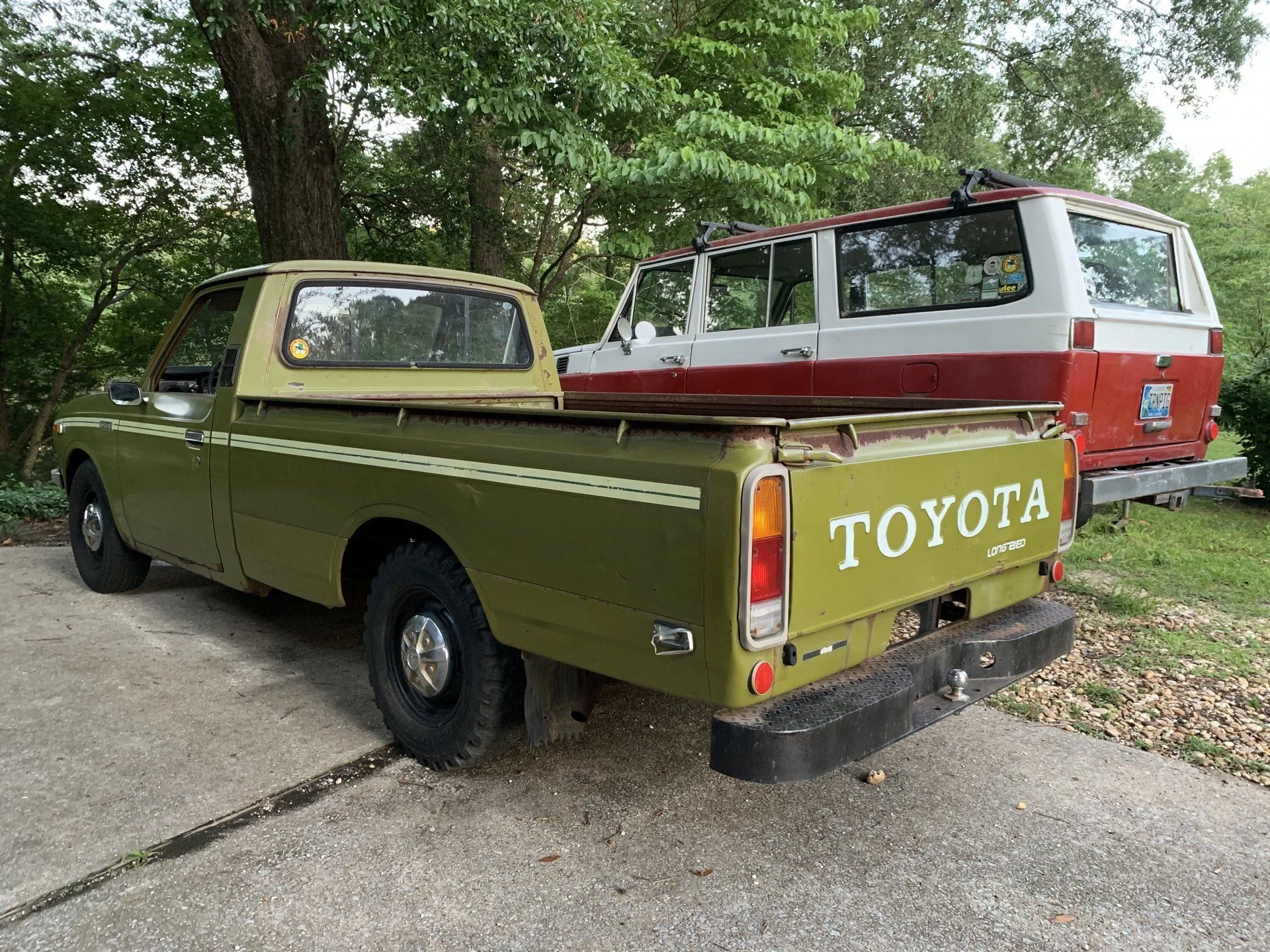

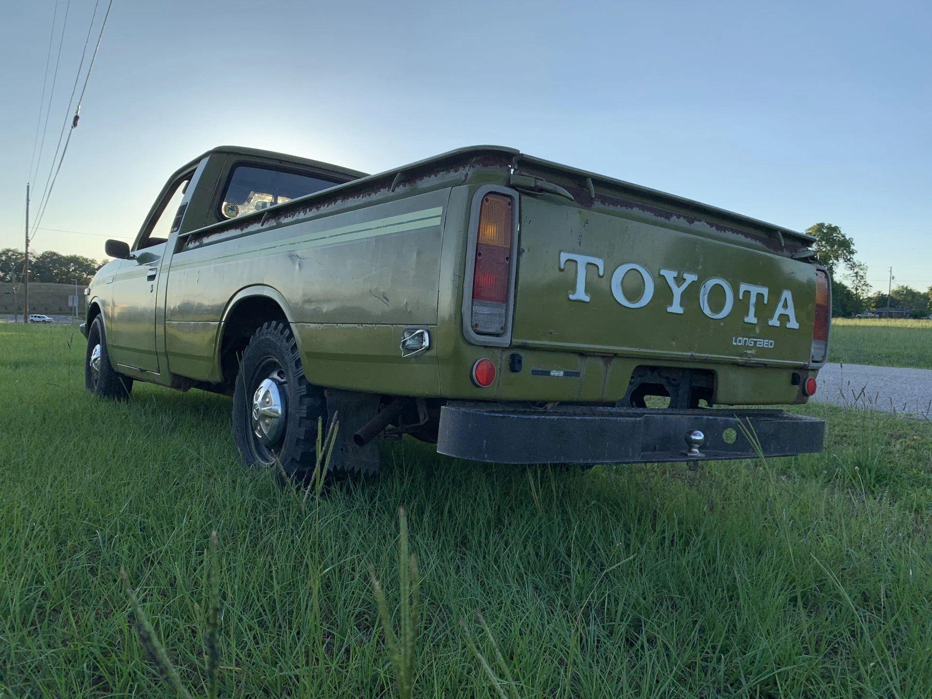

Pigs in the wild!
i think I have my ‘69 pig sold to a good friend’s son. He drives a ‘77 Hilux now and is moving to Montana to work. His first time ever locking in hubs was on the ‘69. He’s hooked!

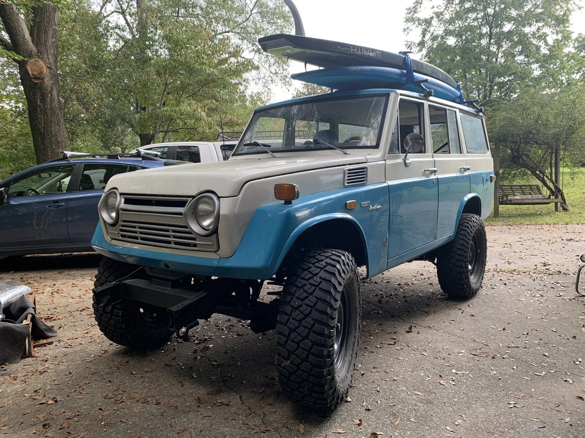

I have to extend my rear bump stops asap! Body eating the tires.
have a little driveline vibration. Not tires. Probably getting some adjustable rear upper links and play with pinion angle. My rear DS is much shorter than an 80 and i have about a 3-4” lift if it was on an 80.

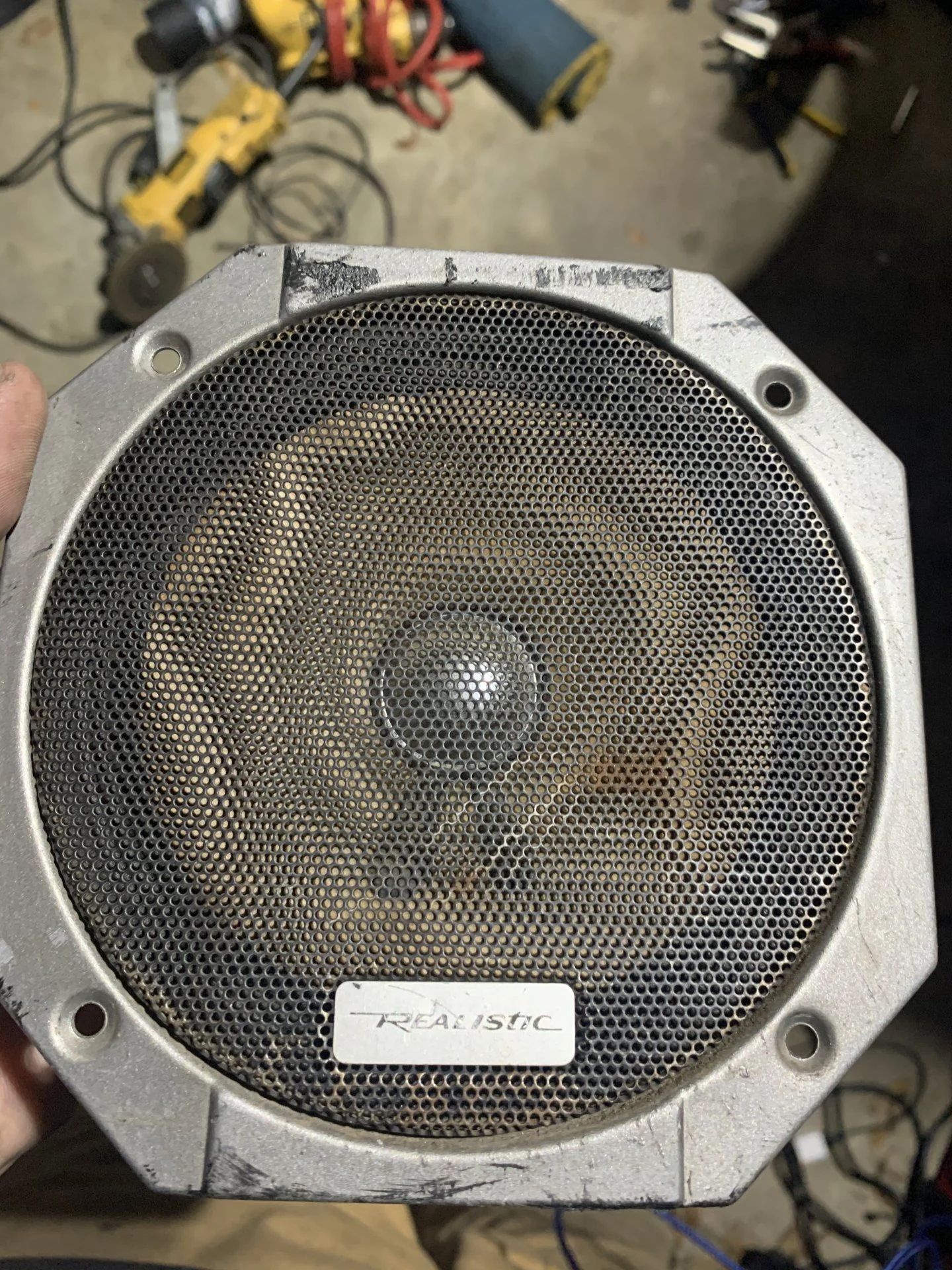

x2 6.5” speakers in the front doors and x2 6”x9”s in the back work great for this truck. Only one of these old “Realistic” was working before.

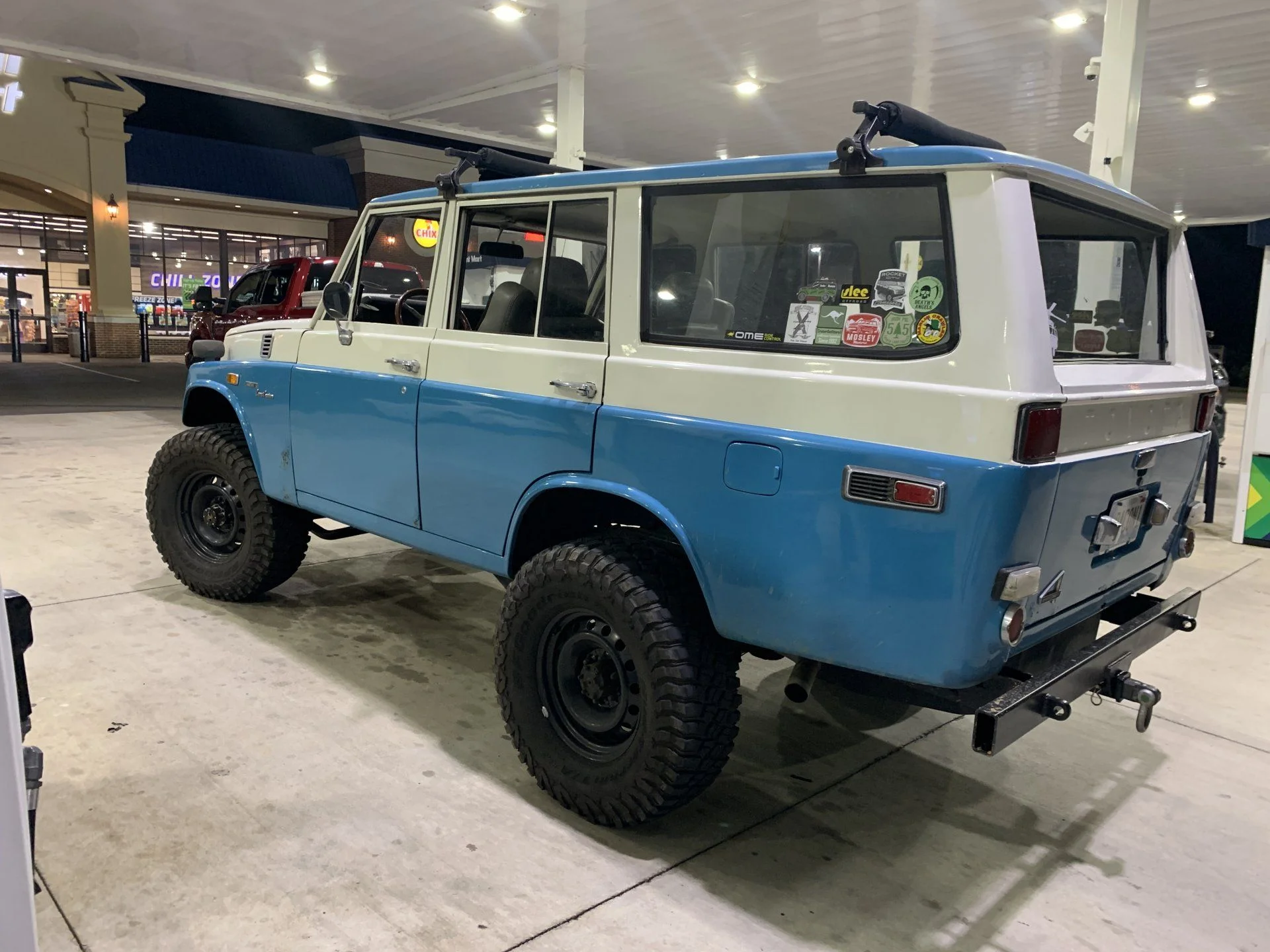

throwing in the 35” spare, I was very glad the speakers came with a cover. Instantly hit it. Need a swingout carrier, but not before next Thursday (—> 2 weeks ago?)

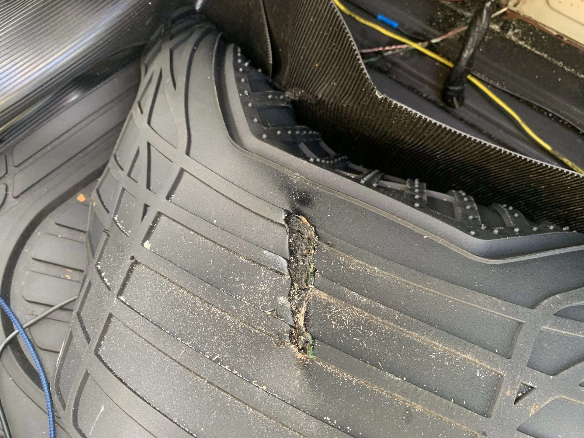

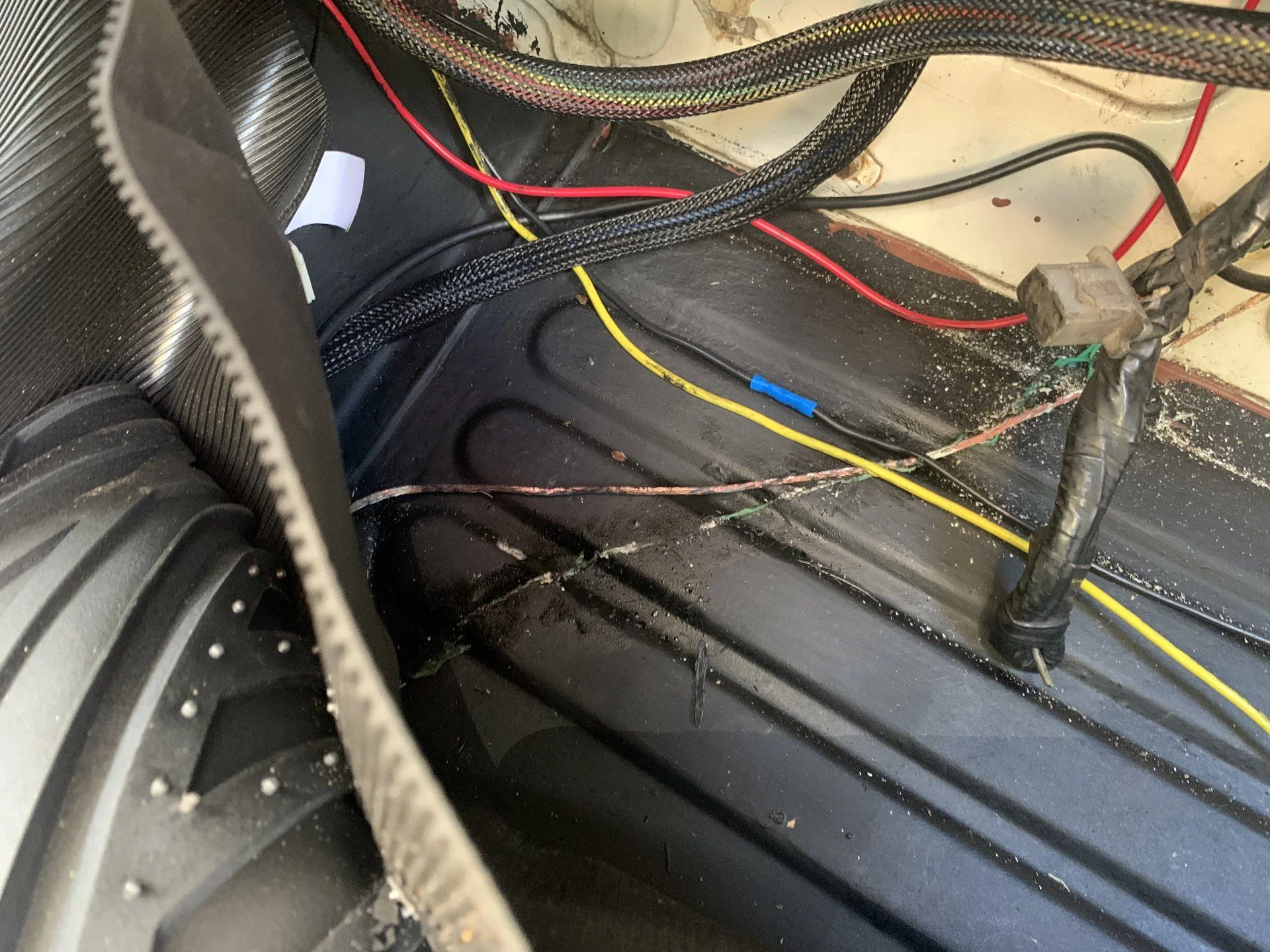

The day I wired up the radio was 6 days into sitting in hospice watching my father in law die. I may have been drinking too much that night and not wire in a fuse....
This lead to the wire chafing, grounding out, and a small electrical fire, melting the floor mats, and filling the cab with smoke on the way to the SSS in Arkansas. Almost became the FryingPig instead of the FlyingPig. It was exciting.
