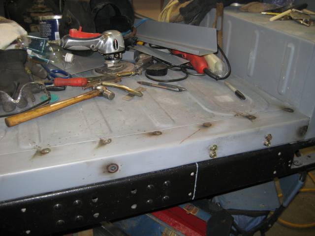

got some more work done the past wek. These clips for holding work quite well. I am happy with the result:beer: :beer:

lincoln migpak 10...110 volt....025 wire with 75/25 gas.

here is the rear sill cover. cleans it up nicely.
Man this is a slow process!!!!

Great sheet metal work!
