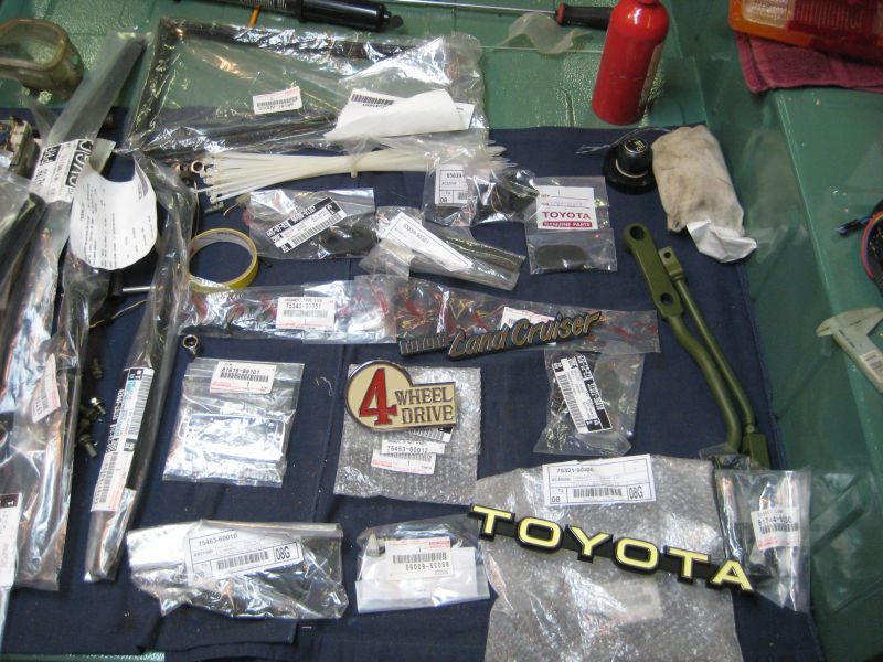

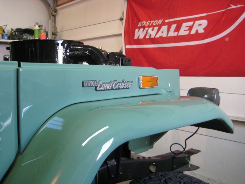

So there has been some progree in the past few months. Nothing happened all summer long as I was busy with vacation and family. All the hinges and small body pieces have been painted. Body is permanently mounted on the frame.
I just received $800 worth of OEM parts from Doug @ Rusty Wallace Toyota and $300 worth of stuff from Cruiser Corps.:clap:

Those new marker light gaskets and retainer ring made the old lens and lamp look like new, not to mention the new emblems and signal light.
