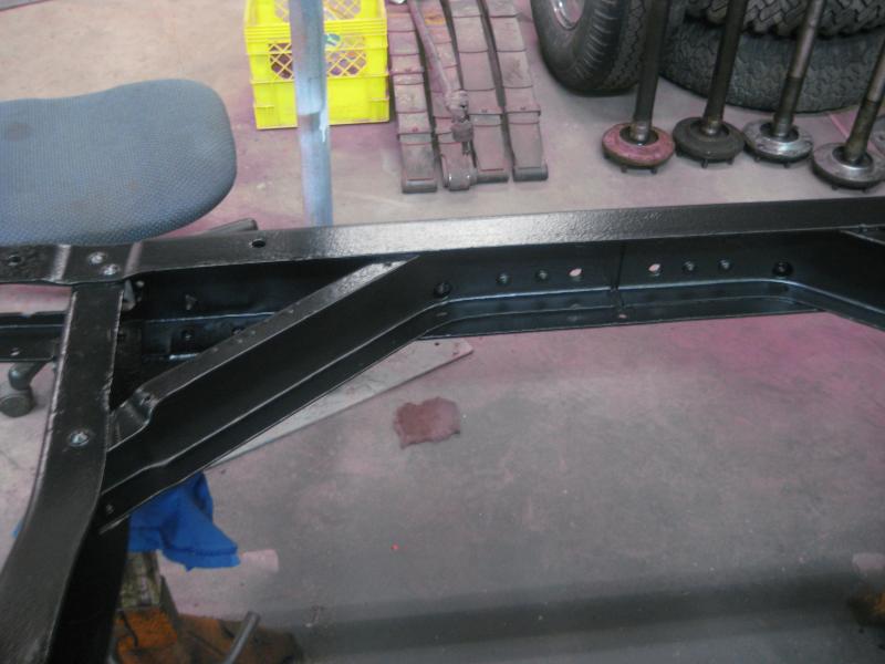

finally started back! Moved the 40 to an auto club I joined. It is signed in as a long term project at only $200 a month for space rental and tool use:) Plan is to have her finished by the New Year:hhmm:
Disk conversion from the 60 series has been POR'd. Frame has been completely painted outside and inside. Front axle has been glass beaded and primed and painted. BJ70 rear axle has been stripped down to get bead blasted and will be painted and rebuilt. I am using a BJ70 rear axle because I need park brake set-up. Reason for that is the h42 tranny is comming out and spare h55f:flipoff2: I have kicking around is going in.

I Have put quite a few hours on the 40 in the past few months. But when you tear everthing apart, bead blast, epoxy prime and color coat, it takes a long time to accomplish anything!:doh:
Both axles and suspension are back on the frame, the front diff is installed and the axle housing opened up for the bj60 disk set-up. Waitng for the knuckle alignment tool from Cruiserguy.
