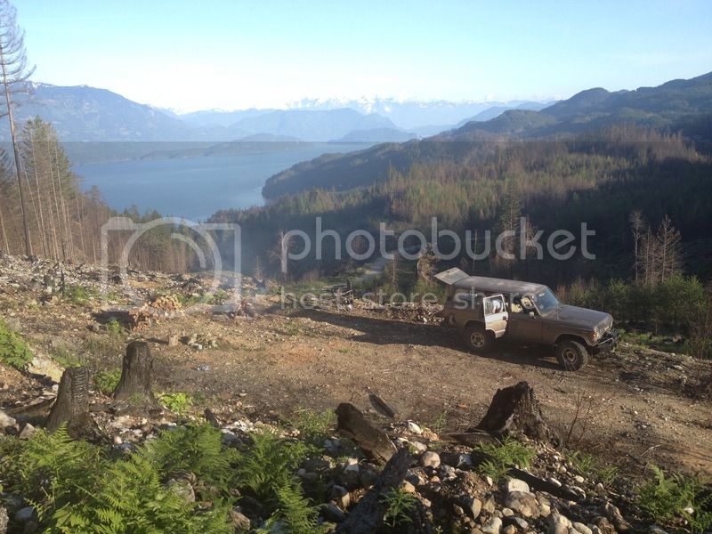

and I don't take too many photos, but this is from this weekend.

What intercooler are you using? I can see it poking out through the grill in the first pic.

It has got a pretty big intercooler on it, I think you are right about an increase in the turbo size. I'll look into the HE351VE.
