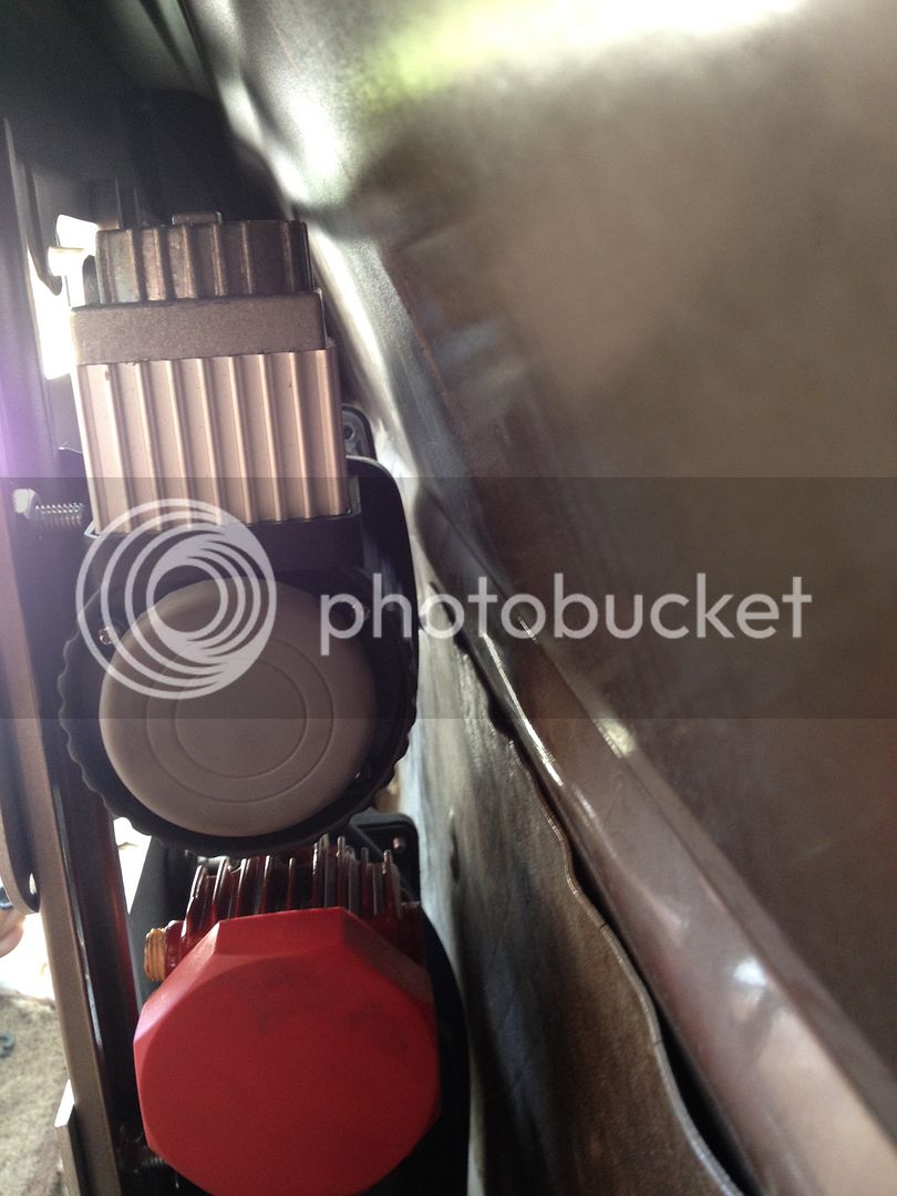

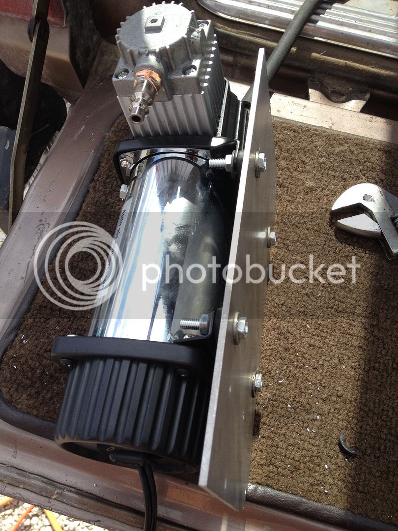

I bought an mV50 compressor, hoping it would be fast enough to air up my 35's. It would air them up, but it took forever.... looked around on the internet and realized they are pretty much the same as the cheap compressors, so I picked up a second one for $40, disassembled both compressors and mounted them both in my rear fender in parallel. I am very pleased with the performance. I ported the MV50, but the cheapo was built slightly differently and didn't require porting.

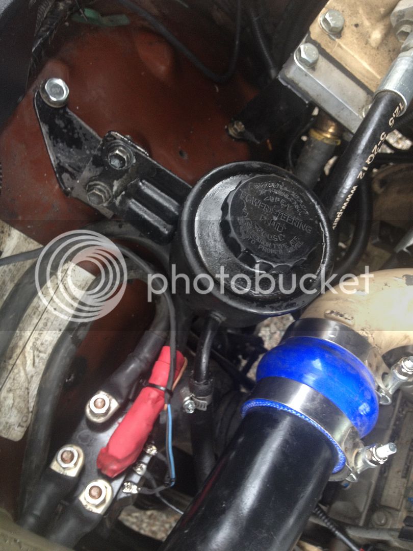

Re mounted my power steering reservoir on the fender. In it's prior location it was getting the piss shaken out of it...
I like the compressor mount. I've thought of that area but had not thought of the bracket. Looks good.
thank you, i sat in the back of the truck with both compressors in pieces for a while until I thought of a way to make them work. I had the aluminum pieces sitting around already and it all just worked out!
