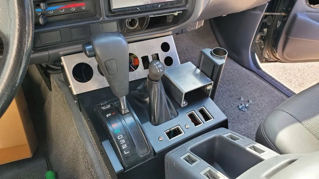

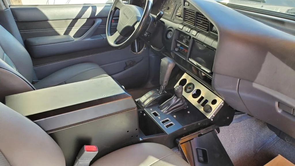

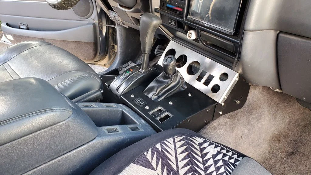

Here are some almost finished pics. Can see the shifter console mounted with both the stock center console and our center console. After getting all these aluminum parts mounted up, starting to think they'd look A LOT better in black anodizing. We have pretty easy access to that here so considering it.
Don't think any pictures of this accessory have made it out yet, but aluminum bracket for mounting either the the laptop style or ipad style RAM do-hickey:
WAW 😍😍
So is the shifter console available separately and does it have a hole in the front like the factory piece? I already have a tuffy console but it leaves the hole in the stock shifter setup exposed and I haven't figured out a good way to cover it yet. This look like a really nice setup.
Like most of our products, it’s what I would call “stock replacement”. The shifter console and center console will be available separately and work with the stock ones just fine. Please see the last pics I posted for examples.
OK, I had to really zoom in to see the hole

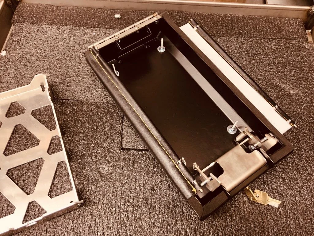

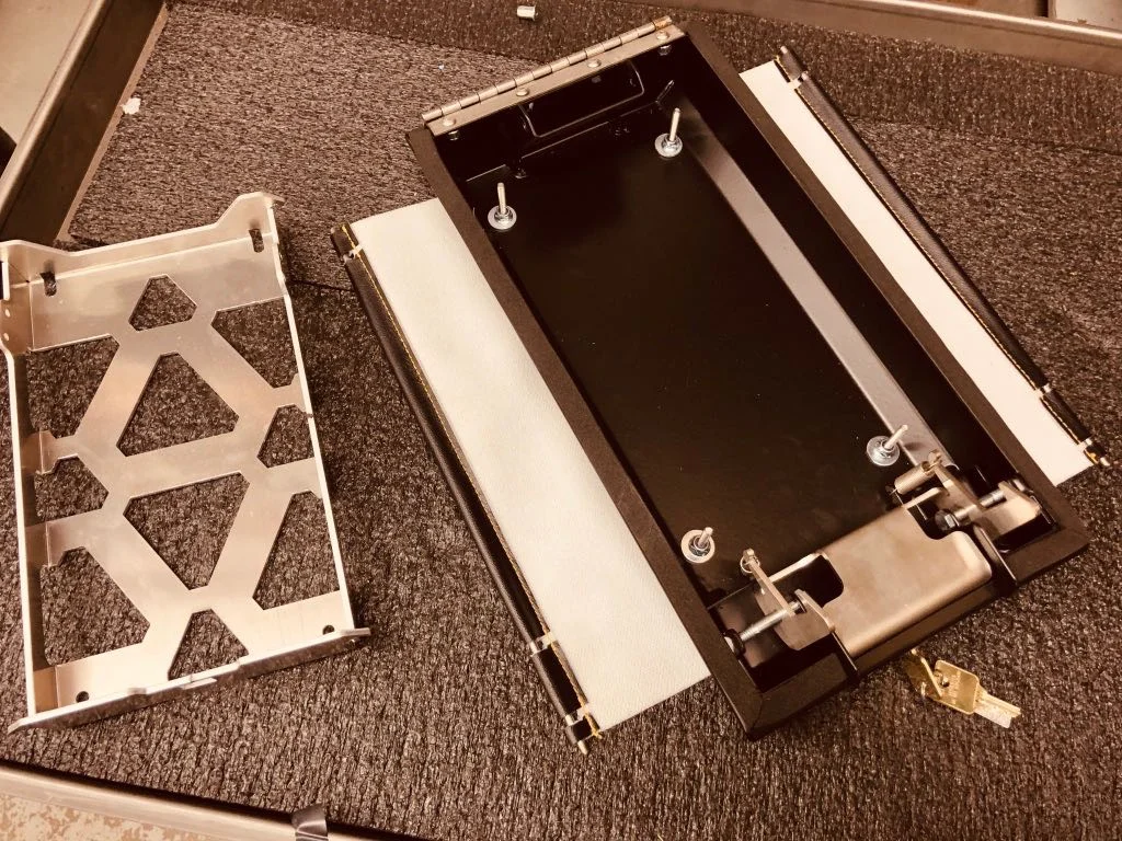

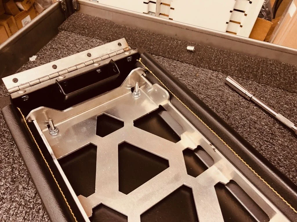

Test fitting the covers. Set up so they are adjustable/tightenable and have room for padding.

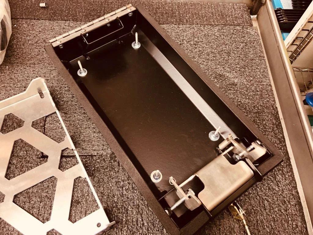

The system works like so:
Basic version will come with these bolts pre-installed (they are flush on the top, no concern there)
If you decide you want the cover either at time of purchase or later on down the road, it will come with the aluminum insert on the left. That insert can be used by itself (to allow the use of the fold down tray), and/or to hold the cover in place and snug it down.
Below is the #pleather option (less expensive), the piece in the photo is just the prototype that doesn't have the ends hemmed, the final will be hemmed all the way around.
If you go with the cover at time of purchase, we will assemble, if you purchase the cover at a later date, we obviously won't be installing it for you.

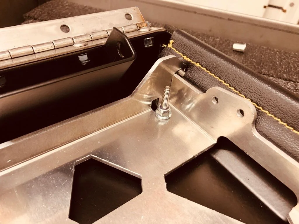

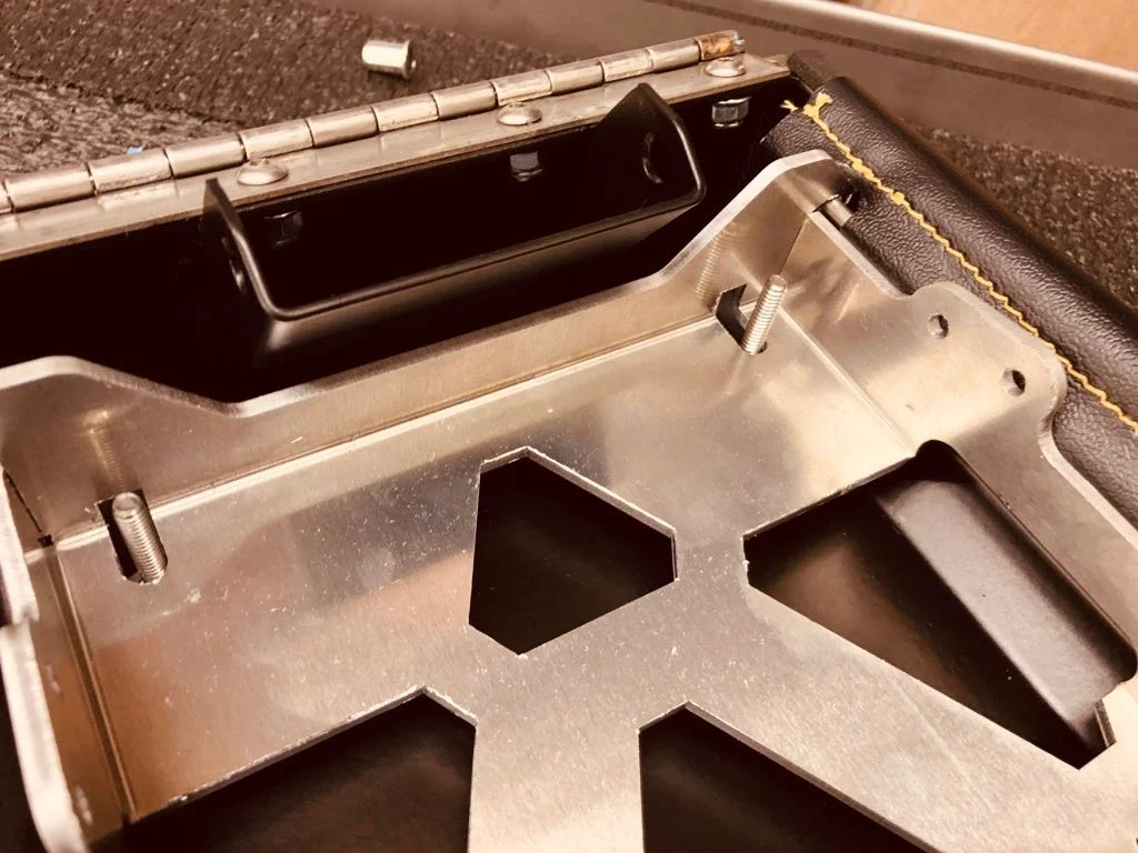

Below you can see how the aluminum insert grabs the stainless rods on the edges of the cover. You can also see the large amount of threads to accommodate some padding between lid and cover.

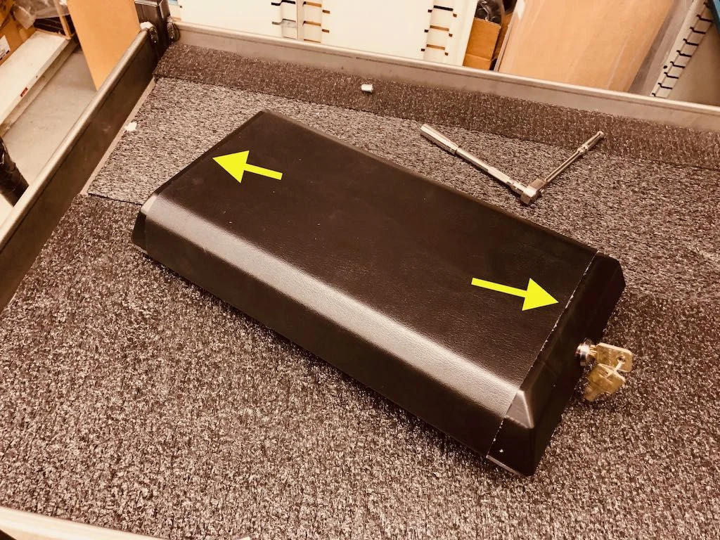

Here it is all tightened down with nice tension on the cover:
Next post will have leather and top view!
Wide view of the installed cover:
These two edges will be hemmed on final versions, as mentioned in previous post:

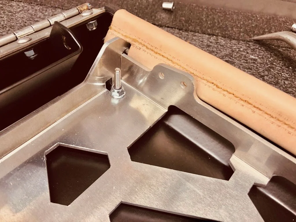

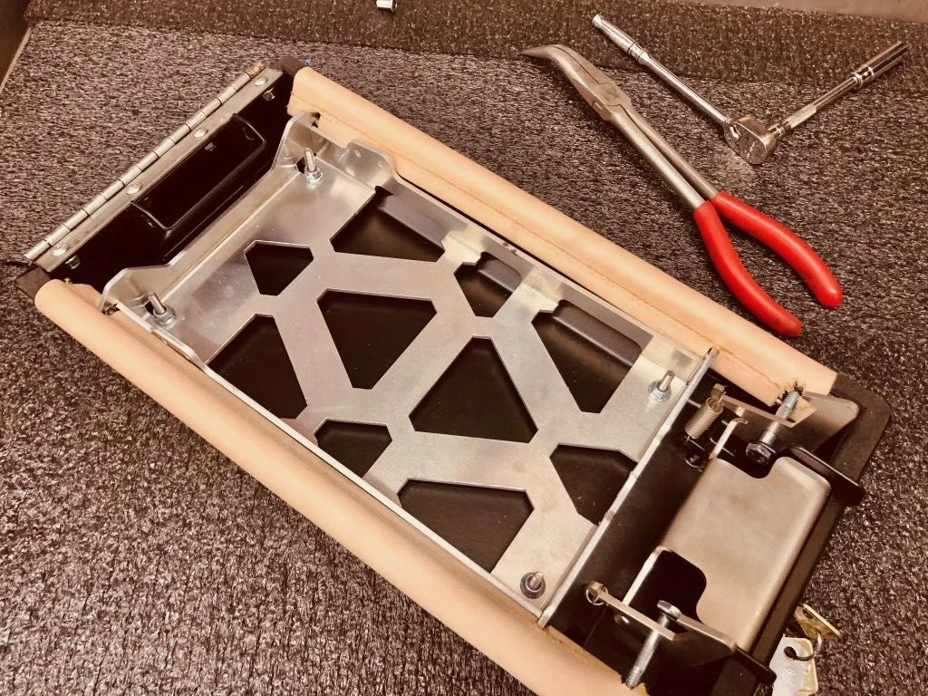

Same process for the real leather version (more expensive option):
Again, same idea for attaching:
