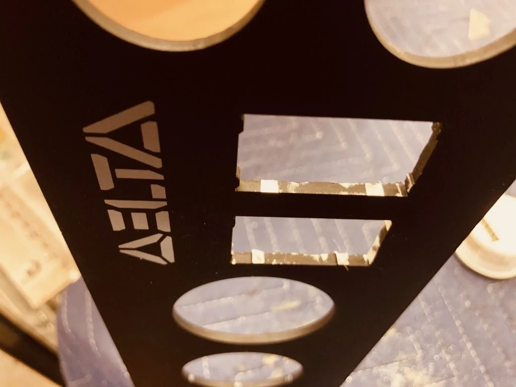

Anodized gauge plates are back, looking quite good. The "file to fit" switch holes work well, with the Type III hard anodizing coming off with 1 or 2 swipes of a file and then it's nice and smooth to get the nubs off and make room for your style of switch.
Here you can kind of see the BlueSea relay switch doesn't quite fit, just needs 2 of the top or bottom nubs filed off:

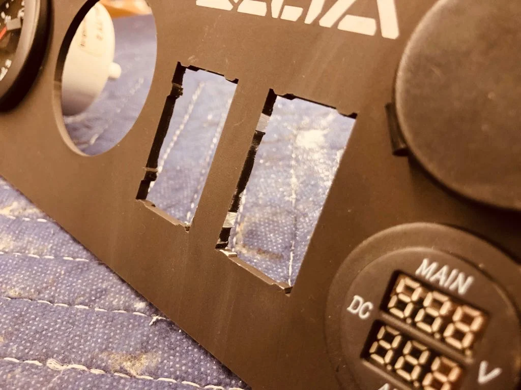

Filing the 2 side nubs off the other hole makes it so the Mictuning dual voltmeter fits nice and snug:
A couple swipes of the file on the side of the BlueSea switch for perfectly snug fit too:

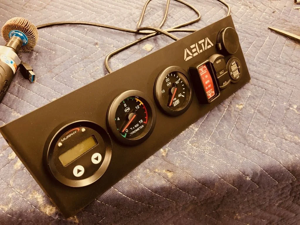

This one is getting installed in our client build with the Cummins 2.8L, so it needs the Murphy Gauge, boost, and pyro. The top, round insert on the far right is the dual USB3 outlet that goes directly back to the head unit for the CarPlay setup. The lower right one is just filling a hole. Will get either a dual USB charge outlet or just a regular 12V outlet for random accessories:

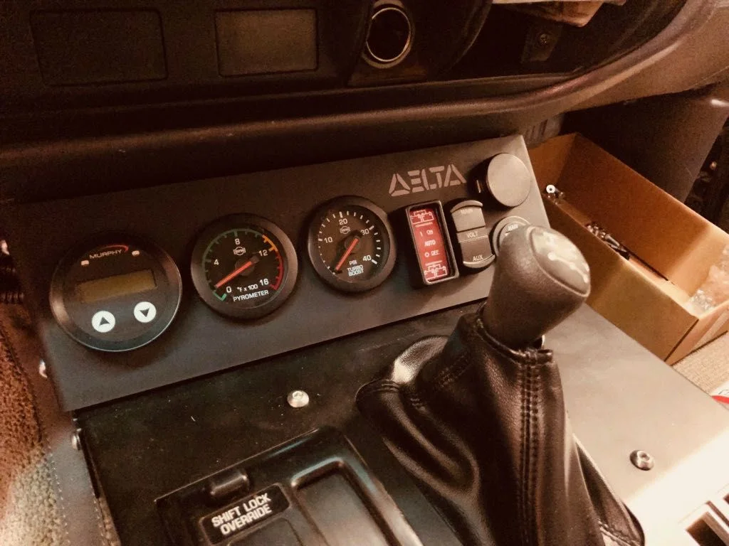

And here she is installed. Type III hard anodizing with laser etched logo since this particular anodizing shop does firearm related things all day, every day, so we will be able to get parts in and out quickly. Once it's all set up the way it's going to live, just have to plug everything in on the backside!
