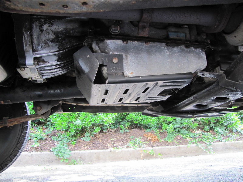

How much rust is on the underside of that cruiser? If those bolts on the suspension are all rusty they are going to be a real pain to get off:doh:...
There's not that much rust underneath, so I'm hoping that it won't take most of a day to fool around with those shackles getting them off.

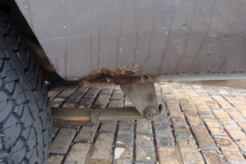

The last pic shows the worst of the rust on the cruiser, but thats on the body. the shackles look to be in fair shape and after thinking about i may re use those to save a little more cash. If thats a good idea?
How are the nuts on the bottom of the U bolts...don't forget to soak those with some PB Blaster too
the nuts look pretty good. ill make sure to spray them as well though.
i need to go clean all the nice GA red clay off the underside today. i just got back from a "hand cleaning" car wash and i can hardly tell they even got the truck wet.
Thats what i get for being lazy.
Extending Nick's question ... How many rocks have the u-bolts/nuts been drug over? If they have have taken a pounding and you are planning on new u-bolts, a cut off wheel might be a good tool to plan for.
It looks like a fairly clean truck on the underside, so bolt rust may not be a major issue. The spring bushings can always be wild card. The shackles are aftermarket, so those have been disassembled/reassembled after the 60 rolled out of the factory. This leaves pivot hanger bushings as an unknown (possible original with some rust/seizing around the pin).

The previous owner, I believe, was the one who had the extended shackles installed. He didn't go wheeling often, and never did the crazy stuff. Mostly just dirt roads, so hopefully they will be alright to re use. The IM shackles look excellently made, but are expensive.
