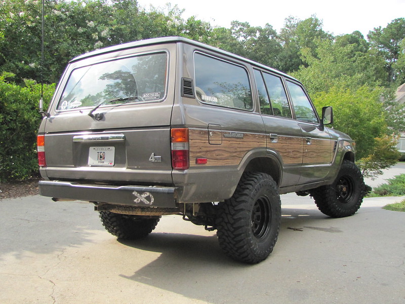

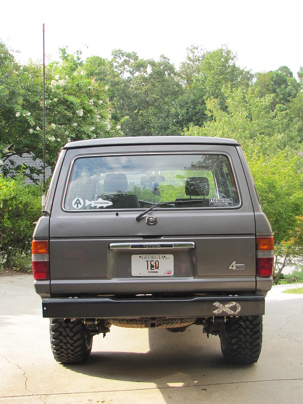

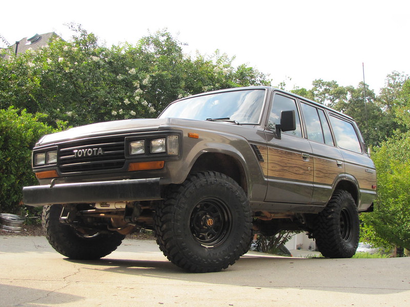

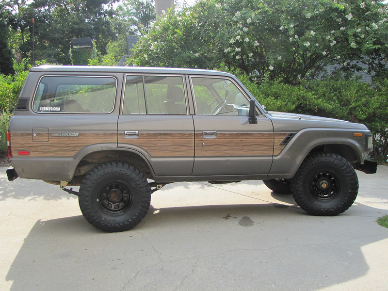

What size tires do you have? How big of a lift did you put on?
31s in the last picture, about to move up to 33/10.5 BFG ATs in the next couple weeks. and the lift was about 2"-3".
3" increase in the rear
1" decrease in the front :bang::bang::bang:
That is pretty weird. The 73 I just did came out perfectly even.
The arch in the front springs in this pic does not look as arched as the rears.
Did you Google the part numbers painted on the springs to ensure they are the right ones? Since you got all the springs and shackles at the same time I can imagine no reason why that truck would not be sitting level. You may wanna check on that.
Yep I checked out the part numbers on the camel 4x4 and ironman website. They were correct. I made sure of that because there was a slight mix up with my order and I wanted to make sure EVERYTHING else was correct... (they sent me 2 fj40 grease able pins and 2 fj62 grease able pins)
Ill check again tomorrow just to make sure, but this morning I finally put the extended shackles back on in the front, so know it's riding almost level. It's only about 1" difference in the front and rear now.
Only major problem now is that since I put the new IM front shackles on, they are used, so I can't really return them, and those things are expensive as hell. I guess I can sell them if someone wants some.
Not as painless an order as I was expecting but at least the truck is looking good and has a more comfortable ride.
