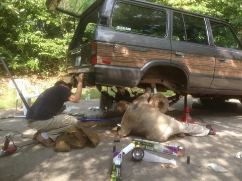

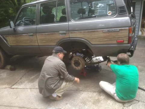

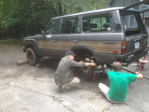

With a ton of help from RJ and his friend Pete, we finished the 2 rear springs today haha. They took a little longer than expected...
We should finish up tomorrow night at this pace so I'll post pictures when she's done, hopefully in the afternoon :)

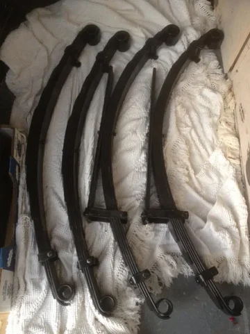

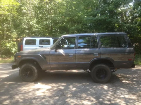

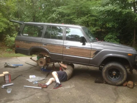

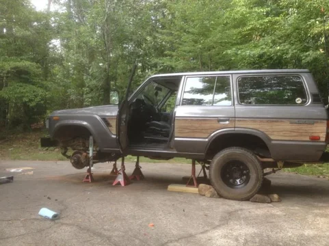

I would bring it but I'm going to change the front shackles again on saturday. Here's some pics..
In the last pic, there's probably 400lbs or rocks, wood, and tools in the rear and it's still sticking WAY up. Hopefully, the older extended shackles in the front will help her level out a little when the rear settles down some.
