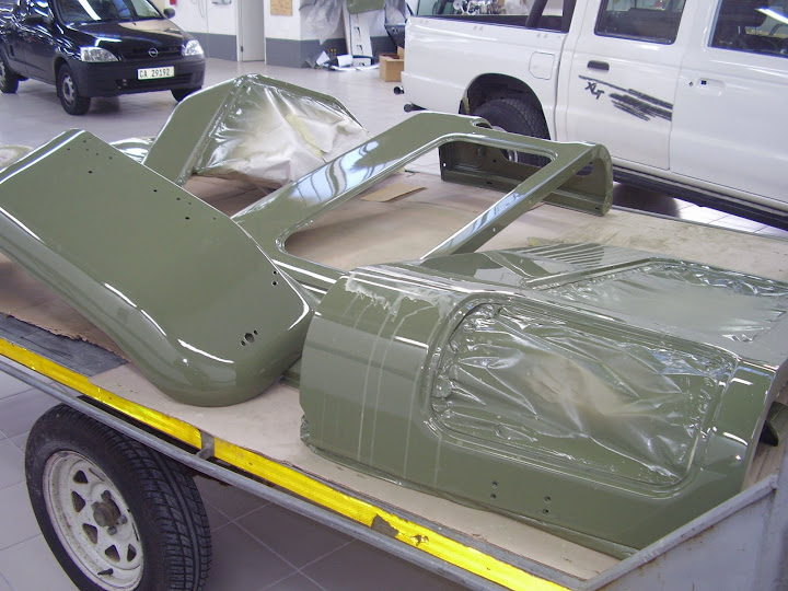

Some panels got their final coats and are ready to be wet-sanded etc ....

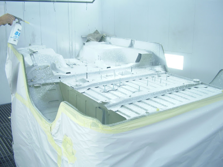

Today Hennie and I started with the Stone-Chip underneath the tub.The plan was to do 2 entire coats ...
The firewall we will do with a conventional gun for a smooth finish ...
Eventually we had to give it up as that stuff takes too long to dry.Now we will head back there in the morning to do the 2nd coat of Stone-Chip.
