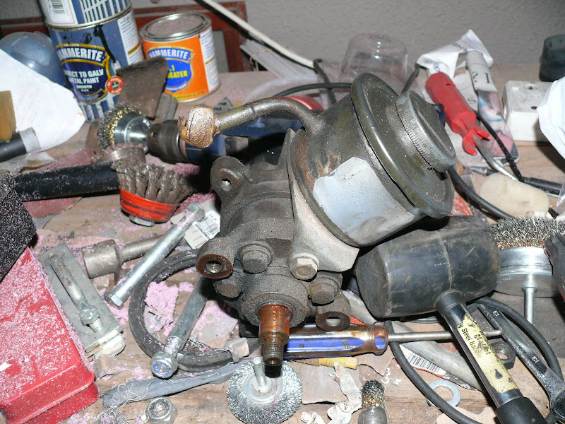

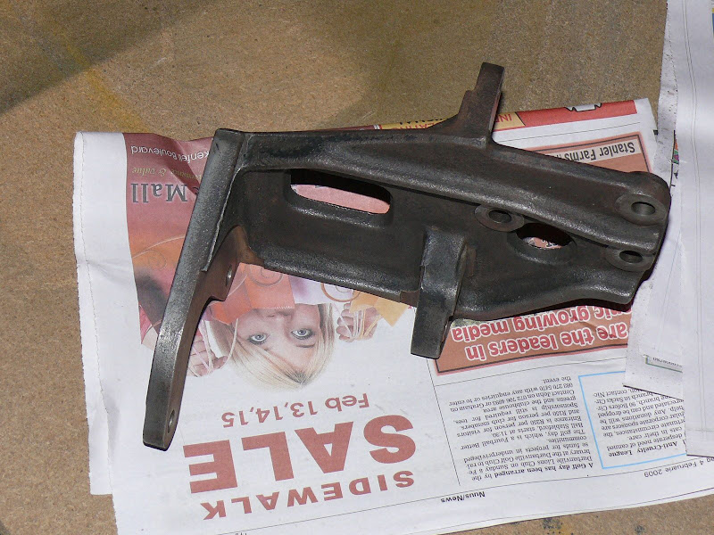

Any chance I could talk you into more pictures of that PS pump, and how it mounts to the bracket? Do you have a part number for it? I suspect it's a 44320-60080, but if you have a part number, it would help a lot. The later trucks used (and the EPC shows) that 44320-60090 superceded it, and I got a 60090. Unfortunately, it doesn't seem to bolt onto my bracket--which looks identical to the bracket you've got there.
Is the PS all original to the truck, or from something else? October '82-November '84 is different from November 84-November '85. My PS stuff came from an unknown truck, as did the engine, so I'm trying to piece it all together....

Sure Dan !
Mine is a 11/83 LX so the P/S is all original AFAIK. I don't have the rolling frame with me at the moment but it should be back in about a week, so if you need more pics etc just shout. In the mean time I hope these help you ....
Your number ?
Dan I just checked all my pics and the closest to a number on the pump I could find is this
It reads C at the top and 3H05711 at the bottom. TOYODIY lists the pump part# for my truck as 44320-60080 but I cannot find a listing for the pumpbracket at all :confused:. Compare the part# on your bracket to mine ?
I won't know for sure until I get back up to the shop, but I do believe you may just be an angel!
I was trying to mount the PS pump too high I think. We'll see if I can't get it to fit that way...
EDIT--you've got the 44443-60040 bracket (it's visible in one of the pics), which means you should have the 44320-60080 pump. The 44320-60080 pump is no longer available. The 44320-60090 pump is still available from Toyota (it's also used on the FJ-62). In about an hour I'll be able to tell you if you can use the early (October 82-November 84) bracket with the later model pump.

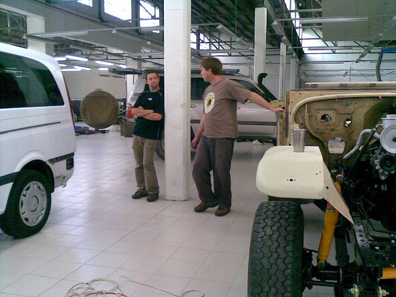

I had a few outstanding odd jobs to do, so yesterday being workers-day, was good for me but I don't work at Auto Magic everyday. What great service again from Gordon.Not only did he open the place for us but even lent us a helping hand and bought us lunch ! :eek: Thanks Gordon, the sacrifices you make for your clients are amazing :cheers:
