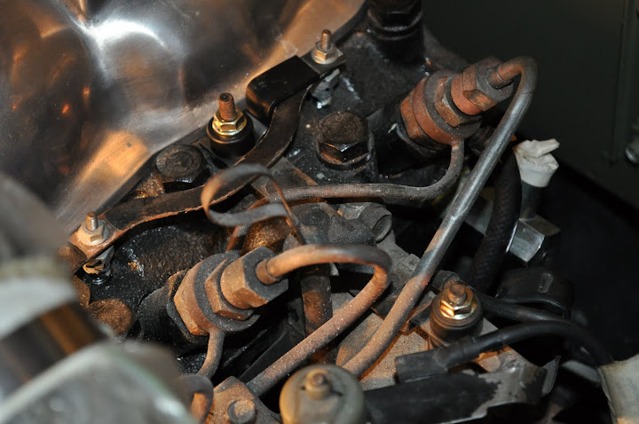

I had a problem with one of the isolators of the glow system and needed to find a part, preferably local.
Luckily JB helped and we found that the OEM 3L(2.8L) motor uses the exact same part as my 3B !
Today I discovered that whoever replaced the ones on my vehicle in Aus, had mixed them up and fitted the wrong one at the bottom, which kinda explains the reason why it was crushed ...
Correct one at the bottom

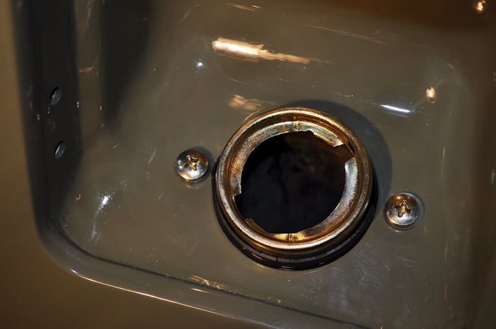

Somehow this breather tank cover just didn't "feel" right but Keith will probably say it was just me being anal gain ..
So I sourced some rubber to round things off a bit ...
I like it. Go ahead and be anal - it's your rig! You're doing a great job putting that thing back to together. Looking forward to seeing it complete and back in action.
