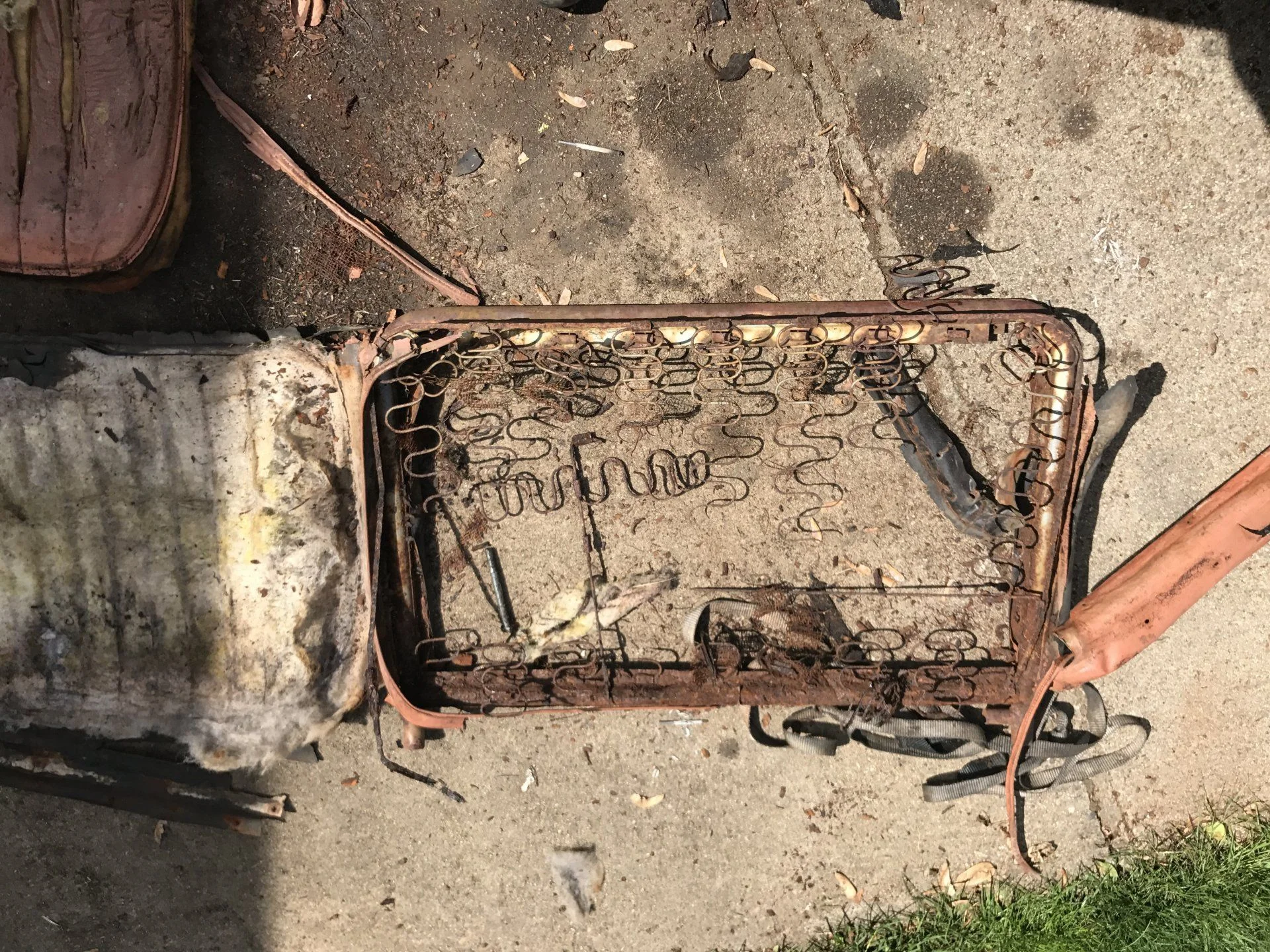

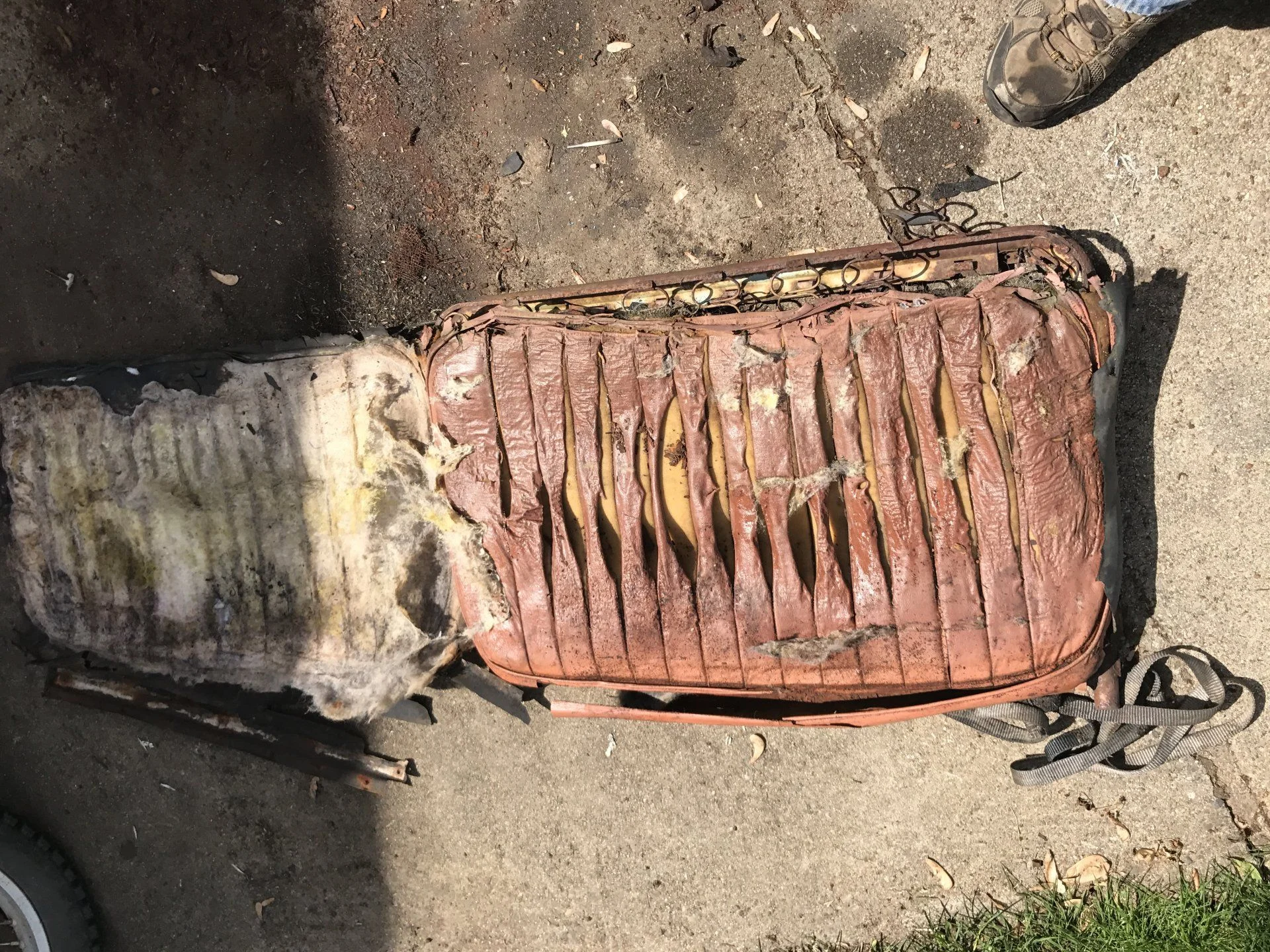

After disassembling the drivers seat I did find a few intact remnants of coral fabric that had been protected from light and weather. The pics I had seen of it on IH8mud and the intenet don't do justice for how bright of a color it is....

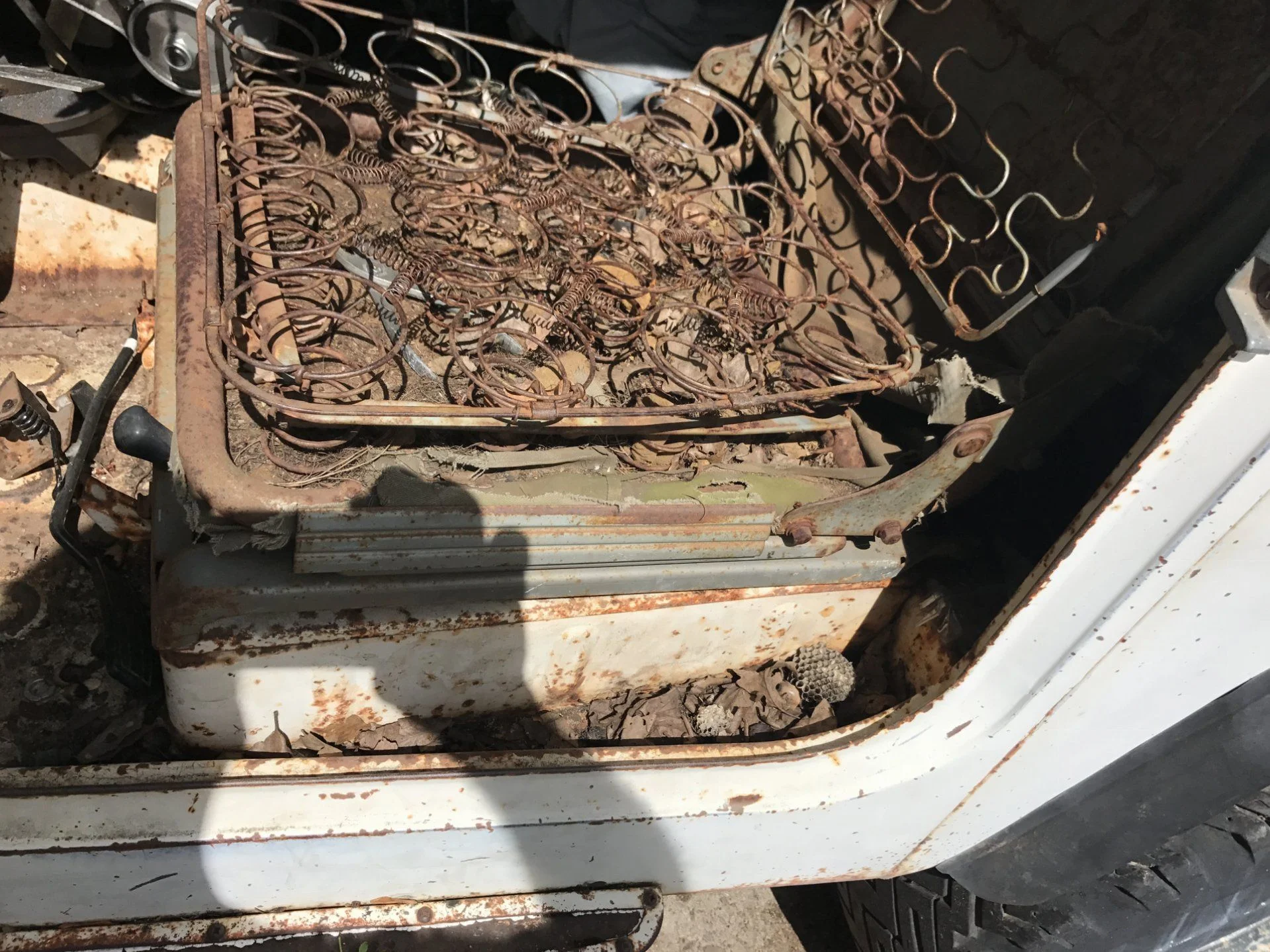

But, all aspirations of redoing these seats disappeared when I disassembled the passenger seat: Although not a matched pair to my drivers side seat that was i the truck when I purchased it, it too had the coral seat cover material. Unfortunately, the fabric was the only thing holding the seat together as all of the springs and structural supports were completely rusted out. Arg.
Did the seats have foam or horse hair for stuffing? My 65 fj40 has horse hair (or some sorta hair ) for stuffing, not sure original or not
I bet that is what it is, would never have thought of that, good and interesting info ;)
Yep something like horsehair is stock. My upholstery guy said it was coconut fiber? Anyway, he replaced it with coconut fiber and it looked the same.
