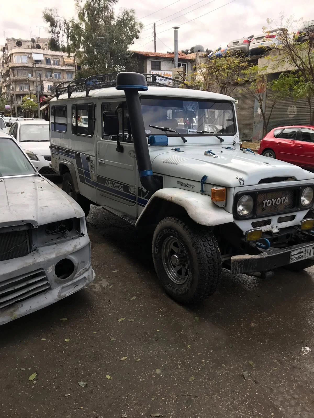

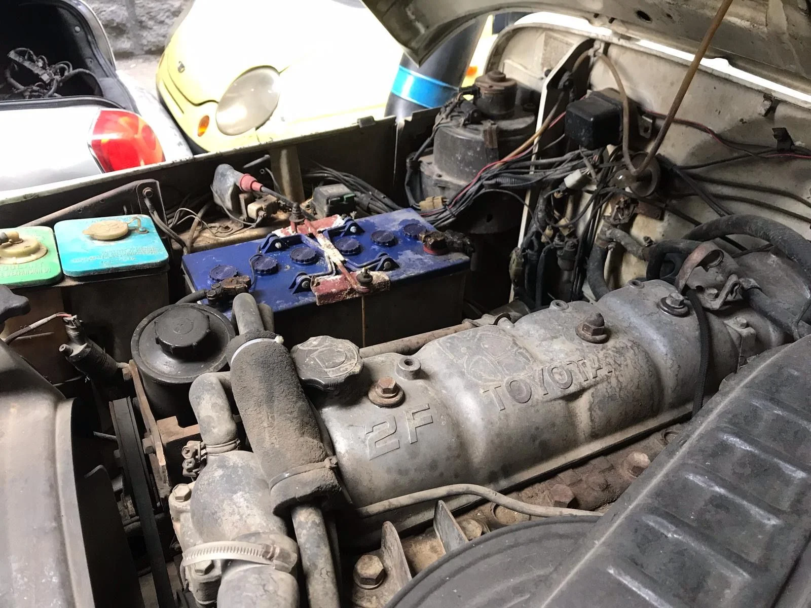

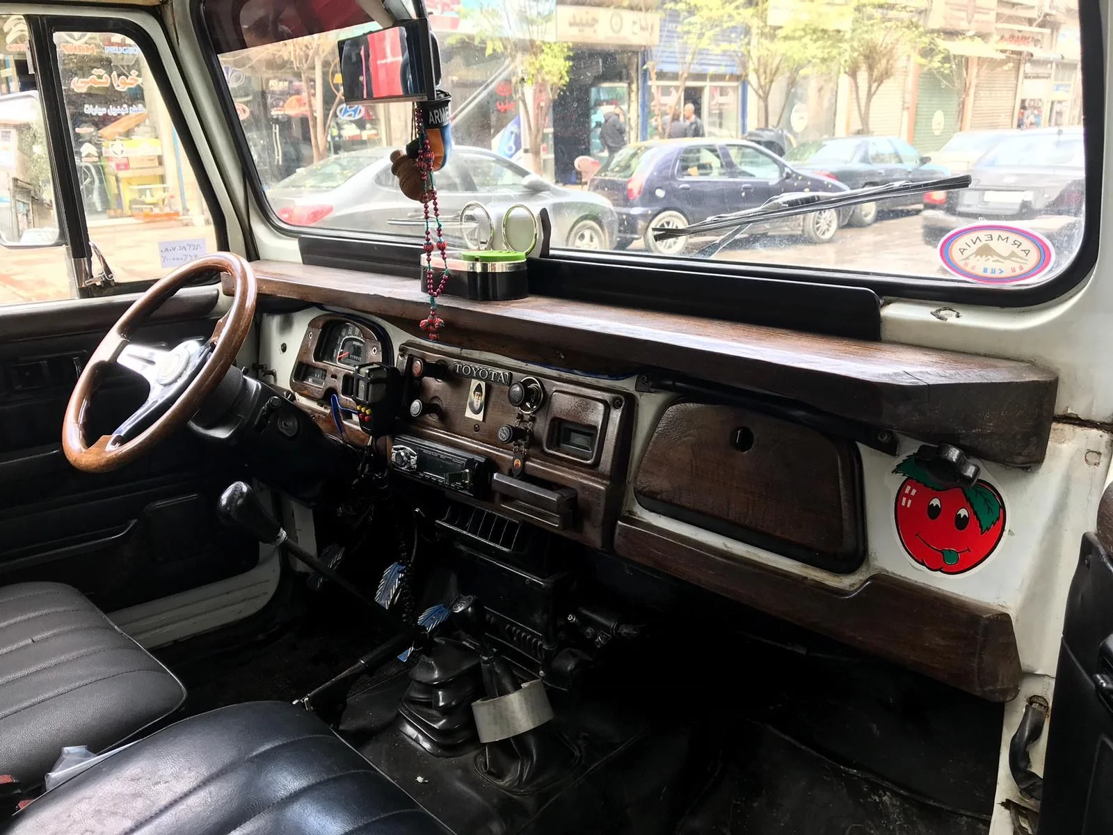

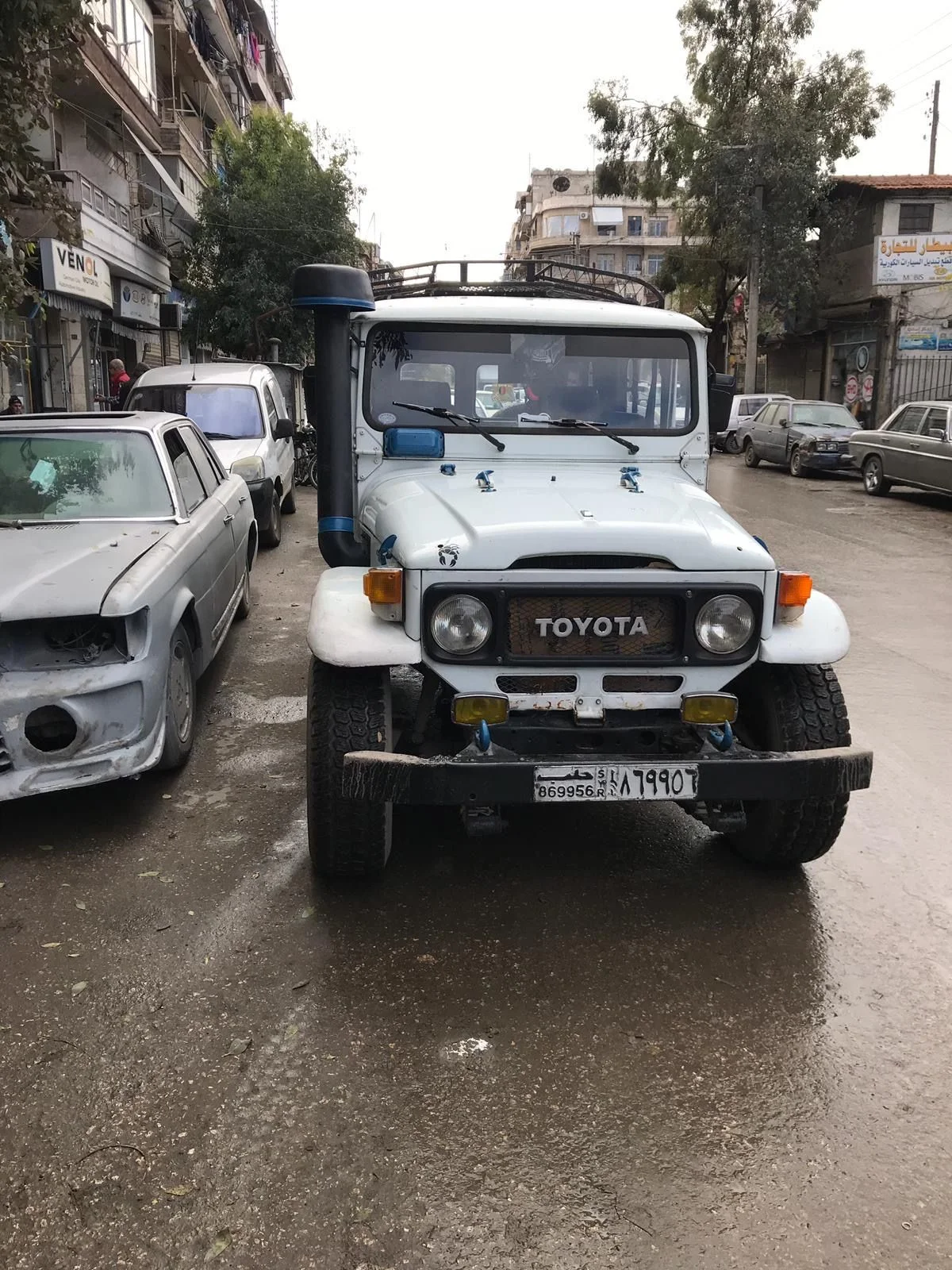

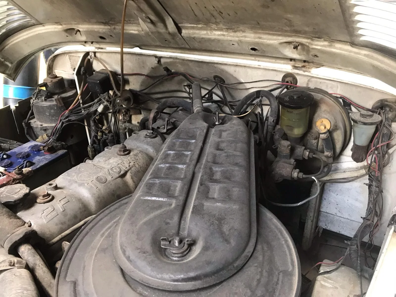

Hey all,
I had decided to fully frame restore my dad's 1982 Toyota Land Cruiser FJ45 Troopy (gasoline 2F engine). I will be getting the car from Aleppo, Syria as it is just sitting there like a duck and getting coated with dust. So I decided to do a project out of it while being in San Diego, and my trusted mechanics and body shop repairs are all there. But before I go ahead with the whole process I wanted to get you guys' opinion. Would I be able to have it registered in CA and drive? or is it better to just have it imported and cleared from the customs and have it for sale in a different state?
I have attached some photos below:

Au contraire. Just get a complete smog setup including the carb, air cleaner, and electronics from an fj60. Unfortunately you may have to do some tricky work on the harness, but it's possible.
If that head is not drilled for the air injection, you need that too. :crybaby:
It doesn't matter if it comes from out of the country, or out of state, you need all this stuff.
I hate to say it, but an LS swap might be less work.
I don't think titling it in another state and bringing it into Calif will get you around any of Calif's smog regulations.
it may be easier to swap in a good engine and all bits from an FJ60 to pass in CA versus trying to convert yours to pass

1 question Sir , can u elaborate on the Red Pull Knob on upper LH of your dash
please , is that your choke ?
does it light up with a small bulb and glow ?
thanks for your time
i love the stripes and SAUDI-SPEC. Graphics package as well
good luck !
matt
""I had decided to fully frame restore my dad's 1982 Toyota Land Cruiser FJ45 Troopy (gasoline 2F engine).""
Looking at your pictures, what needs to be (urgently) restored ???
