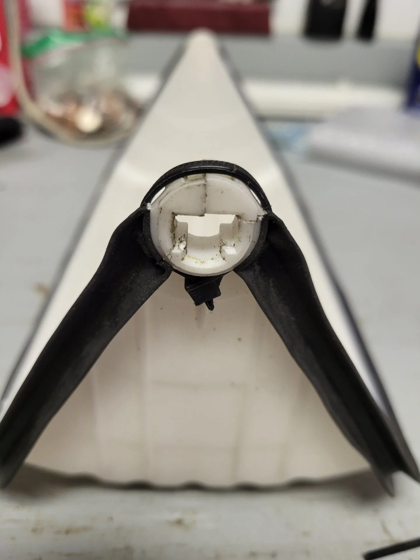

My current status, flap is out.
Now have to figure out what to do next
I did a reversible fix with a wire tie, that way if I get pissed enough to make the dealer do it under warranty I can just take it off with no evidence of me fixing.
Dont know how to attach a video of it working, but Thar she blows.....

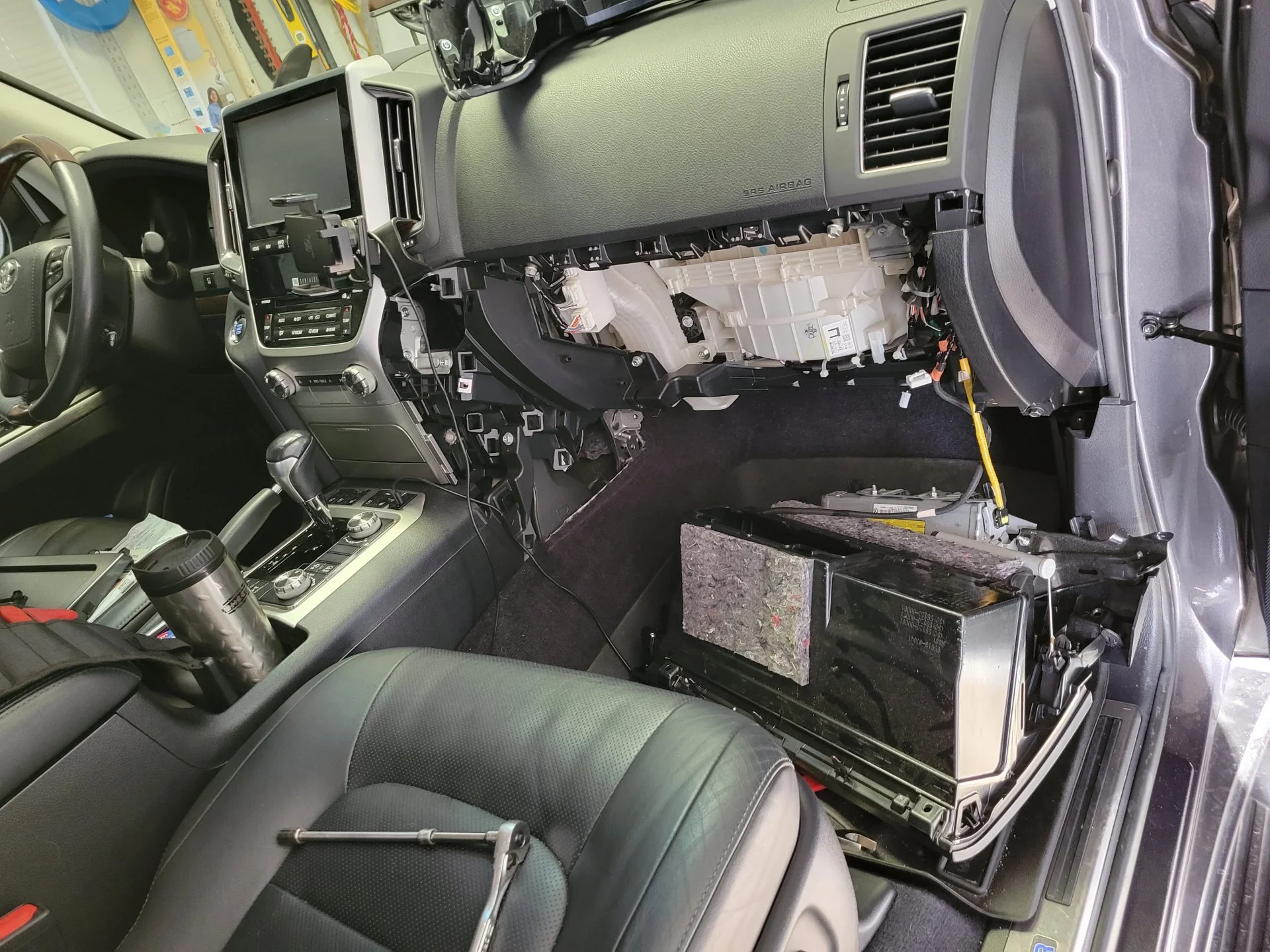

Great job….how much of the dash did you take apart?
Glove box, air bag, center console pass side trim,fake wood trim above glove box, and panel above foot well. Really wasn't bad, getting the flap out took some patience and work. Putting flap back in was easy. Im.pretty psyched. Didn't use any glue or anything, but I can't see how it can fail.
That looks secure. If it comes apart, just redo that with appropriate glue. Don’t let a dealer take your dash apart. You’ll end up even more pissed.
I could not find that missing chunk anywhere in mine so rigidly braced the larger cracked part, and it has been working fine for a couple years now.
I’ll see if I can dig up some pictures.
Took me a while and a mechanics pick to find it. Was at the front center lodged down in an indentation, in case you ever have to look again.
Good info, I'll give it a better look next time I get in there.
The piece out of mine was the same and it was in the right front filter housing trough just under where the filter sits. It’s a deep trough and the plastic is the same color so it’s easy to miss. I eased it out with angle tweezers.

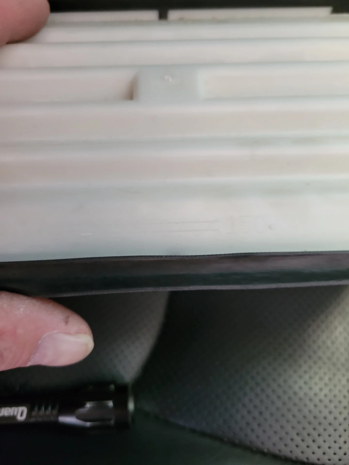

Recently had my 09 serviced (unrelated to this but they did check the cabin air filter). I noticed something was wrong when my HVAC temp setting wasn't "saving" and it took about 30 seconds for it to come on after starting the car (sometimes it just didn't come on automatically and I had to turn it on).
Checked the filter and sure enough the flap was flopped down and loose, and the dash switch wouldn't move the flap. Nothing looked broken to me on the hinges. In the course of fiddling with it, it just sort of started working again. Including remembering the HVAC setting and starting immediately with the car.
However, now:
  1. The flap doesn't close all the way.
  2. If I start the car in the fresh air mode, it goes to a sort of middle position. Is this the intended functionality?

The flap is operated by a shaft on the USDM passenger side of the opening. With flap open (once again, do not open by hand. Use the recirculation button on dash) remove the air filter element. Once removed, you'll be able to see where the shaft slots into the flap assembly.
I'll hazard that it is cracked but still held together by the rubber gasket around the edge of the flap.
