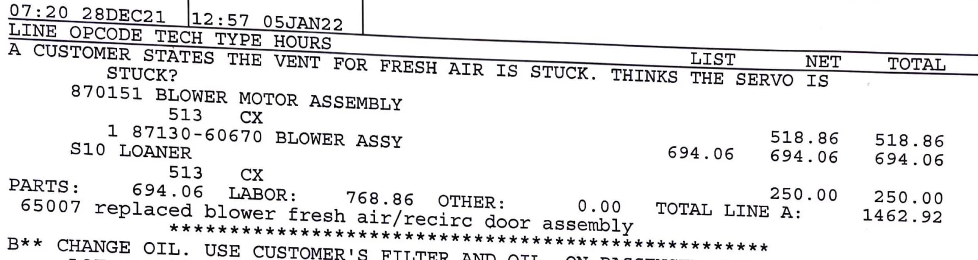

The service advisor said that they were sending the dead blower motor assembly (87130-60670) back to Toyota, so I couldn't have it. I didn't get any photos of the broken one, so no way to know for sure what was causing the problem with mine. I may try to meet the shop foreman next time I'm there to thank him, and to see if he has anything to report.
I've attached a snip from the invoice below - for the blower motor assembly it was $694 for the part, $519 for labor, and some kind of $250 charge for "loaner". The invoice doesn't say anything about "warranty", but at the bottom there's a "discount" for $1,462.92, so my net cost was $24 for the oil change (again using my oil and filter). Maybe that's how their software deals with the initial CPO warranty claim, and then they fight with Toyota to get corporate to give the dealership (notably not the selling dealership) a credit? Anyway, not my problem.
I did get an automated text message from the dealership with a link to an invoice showing a $42 "rental charge" for their POS Corolla service loaner car. No hit to my credit card for that $42 so far, but I'll be disputing that if it does come through.

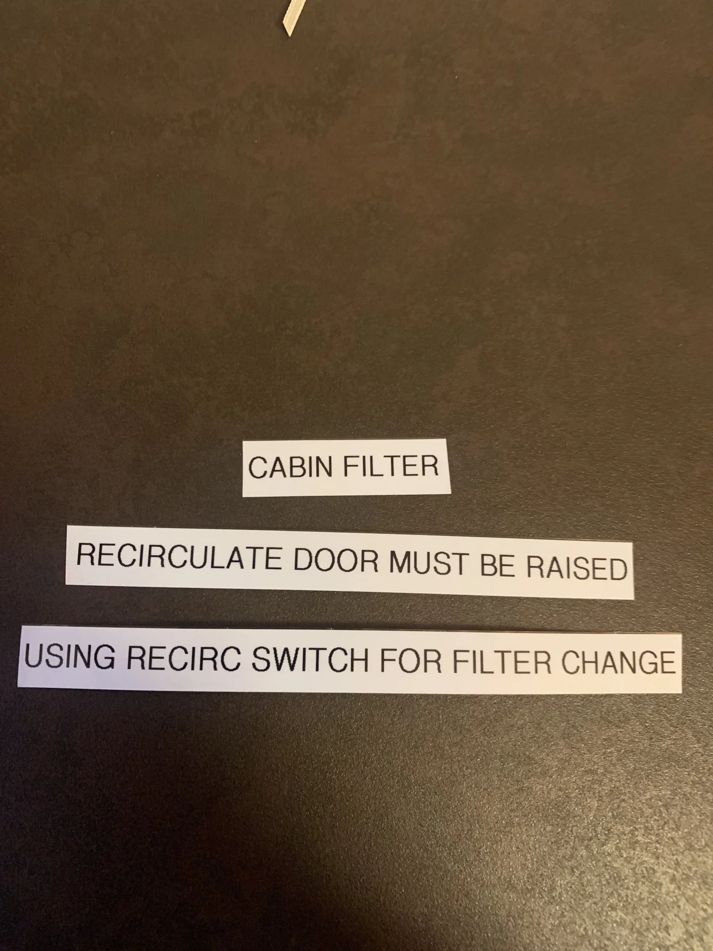

Thanks for the heads up on this. I just checked mine and luckily it's operating properly. But I am going to attach a label I just made with my P-Touch.
They'll take a swig of their monster energy and barge right through that. Good reminder for you though.
The ONLY way to be sure things don't get broken is to lock the glove box and keep the key blade with you. This needs to be a PSA or something every user of this section sees.
