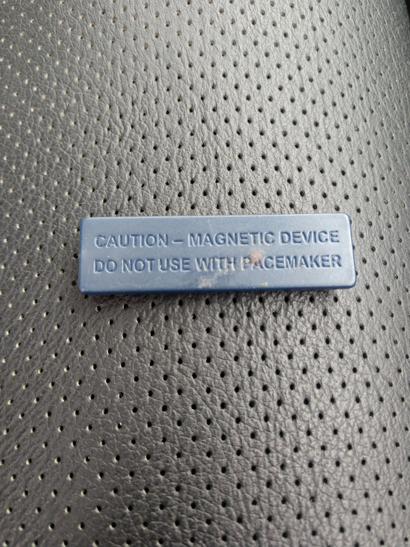

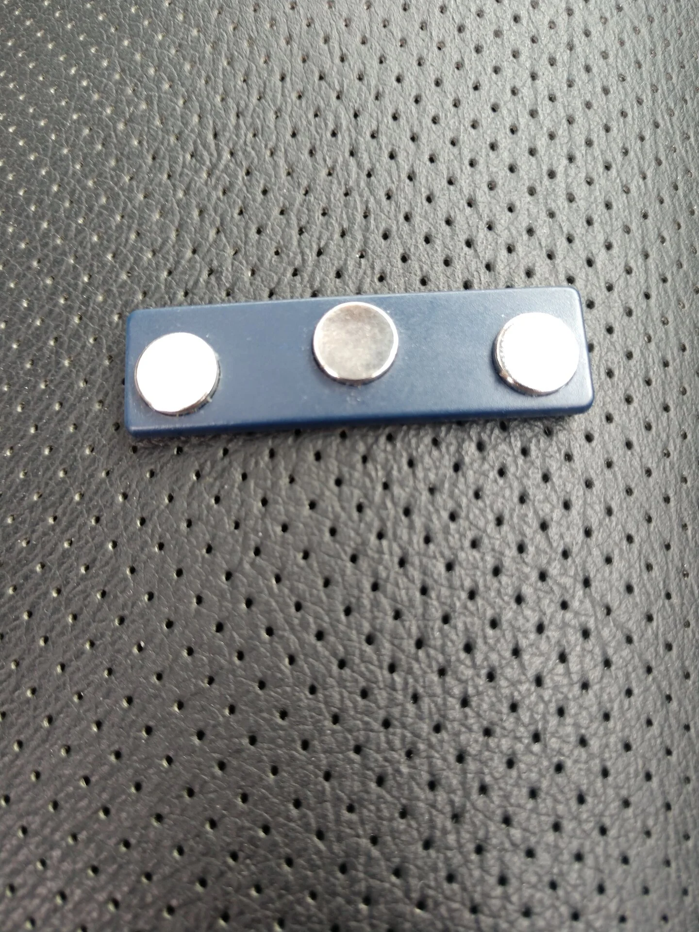

On another note, when messing around with the access door on the vehicle that has an inoperable unit, this little piece fell out.
It doesn't look like it belongs to the vehicle?

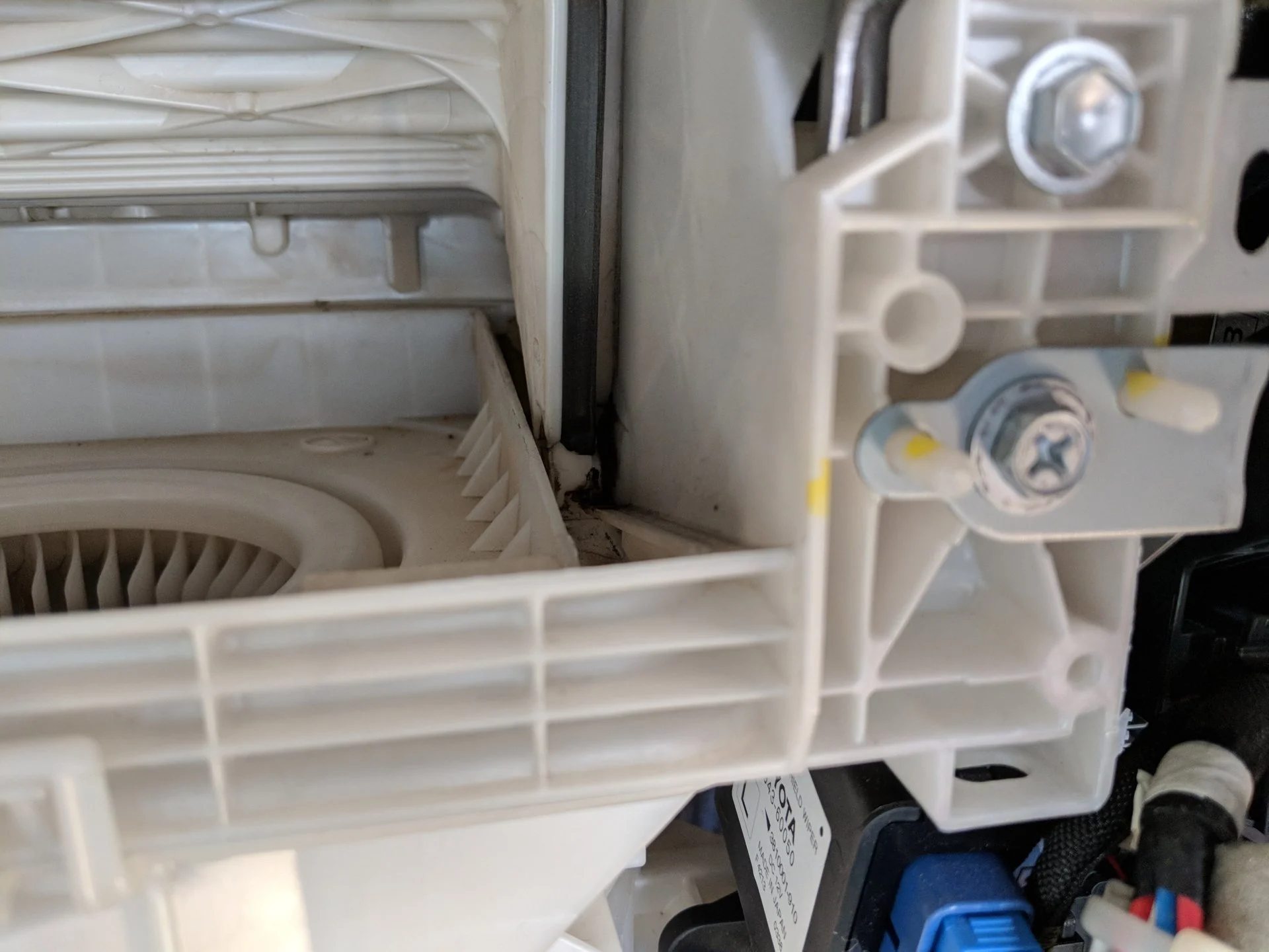

Can you describe where in the photo, or if you have the capability to draw an arrow to or circle around the break area, and repost it, that would help me as I am missing it.
Right in the middle of the photo is the vertical foam seal for the door when in the fresh position. If you look closely right at the bottom of that seal, you can see the broken plastic on the door arm. When that breaks the shaft from the motor turns freely and does not move the door.
Look at post #222, it was mine and shows where it breaks.
