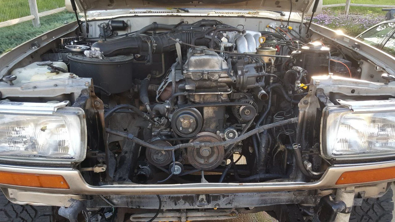

Well, it was supposed to be a rainy day and we are just hanging out waiting on the wife to start the "calving" process. Turned out to be a beautiful day and I hopped outside to spill some oil on the driveway. Got the radiator stripped. So while I've spent most the money, I'm officially committed to this. You think my neighbor who post-divorce still has a 5000 sq ft house, tennis court, pool and separate garage to house his porsche turbo is going to hate looking at my project every day? His DD is a 200 series, so I'm sure he "gets it...." :hillbilly:
Looking at getting a new rad, my current one is pretty torn up. And as powderpig noted when I was thinking about rebuilding my 1fzfe, green got mixed with red.
