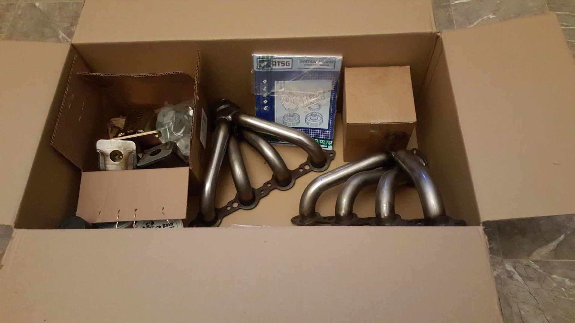

First shipment has come in. Still 3-4 weeks for the motor to show up along with the adapter kit from Mark's. Our exchange rate to the aussie dollar rules right now. (Hat tip UTkruzer )
I got the summit headers opposed to the already painted Hooker headers. $40 cheaper and that is after buying the can of vht flameproof spray paint. It was a blistery 60 degs in denver today, so ill have to find another nice day to get the headers painted.

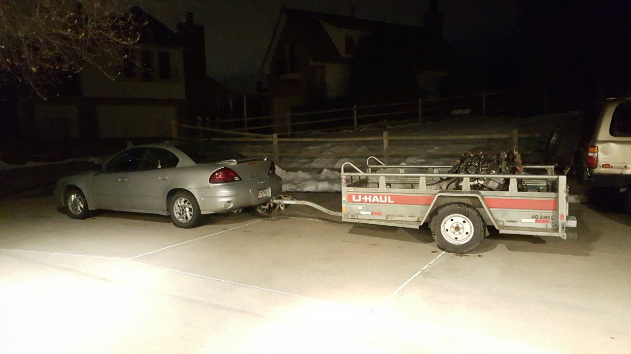

Well, my date finally showed up for the ball. No judging on my tow vehicle....
Hell I'll be using a dodge neon to do the same thing...

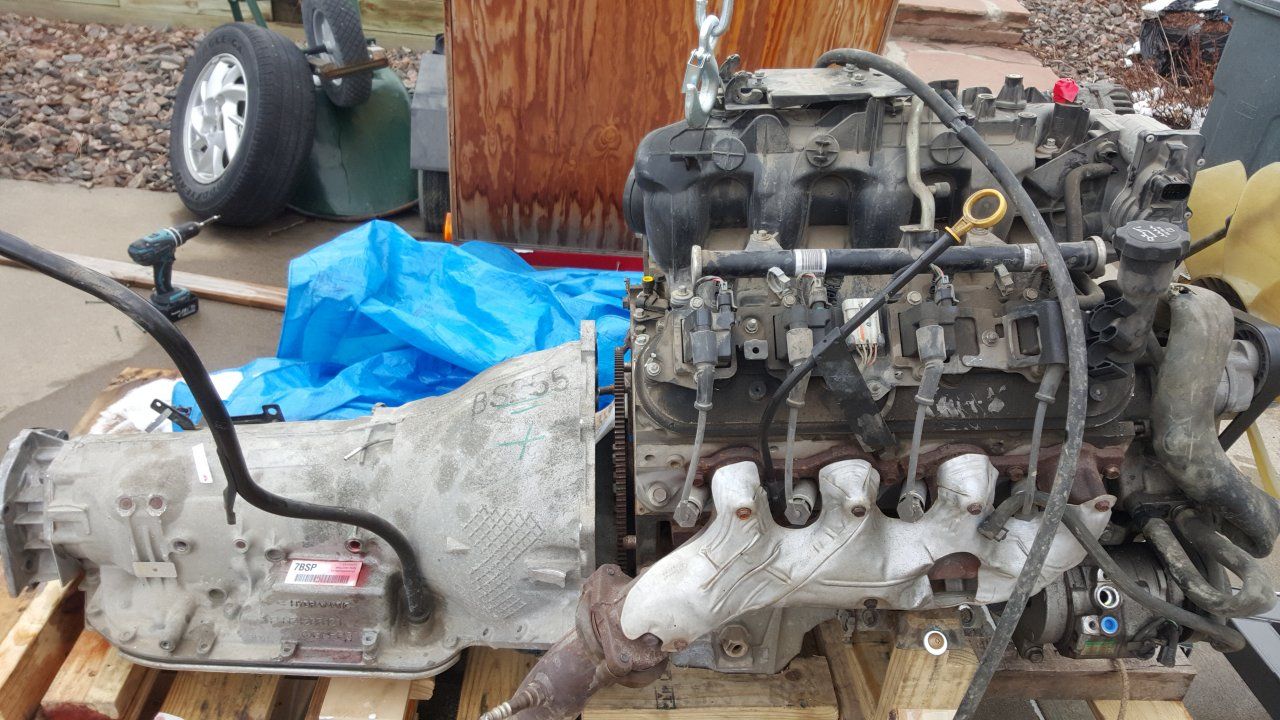

Got a few things done tonight before it started snowing. Stripped the harness off. Split the tranny from the motor. And got the tranny all tore down. It looks to actually be in fantastic shape. I'm not seeing clutch material anywhere in the oil, no wear on any of the components. I kind of wonder if the tranny has been re-built, I did remove a plate that said "transgo" and the valve gasket looks to be new and not 11 years and 90k miles old??? One thing that has me concerned is the carrier assembly has some damage on it? In my 3rd picture, bottom and to the right, you can see 2 chipped grooves? Something I need to worry about?
Reality did hit me, I might be in over my head...I've got to make some decisions, but I'll slip the reluctor ring on tomorrow and refurb most of the tranny. I might skip the 4th clutch assembly...
The chipped grooves don't look like much to worry about to me, but I'm just a shade tree mechanic. I would say if you didn't find the pieces inside the tranny than it might have been rebuilt like you thought, and that the pieces were damaged during rebuild or prior to the rebuild... Everything looks pretty solid in the pictures to me... My donor vehicle will be here on Sunday... Woo Ho I can't wait to start tearing into it!!
Dang, most of us are afraid to go inside a tranny and here you guys are diving right in and rebuilding them, wow!!!
If you have ever rebuilt a motor you have the skills and knowledge to do a tranny... Might just need a few special tools and a service manual for said tranny. IMHO an auto trains is simpler than a motor build, UNTIL you get to the valve body... That's where it can get difficult...
