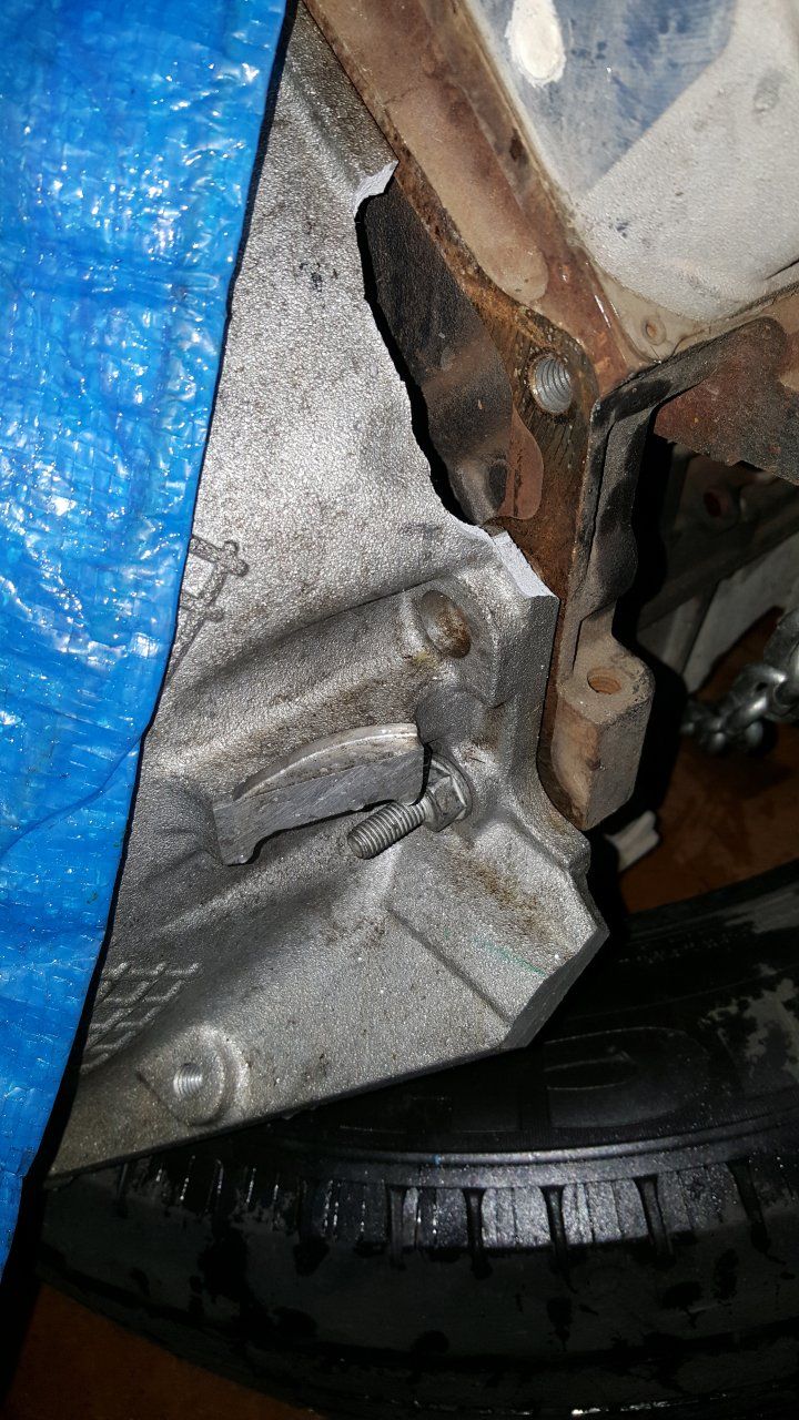

4l80e bell housing is integrated into the case. I'm going to bolt it up and get my motor in the vehicle hopefully tonight. I'd like to see how everything fits so I can order radiator and few other things. I'll then pull the motor again. I'll look to see how much for a welder to come hit the motor mounts and the transmission at the same time. I was going to do the motor mounts myself, but if I have to pay a guy to come by anyway and they're already tacked on, might as well have some who actually knows what they are doing TIG weld them for hopefully a few extra bucks.

you need that bolt hole coz the next hole up isn't tapped on the vortec blocks there's an oil gallery or something behind it

True on next bolt hole up on bell housing isn't tapped, but not sure that means I have to have the broken ear fixed. I think it is a good idea and I plan to do it though.
@lazy wish you was closer I could burn it in if you were...
Thanks. I got a guy who lives a couple miles up the road who is going to come by and weld it. I figure I could take it slow with my mig welder, but for $85 I'll knock out both the case and the motor mounts.
