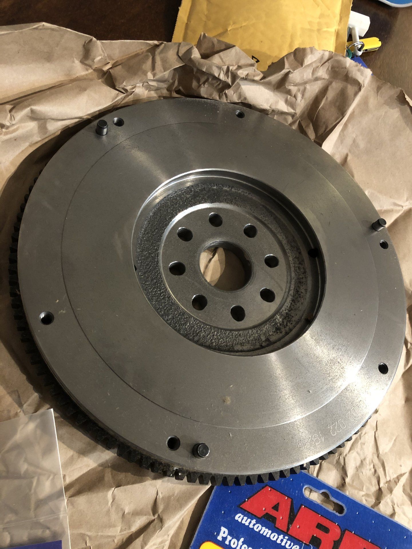

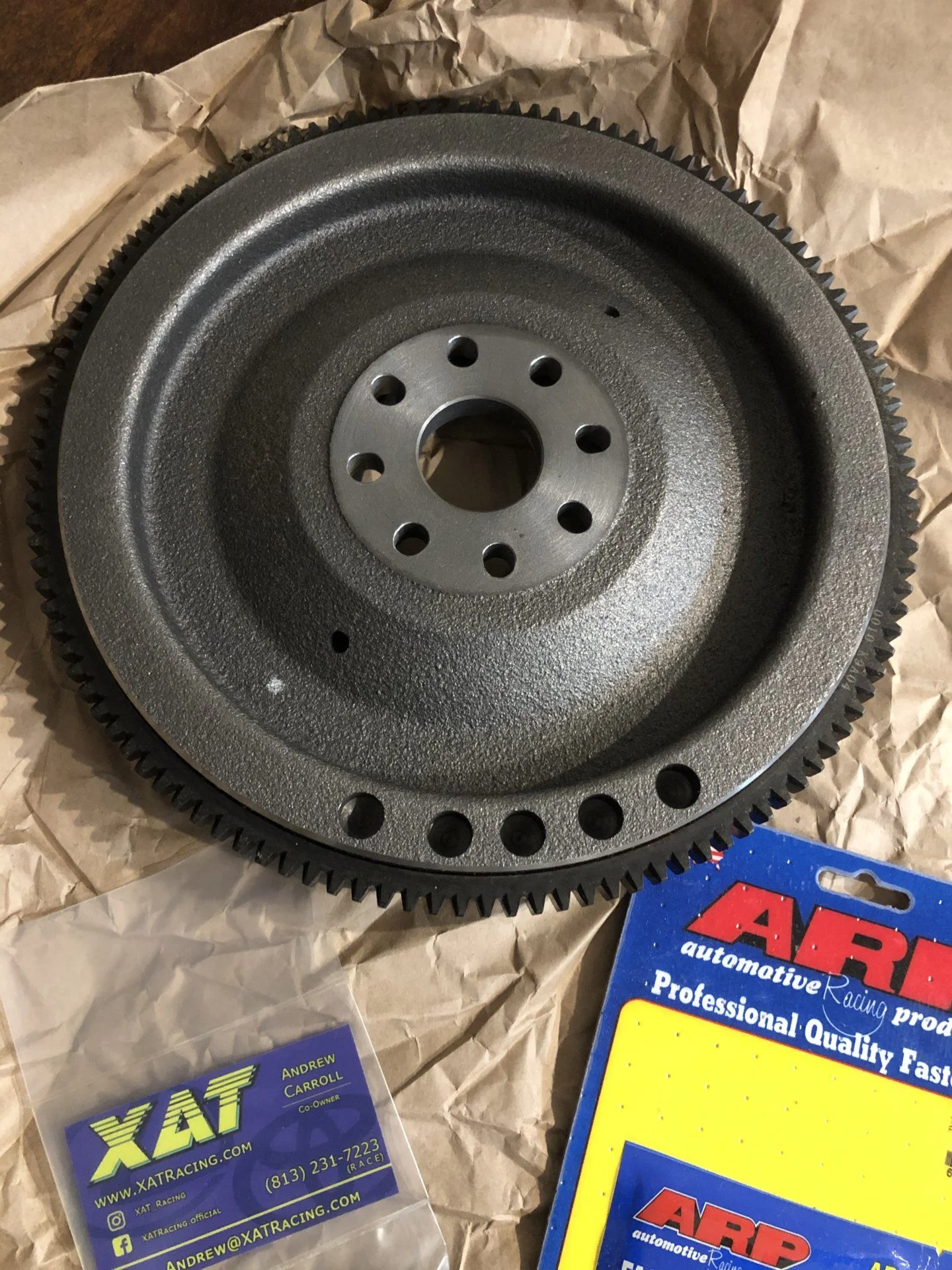

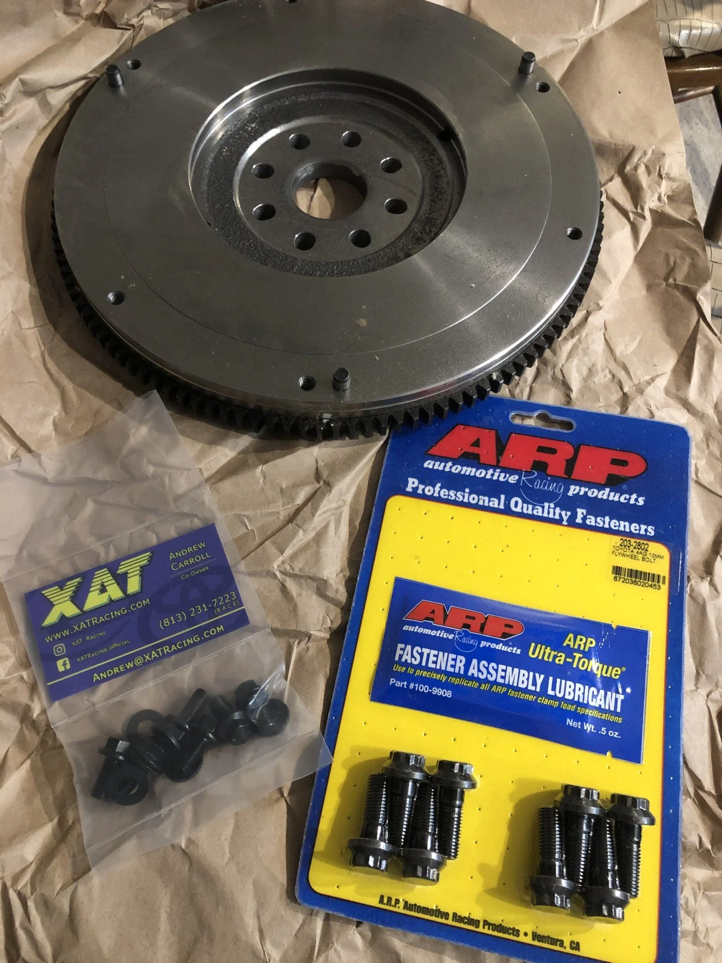

I haven’t had any dealings with Dellow. I purchased one of their bell housings and clutch kits from the classifieds here on mud.
The seller also included a flywheel.
The flywheel that showed up is for a boat 1uz and won’t accept a clutch.
I’ve since ordered one from:
I see. Hopefully that clutch/pressure plate works with that set-up.

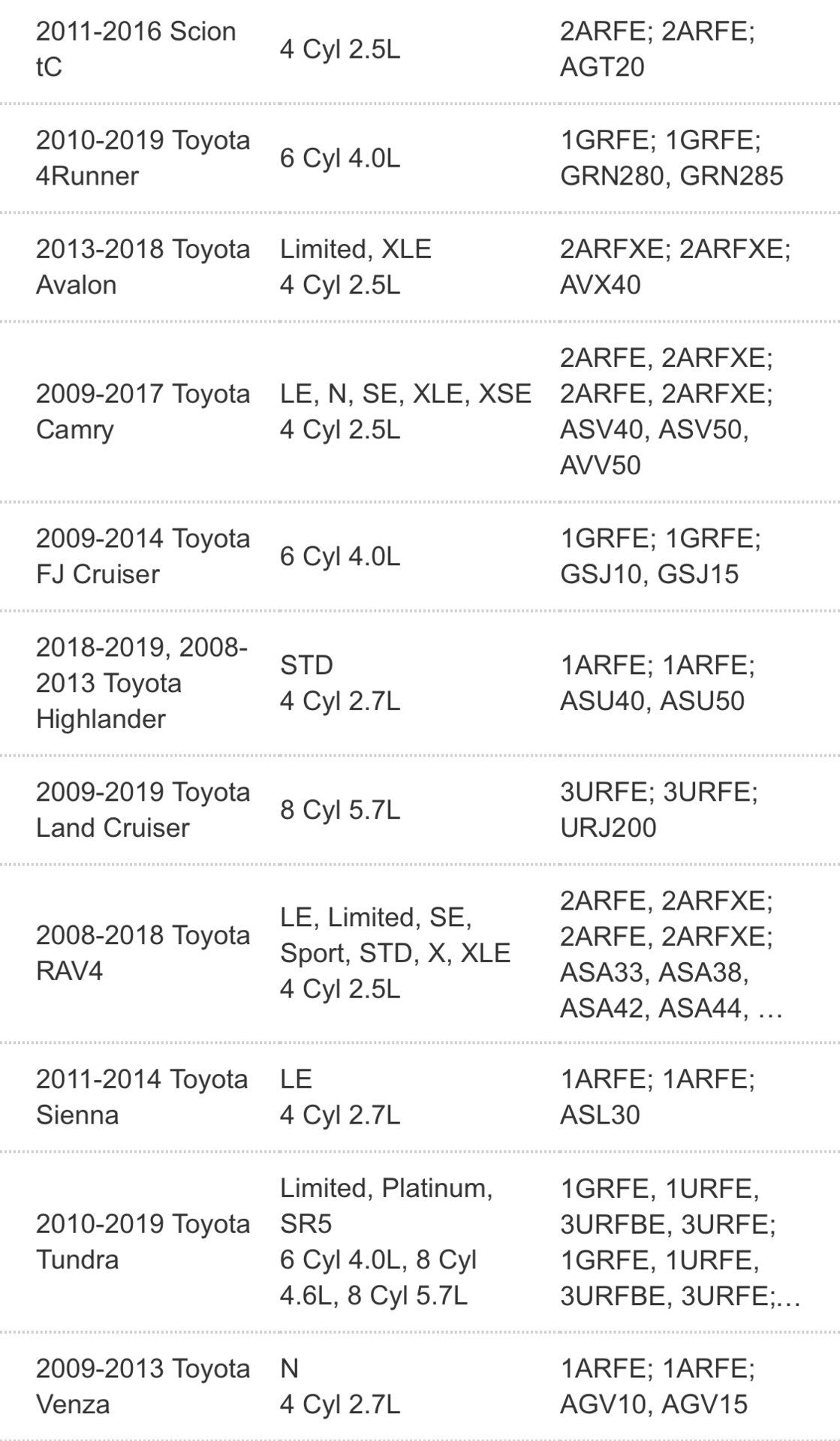

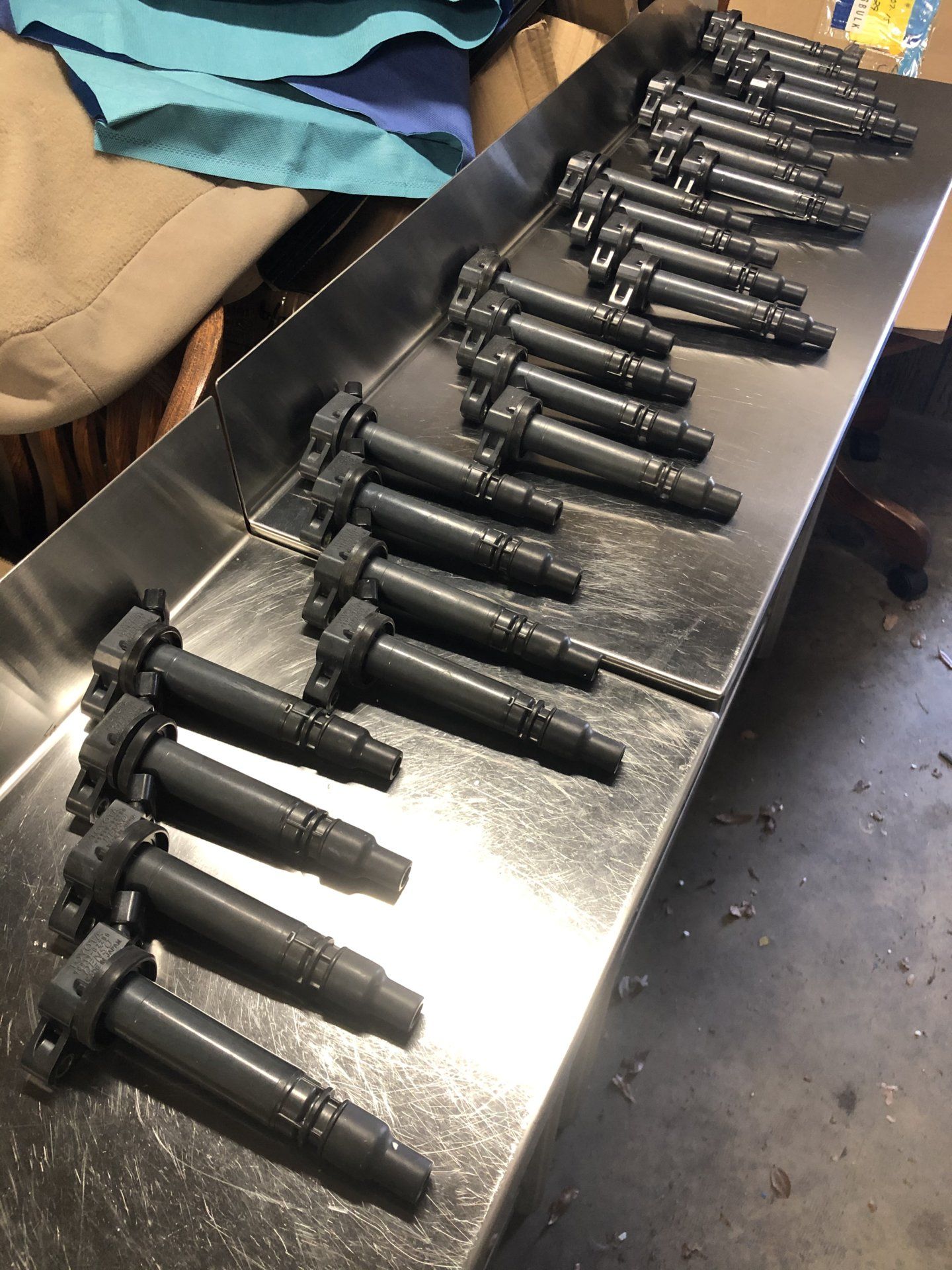

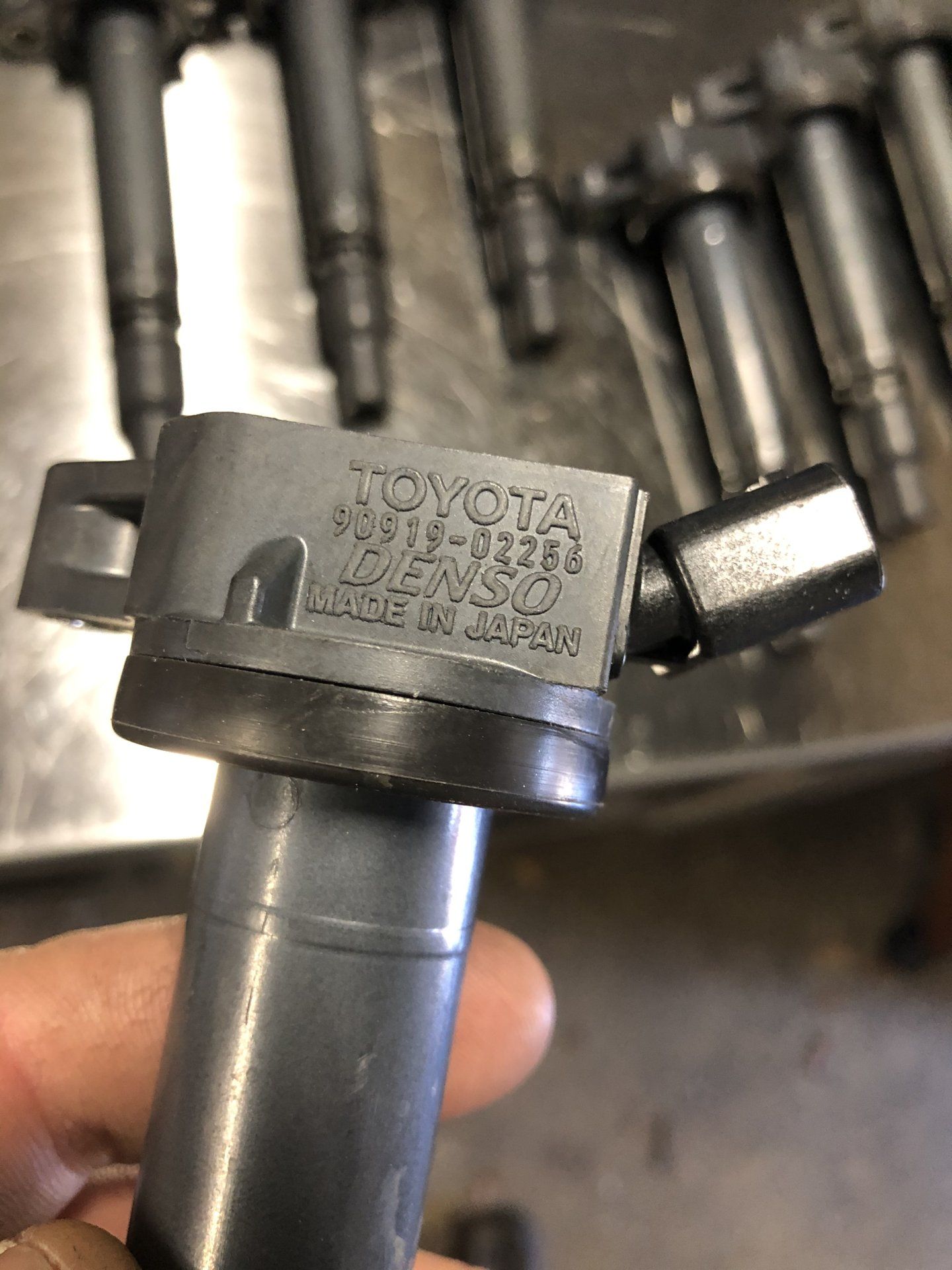

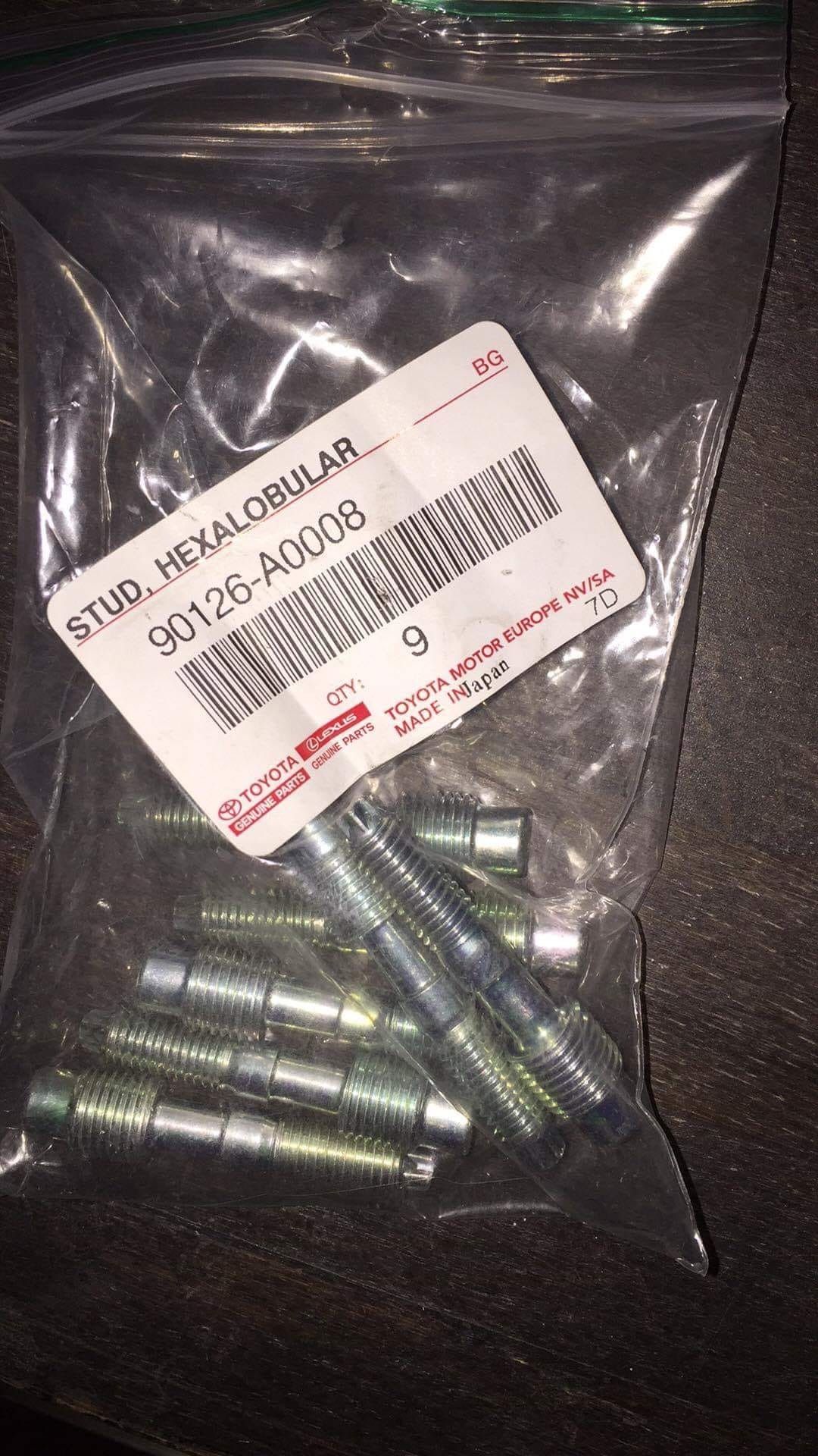

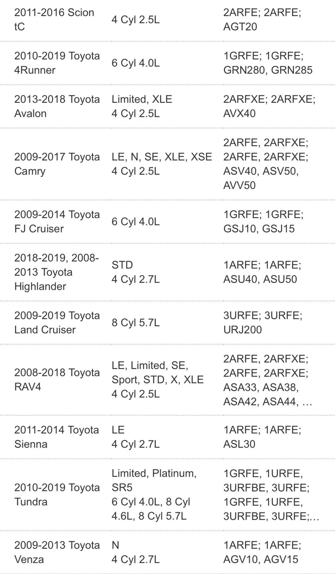

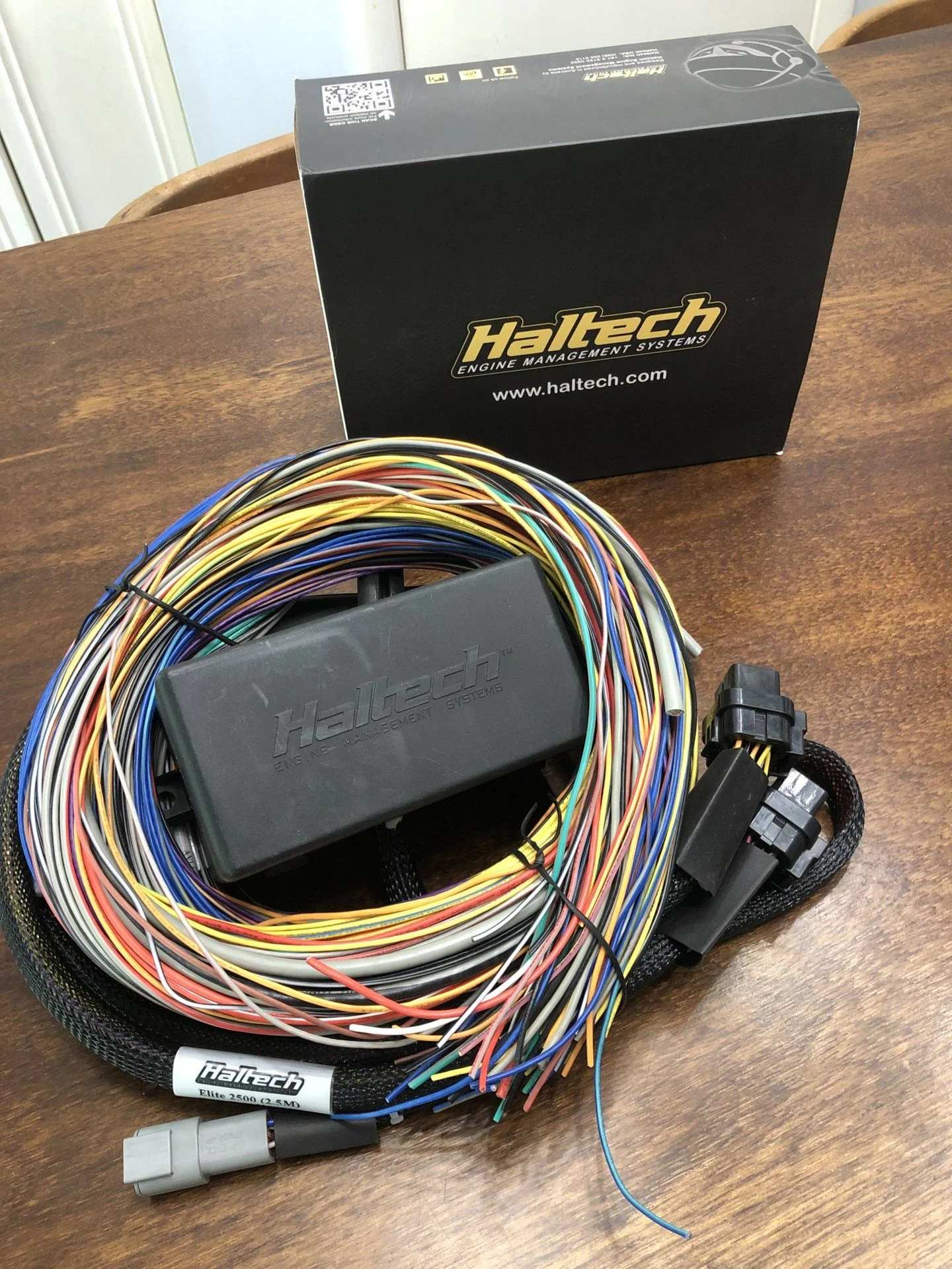

I’ll be eliminating the stock coil/igniter combo on the 1uz. The haltech likes 3URFE coil on plugs. Luckily other lesser model toyota engines use the same coil packs. I was able to get 25 of them for $100. I also ordered some studs from Toyota that makes them a bolt on affair.
And now a moment of silence for all the Toyota’s and scions that gave up their coil packs for my projects.

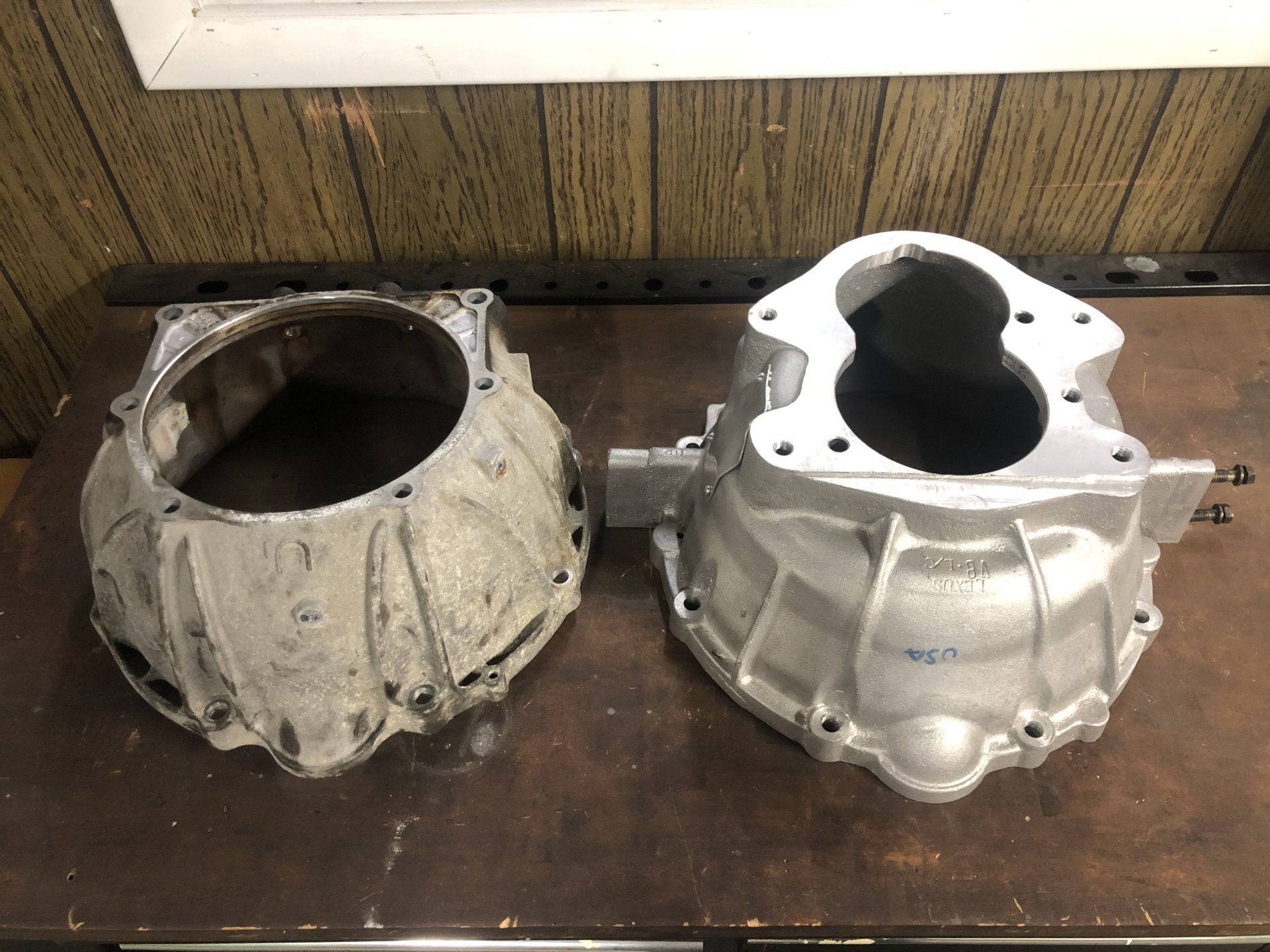

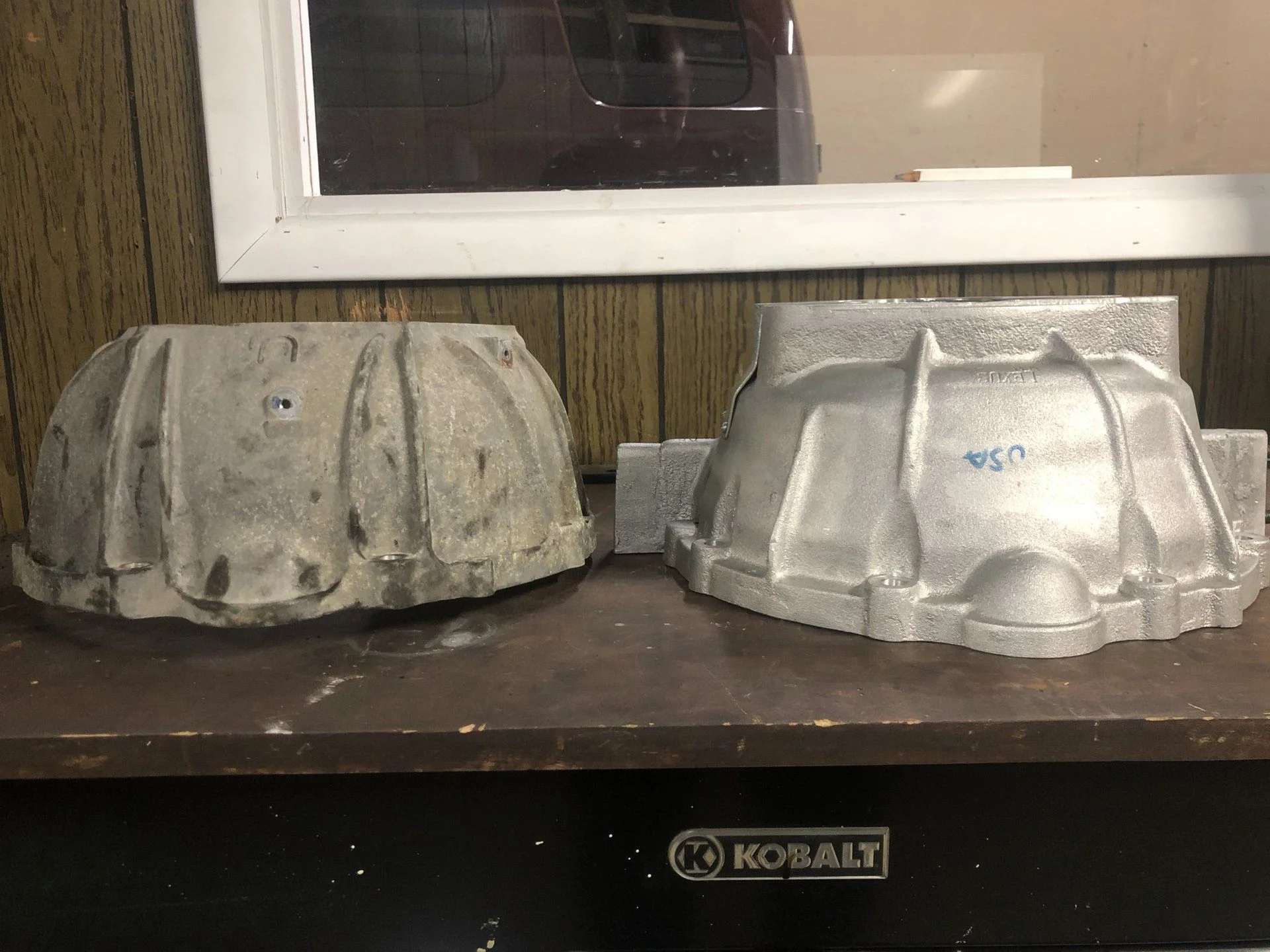

I’m going to see if I can make an adapter plate to mount off the Oem 1uz Bellhousing that will allow an h series trans to bolt on. This would eliminate the need for an expensive and difficult to source custom housing.

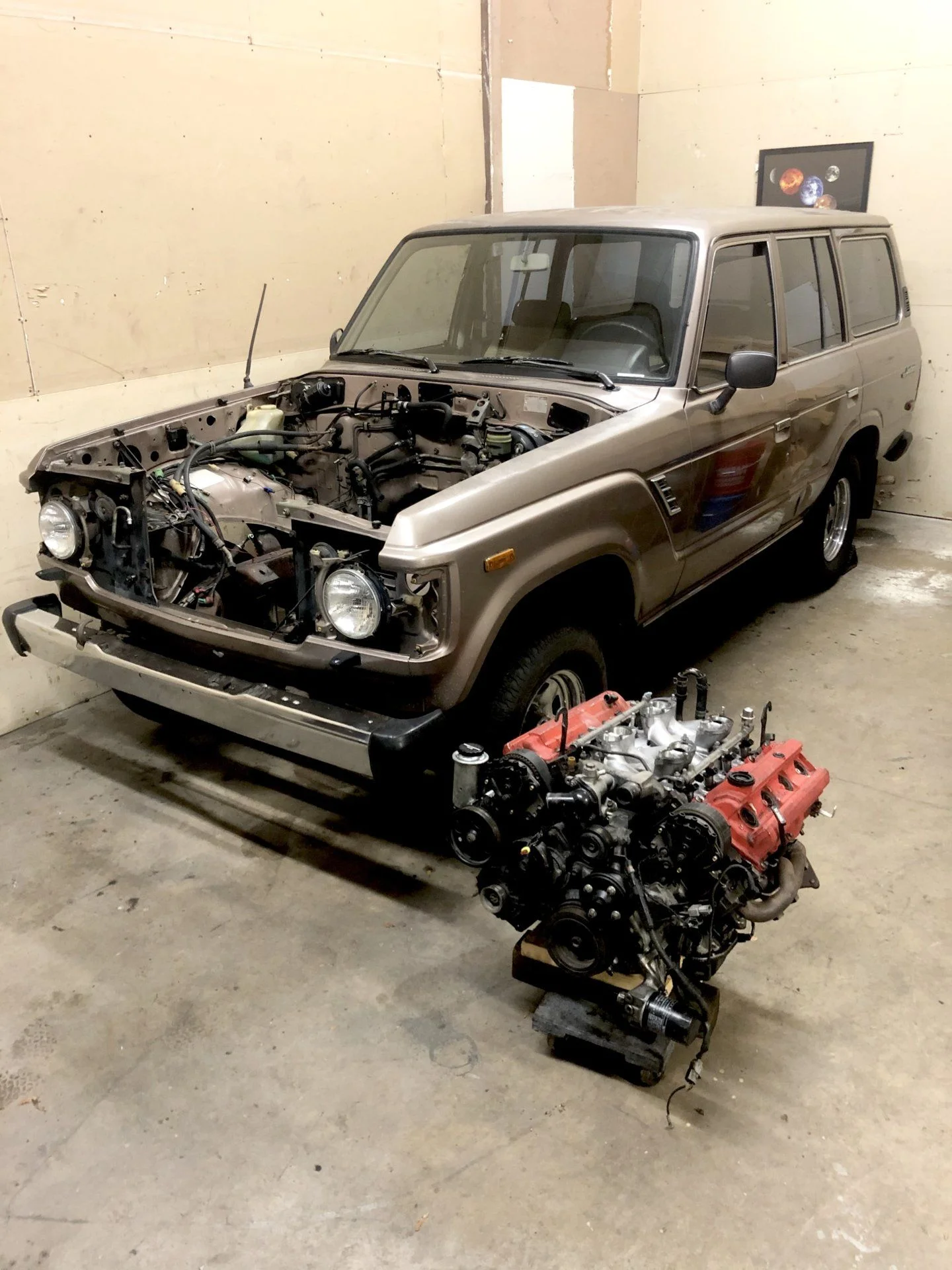

Looks like that engine is walking to its new home on its own😆
