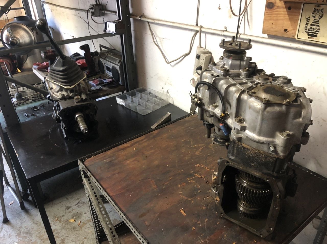

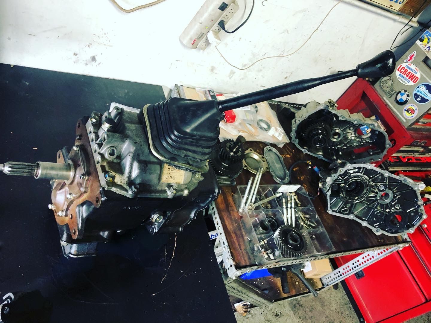

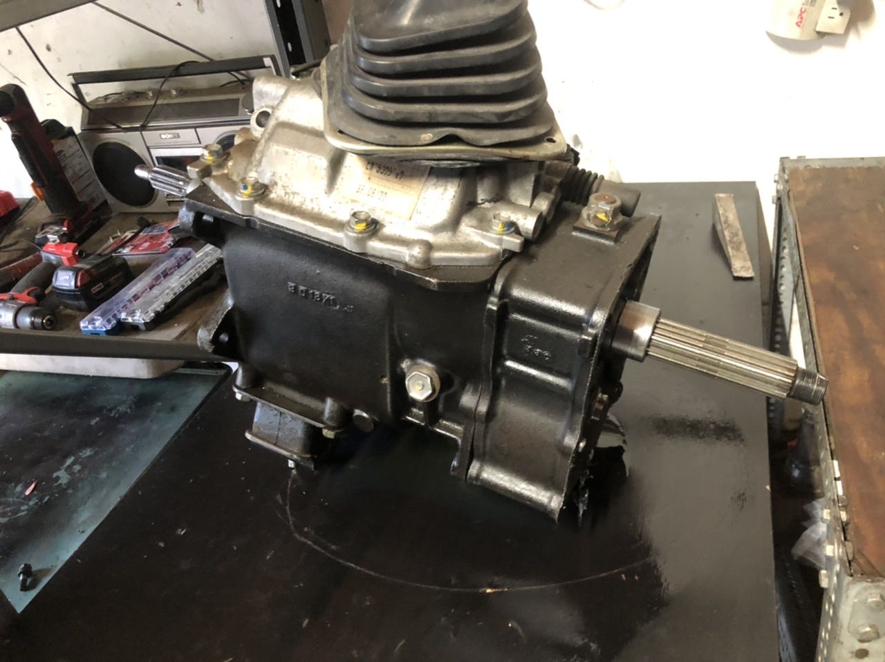

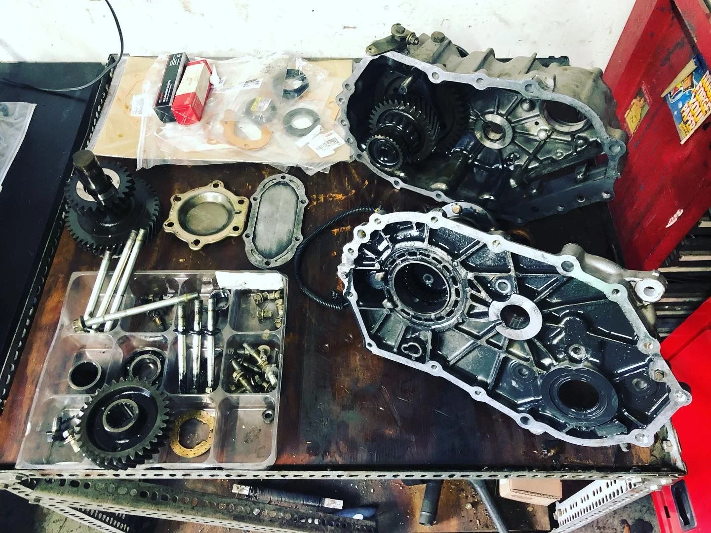

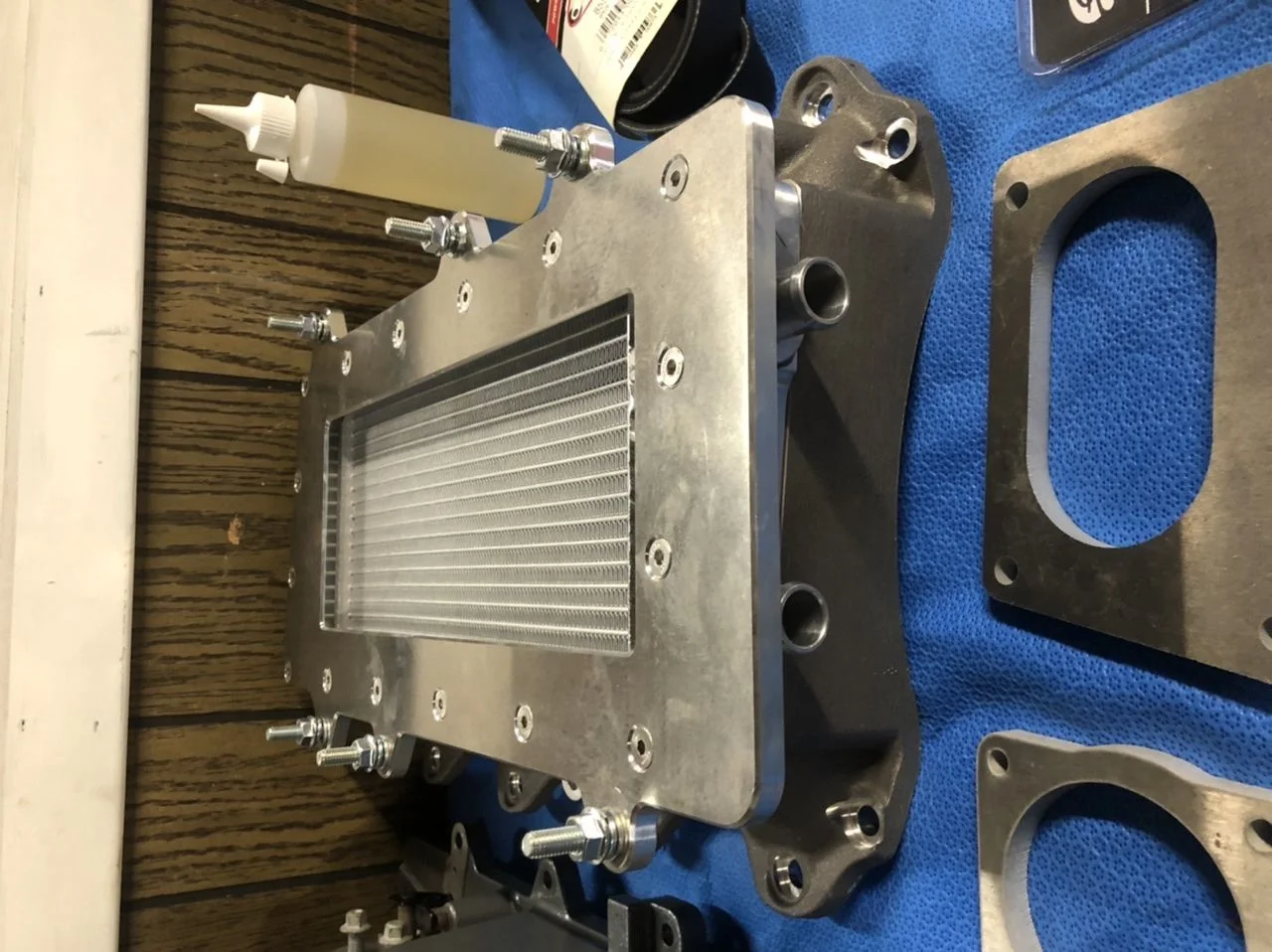

Cleaning up the rigs original xfer. I’ll be attaching it to the h55 purchased from Richard. He ghosted me after misrepresenting the case that came attached to the h55. It didn't have provisions for a 5th gear oiler.

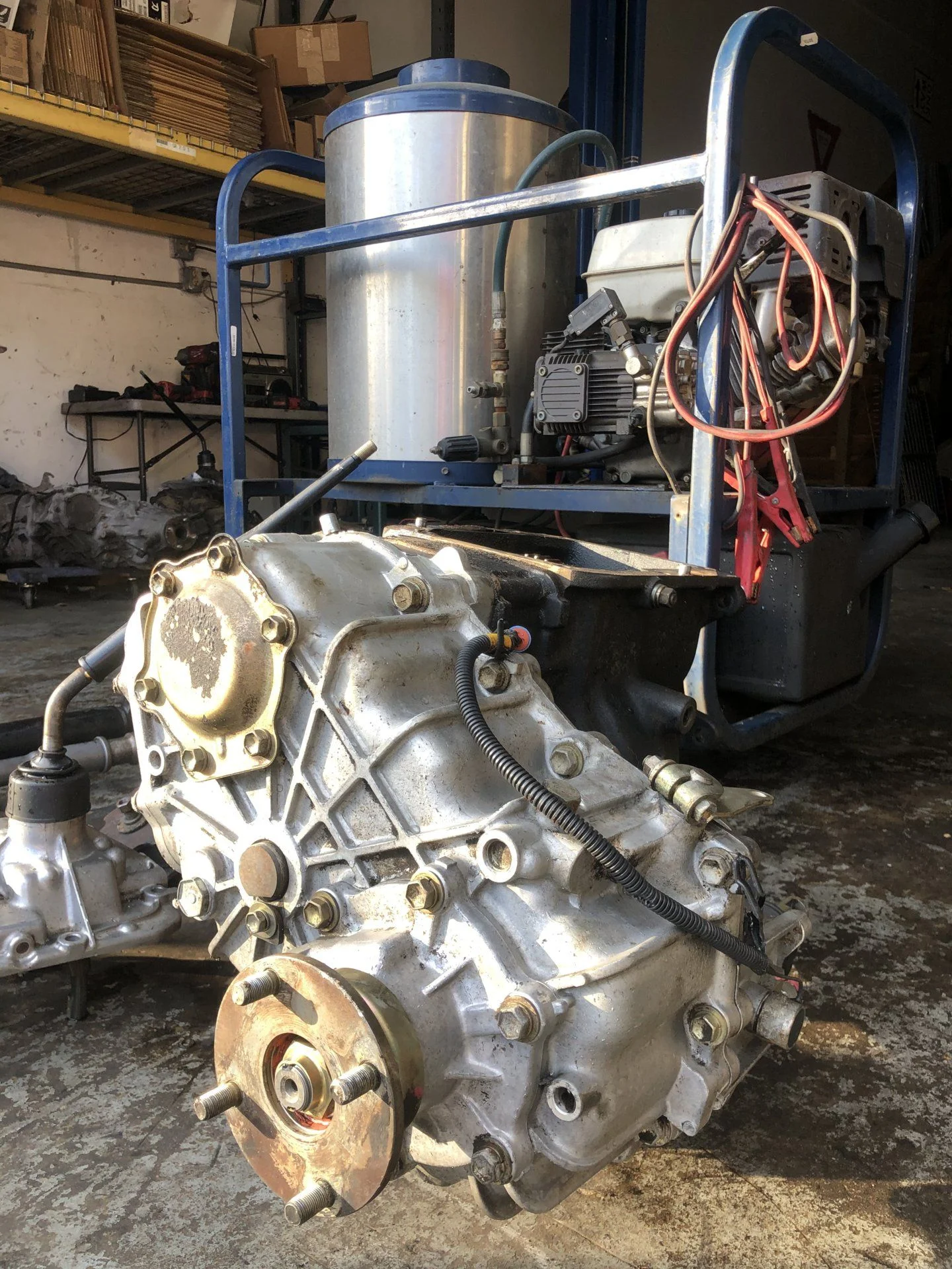

On the OR table, preparing for the transplant.

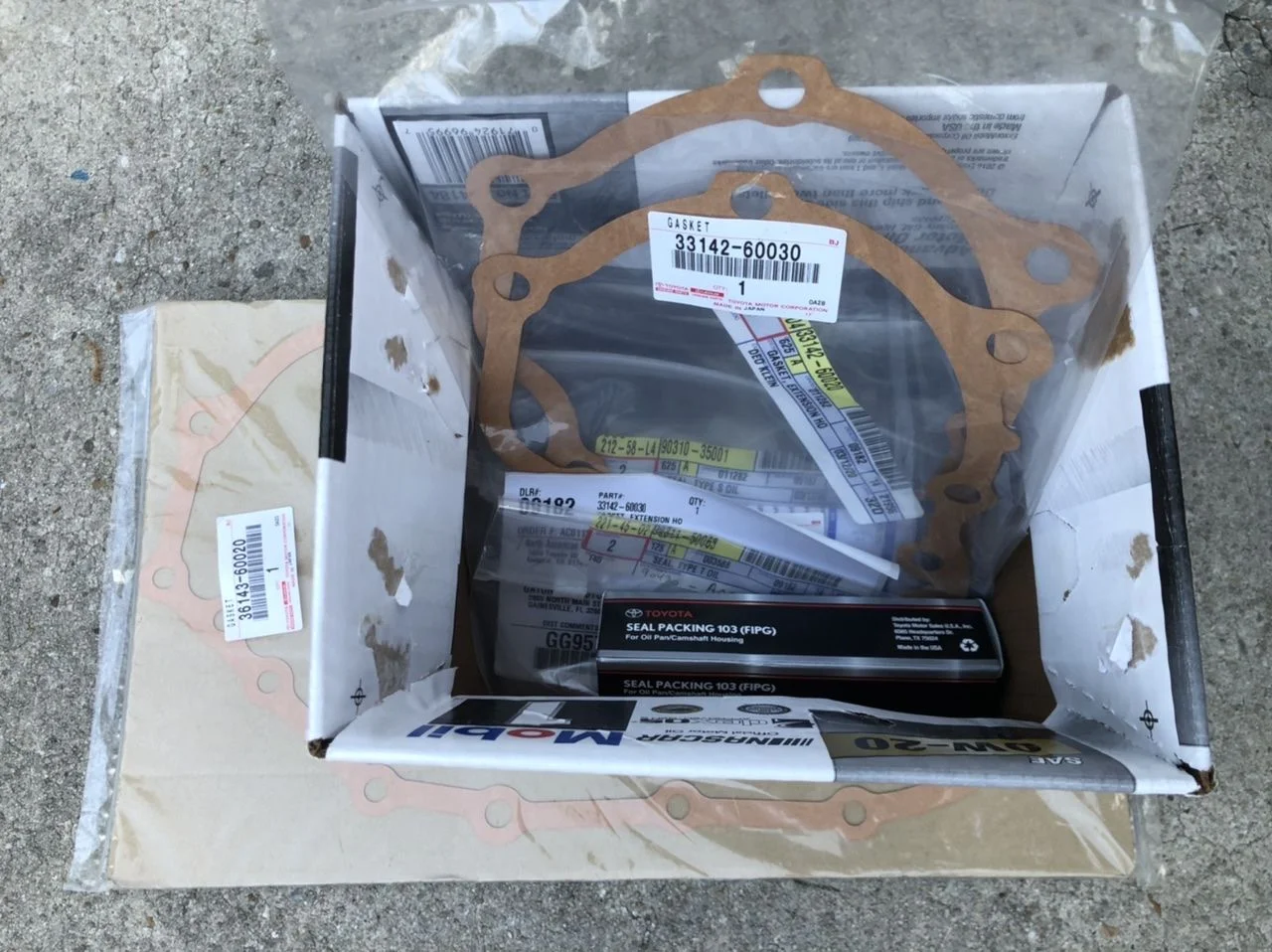

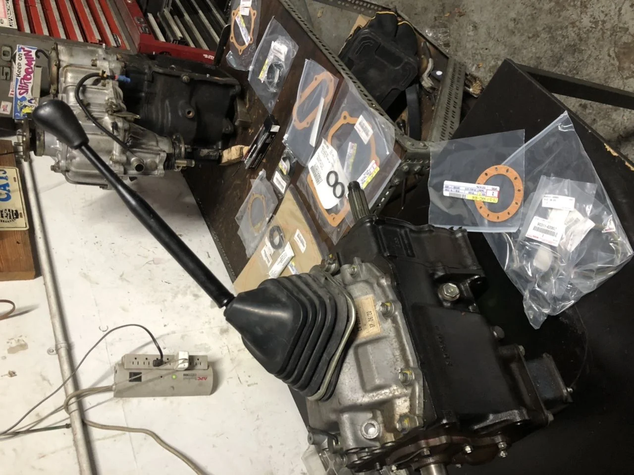

The case is going form the original Long H42 to the new H55. I’m waiting on seals and gaskets from my local dealer.

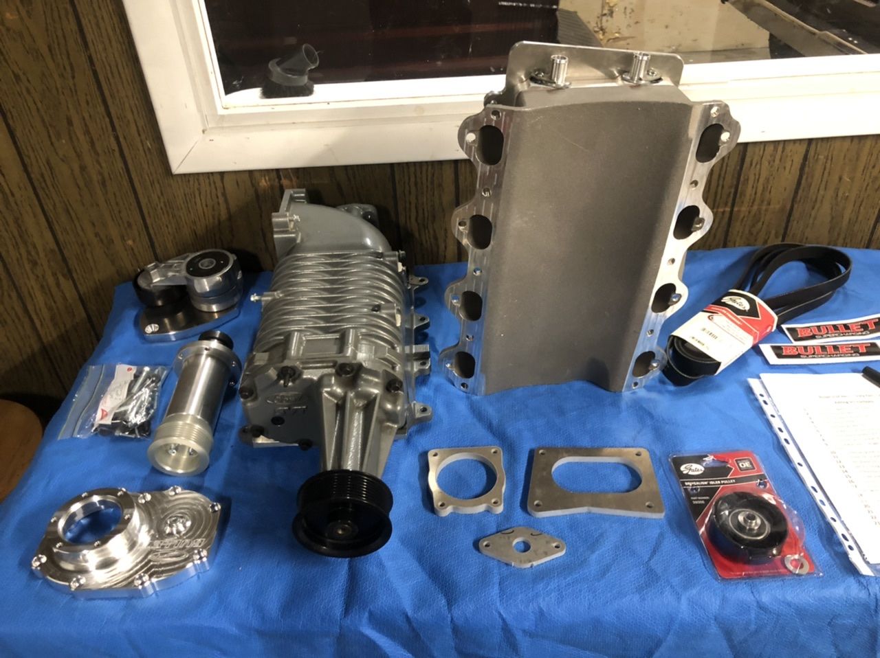

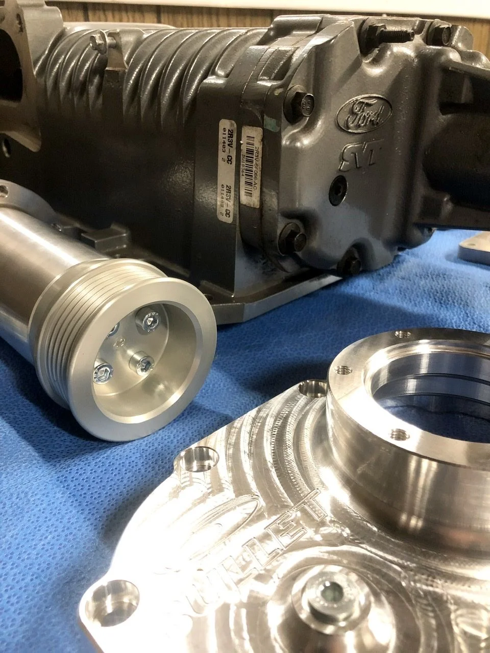

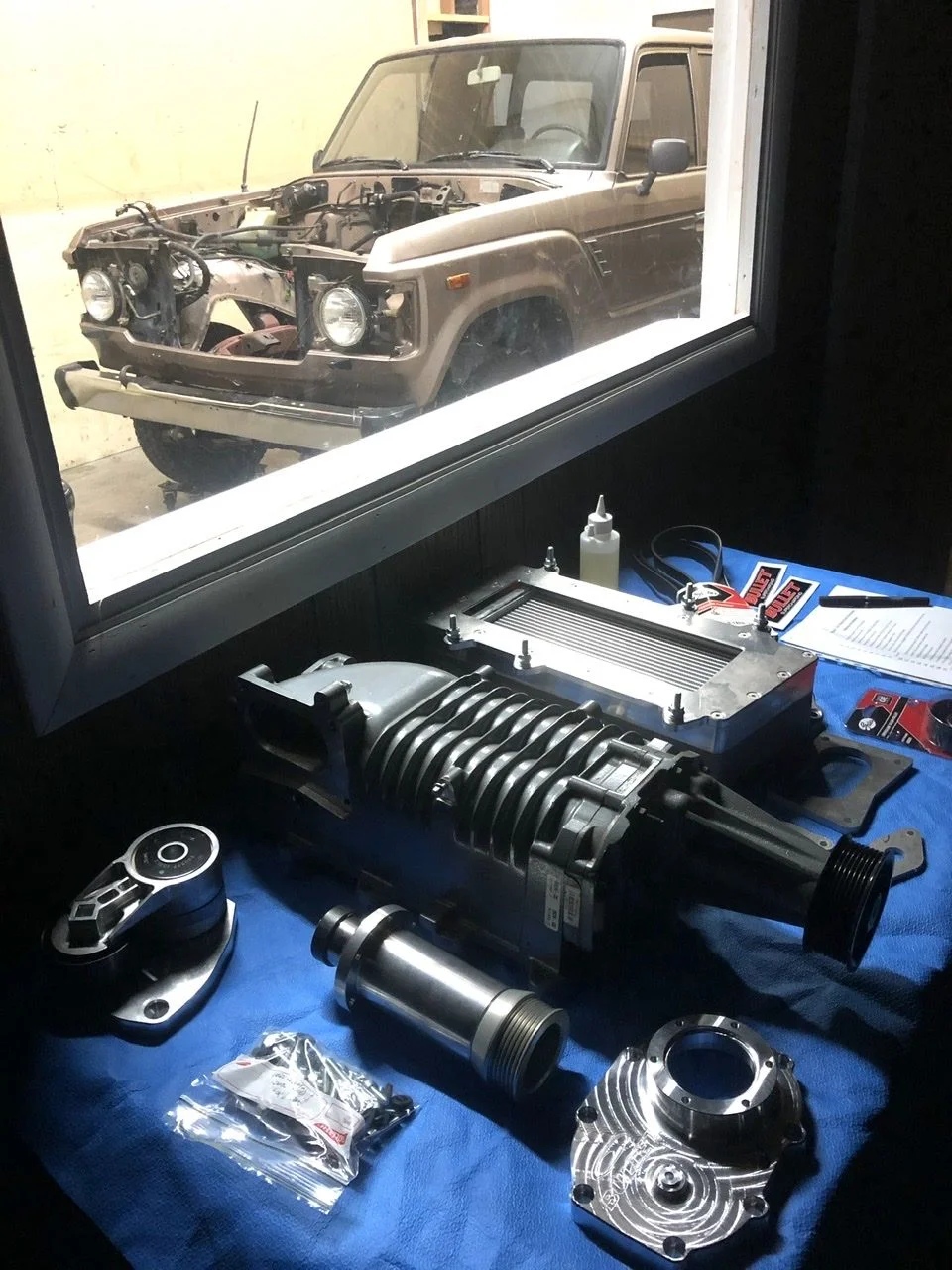

Might wanna put some tough loctite on the new pulley hex heads. That sucker is going to be spinning like mad.
This is gonna be awesome man! I think I have seen some rigs in Japan on YouTube, sporting the 1UZ under their hoods.
My last 60 was awesome, but so dang slow. 5x horsepower should be just right.
Isn’t that XAT flywheel for the “R” series transmissions? Hoping they make one for the H models

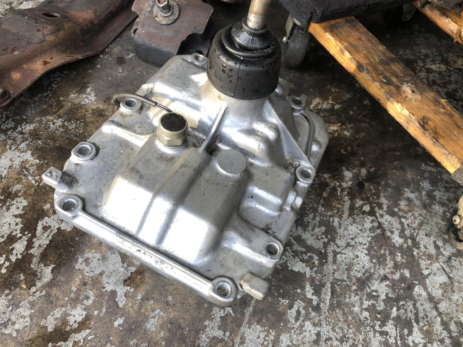

Be careful with the h55 standing like that. It’s no big issue, but, the shifter fork may lock on you and sometimes you have to take the top off to free it up. If you search mud you will find info on it, crushersrule identified the issue years ago.
