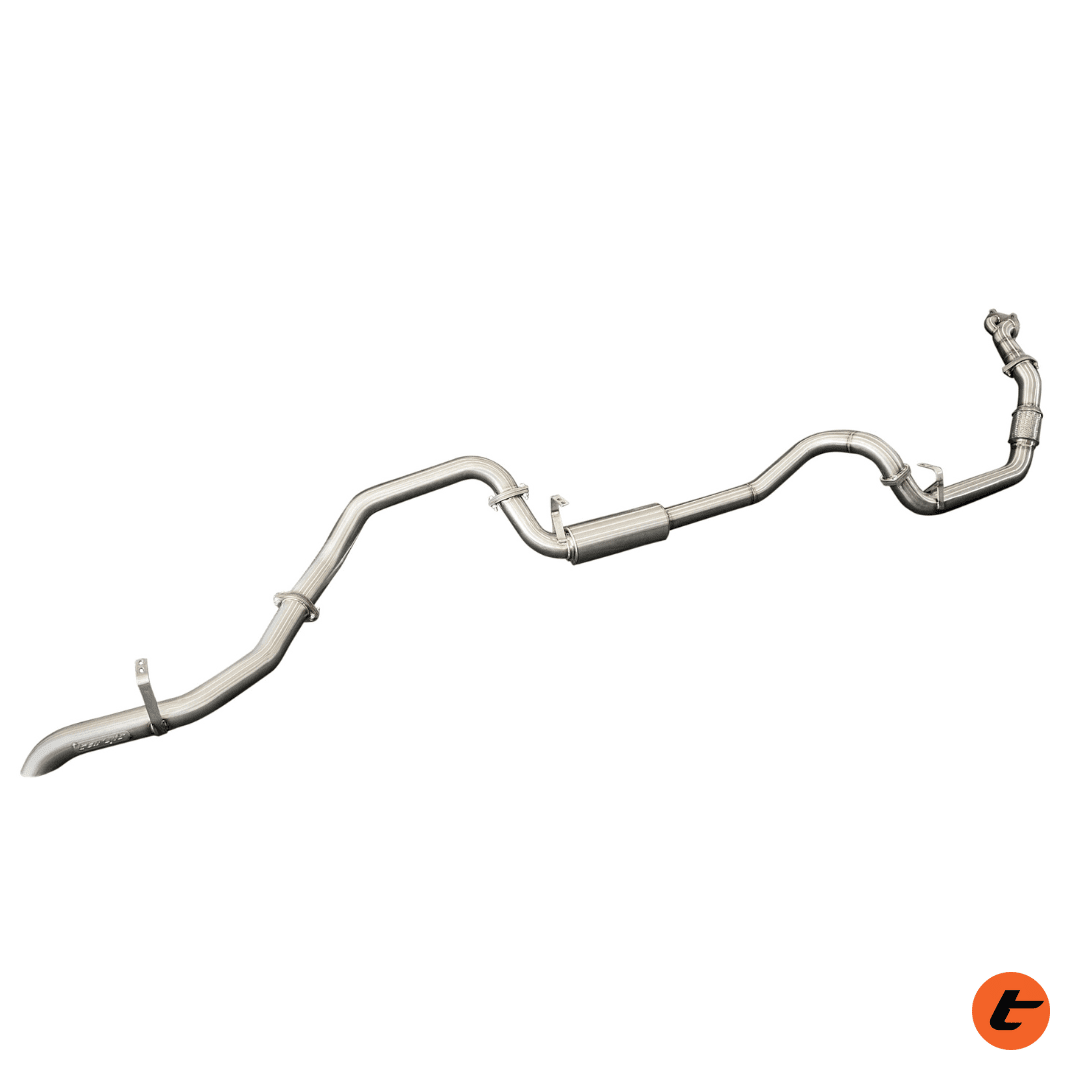

I had a rub on the tail pipe section as the hanger back there was very close to the body. During shut down there was a very noticeable rattle sound which I fixed with some shims and loosening and retightening the hanger nuts and bolts once positioned a little further in towards the center of the truck. I didn’t have the same rubbing as Ikarus did near the front. I have the RSS model and it is nice and loud. I love it.
I appreciate the detailed reply. Can you expand on the rubbing issue you experienced? Any photos of where that was and what you did to correct? Anything related to the exhaust fabrication?
I don't see any options on their site. Seems like only one type is available:
It was likely rubbing due to alignment. My exhaust rubs the rear crossmember. It needs shimmed but I'm to lazy to care.
No exhaust just "fits"
They all need loose installed and fiddled with. Sometimes you get it right. Sometimes you drive it and find issues.
Same rattle I have
Same rattle I have
Yeah that's been my experience too
Same rattle I have
You might have to go back from tail to down pipe and loosen/move, loosen /move and so forth. That’s what I did once I found the rattle. Once found, now quiet.
I have. I've had it off. The clearance on the exhaust is so small. I just ignore it
I'd suggest also looking at exhaust systems for HDJ100.
Much straighter pathway with the exhaust running on the inner side of the frame rail all the way to the back.
Example here ( no endorsement, affiliation etc)
