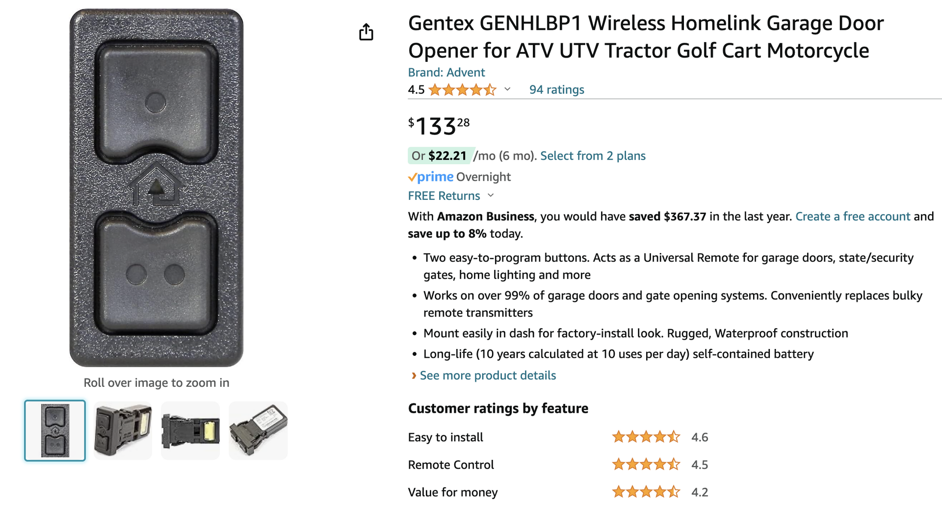

That is a great solution but at $250 its really pricey. I wonder if there is anything else with homelink that we could use.
I'm seeing it at $133 -
I’m in Canada so here it says $250 Canadian. I looked and a better alternative is a wifi sender for $50 that you can use your phone to open garage doors.
Gotcha. I’ll have to look into that too
