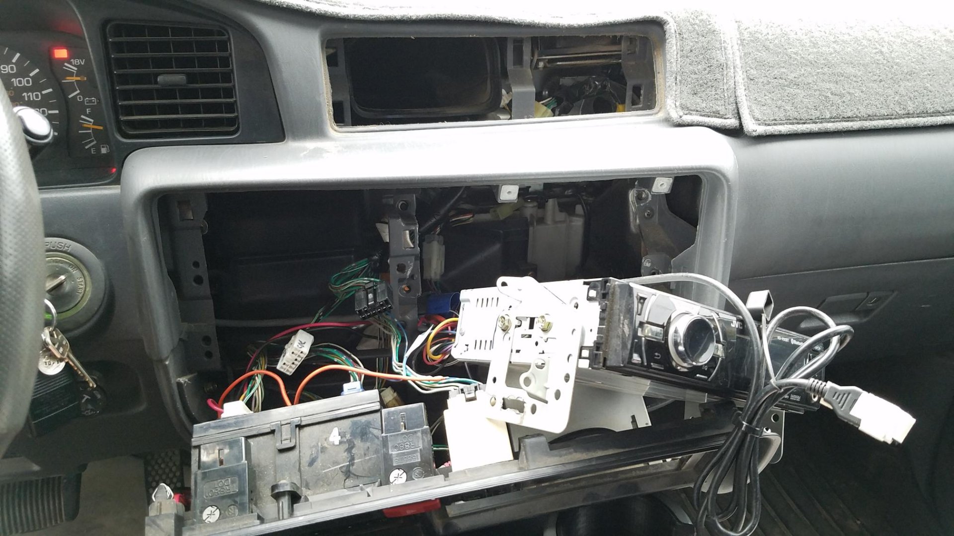

Cleaned up the cigarette lighter wiring, not sure what was going on here.
Multigauge in...
Function check - and success.
CarPlay, boost and EGT all confirmed. Cigarette lighter charging isn't working, I'll have to figure that out. I never actually used it before so I don't even know if it was functioning before. It's all tied up in another harness so I wonder if it'll work once I plug everything in.
As someone who's never done a wiring or stereo project before I'm relieved. Only took a month of YouTube and research on mud to psych myself up
