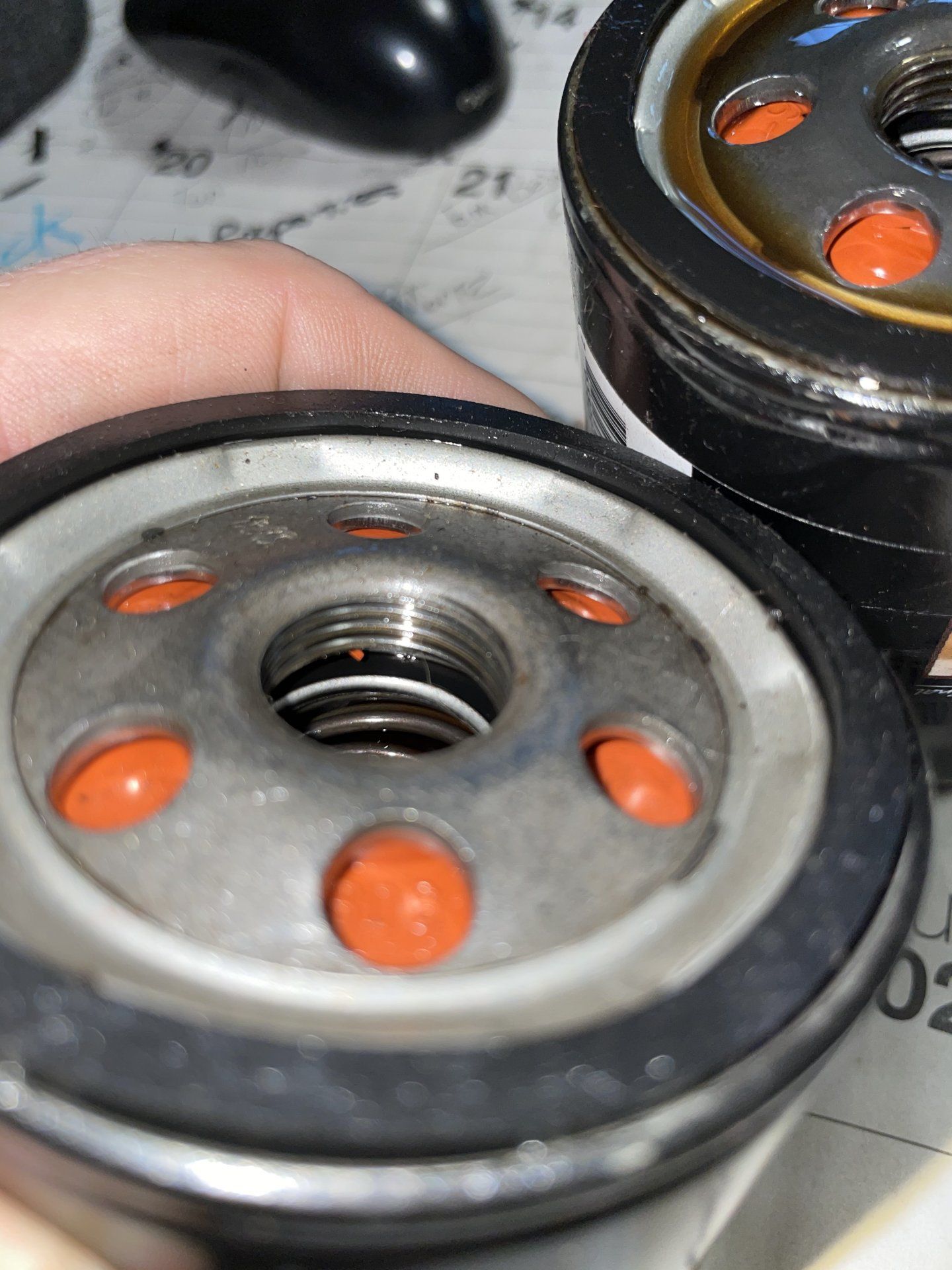

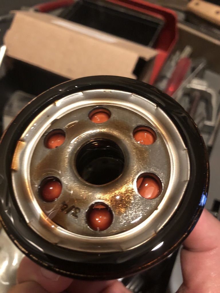

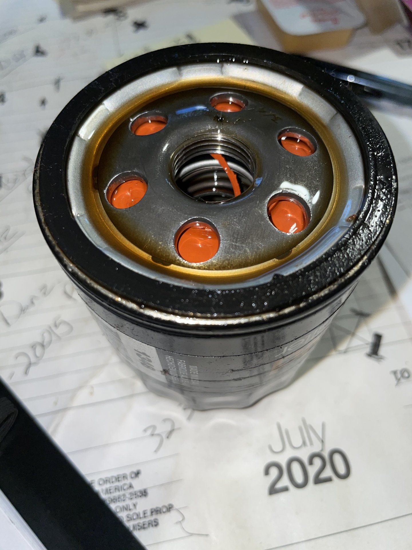

Another trashed motor in the shop. Looks like oil starvation from the noise and cam caps. Oil in the pan was full of bearing material. Pulled the Napa gold/ wix that was on it and guess what.
The other failed one from a few year ago appears to have similar valve issues.

Another trashed motor in the shop. Looks like oil starvation from the noise and cam caps. Oil in the pan was full of bearing material. Pulled the Napa gold/ wix that was on it and guess what. View attachment 2524714
Suck. My hypothesis is/was that the Anti-Drain-Back valve is impeading flow of oil into the filter. From my reasoning, there are really only two failure mechanisms in the filter that could possibly do this:
1. The ADBV jams/becomes stiff or brittle and does not allow for sufficient oil to move into the filter.
2. The bypass valve fails closed AND the filter is so clogged that it can not allow sufficient oil flow through.
I just don't see #2 happening. That would have to be such a dirty and clogged filter (in an engine that is known to run easy on oil) that a pump and bypass valve that runs at around 70 psi couldn't force enough oil through the filter media to keep the engine alive. I noticed a difference of about 65 psi difference just in changing the filter between failed wix and toyota. I could see a somewhat clogged filter decreasing from say 70 psi to 50 or 40 or something...but not all the way down to 5psi.
Looks like in the picture part of the ADBV is coming apart? Or are you seeing something deeper in the filter in the bypass mechanism? I had wondered if maybe wrong material is used for the ADBV and when immersed in oil they become more brittle/less flexible to the point where part of it just jams in there...or maybe a part of it detaches and is unable to move/allow oil flow?
