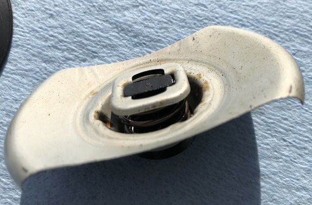

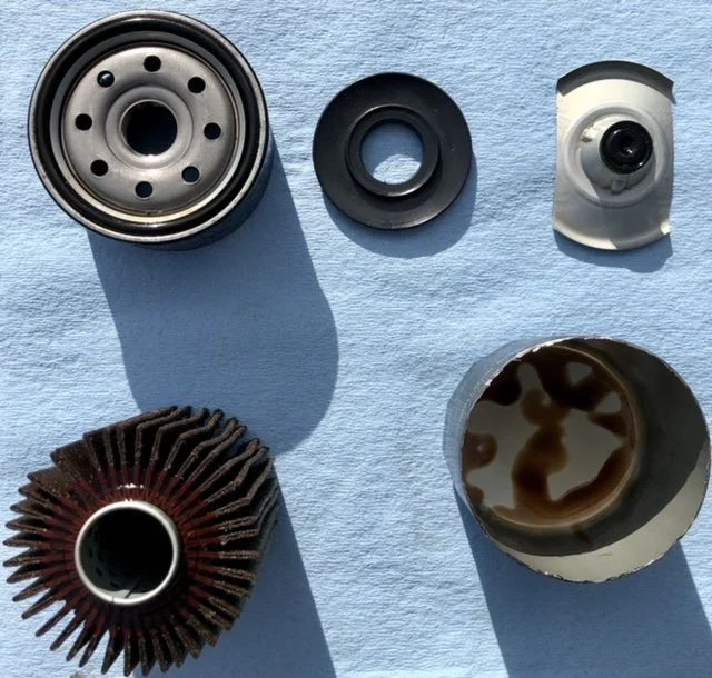

Since there were conflicting points about the YZZD3 construction, I dremeled one open. 5k miles and almost a year on the engine. Filter media is wrapped around a metal tube and epoxied (?) on either end. It is not tapered as an online reviewer stated about another model. The bypass valve is a coil spring assembly.
