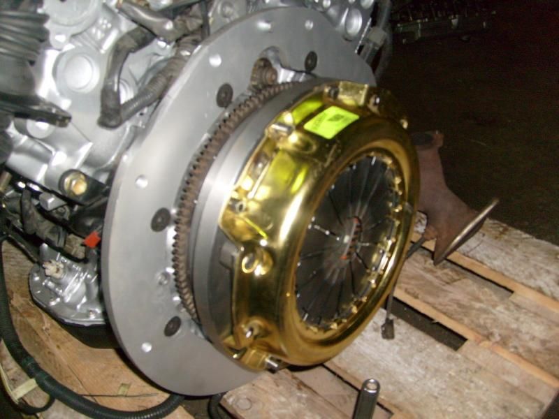

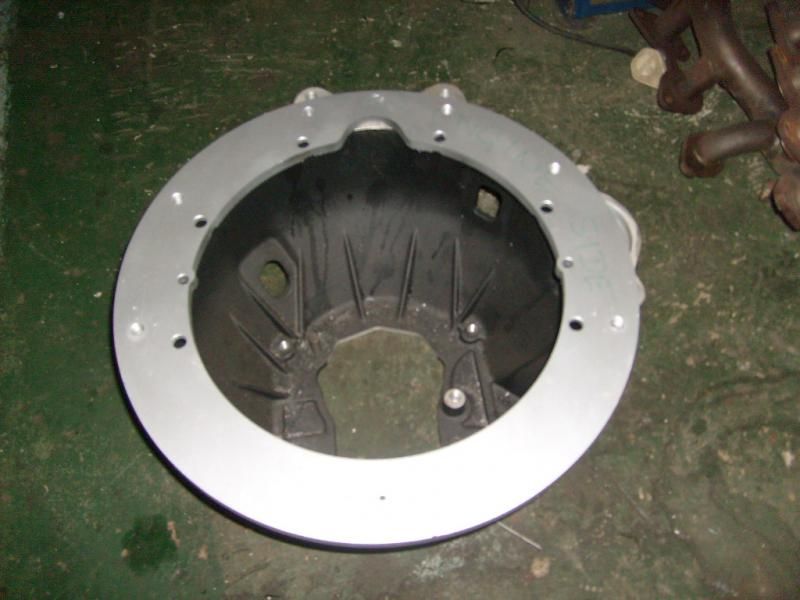

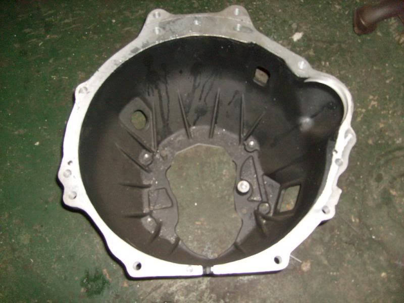

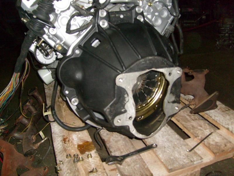

I have a quote for a complete kit to mate a 1UZ-FE to a H55 for ~$2k shipped, included the bellhousing, flywheel, clutch, pilot and throwout bearing, and a Spitronics ECU with a basic program that would make the engine run (needs final dino-program). This was for the non-vvti 1UZ, but could be purchased for any of the *UZ (4.0/4.3/4.6/4.7) series engines and for vvti for a bit more. There is a 40 thread that a guy in SA did this, I pinged him and he put me in touch with the mechanic who did the conversion.
