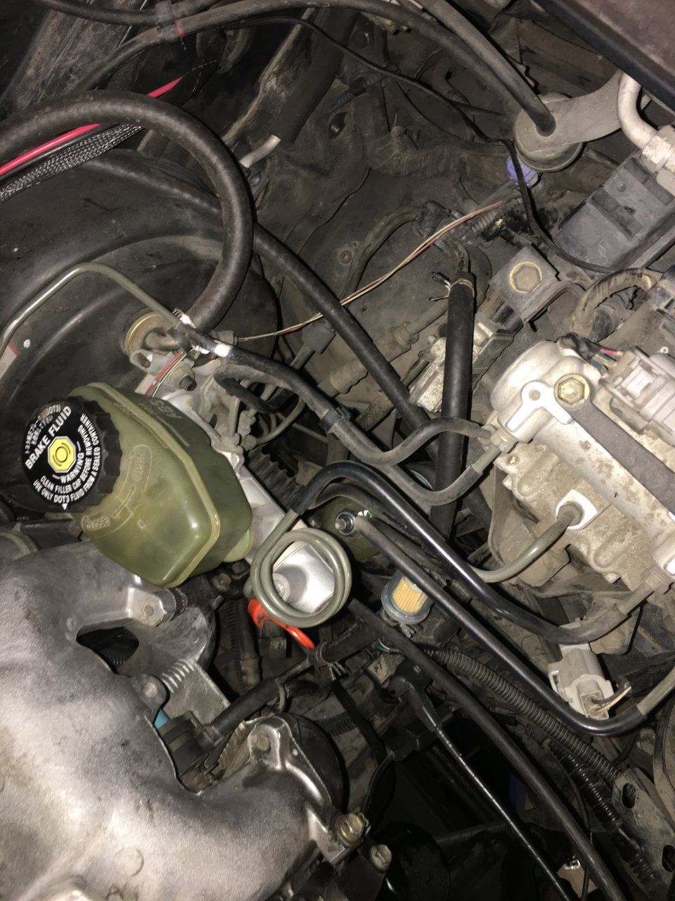

So, I should be ok with just running an inline fuel filter without a check valve.
I removed my EGR so the VCV isn't active (I should just remove this too...).
The only concern with running this way is there is no way to "vent" like out the bottom of the charcoal canister...
Thoughts anyone?

At the risk of opening a can of worms and a 9 month old thread I replaced the CC with the AutoZone VC120 which fixed the fuel tank pressure issue but 2 weeks later I still have the very strong smell of gas. Wife won't let me put the truck in the garage because of the smell.
Tried the fuel filter trick on the tank pipe but so far I still have the gas smell. I have left the CC in place and connected to the VCV . Smell might be coming from what remains in the CC so I will leave it a week. I checked that the VCV draws a vacuum (not measured -just felt it).
Not sure if it is typical but I only get the smell when the engine is running or has just stopped. If I leave the truck an hour or so there is no smell - even in an enclosed space. This makes me think something else is at play than just just the tank venting. I am also sure it rules out the cracked tank possibility.
