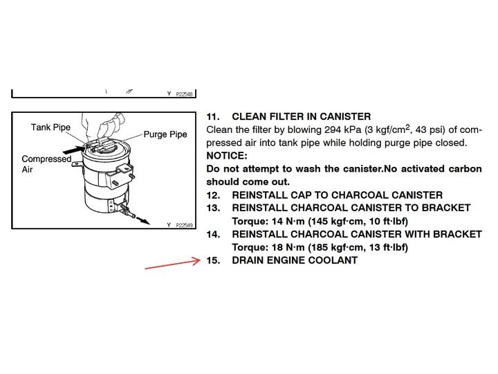

random question:
Why in fsm for Charcoal Canister inspection, step #15 "drain engine coolant?
Specifically: I just replaced mine with the AC delco part...do I have to drain coolant?
View attachment 1366114 random question:

I think I answered my own question. Looks like it is part of the next step in diagnosis of emission system...ie procedure for removing and bench testing TVV...
