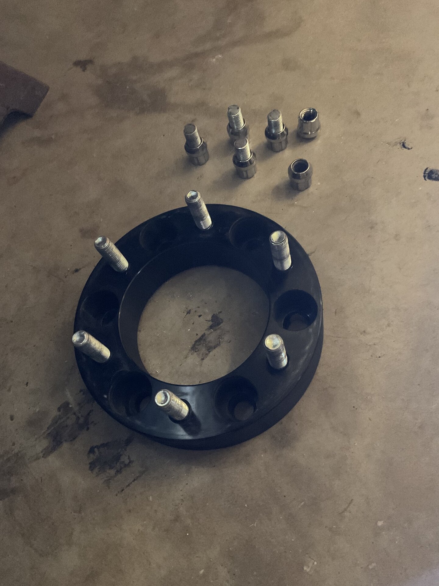

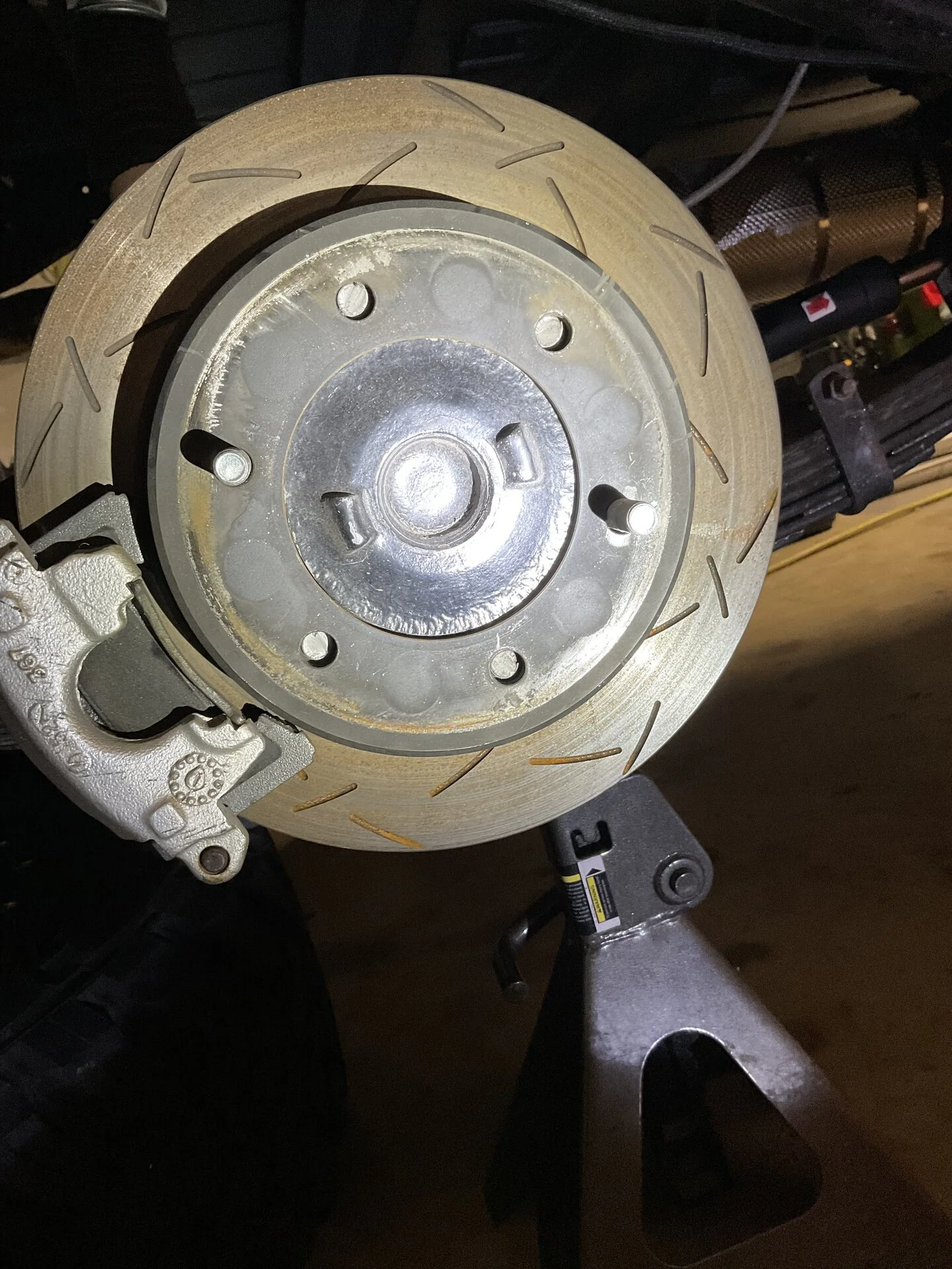

I did a front and rear disk brake conversion.
4 in lift and running 33s
The reason is kinda long story. Last month I sheered off 4 lug nuts doing 45mph. I almost lost it. The research led me down the path of needing a hub centric hub instead of a stud centric hub. The FF will give me the hub centric I’m looking for. Mainly just for safety sake.
I have run lug centric spacers on two of my 40's without issue. If the nuts are properly torqued, it is no issue. If there is an interference issue with your wheel spacer and the axle shaft which doesn't allow the spacer to get tight to the drum and develop clamping force from the torque of the lug nuts, then your issue isn't with the axle or the lug nuts, but the space. I do not agree with your conclusion that you need hub centric and a full floater to safely run wheel spacers.
If you want the width without spacers, I would go with an FJ60 semi-float rear axle. There are other modifications likely necessary to do this, but if you have the means to cut & weld, all it will take is some time. Full floaters are not cheap. Swapping to a full floating rear axle so that you can run wheel spacers "safely" is not the path I would go personally.
More likely you just forgot to tighten them. It happens
Yeah, I’ve come to that conclusion as well. That’s why I talk with you guys. I can’t thank you enough. I’ll keep what I got and keep checking my torques and red lock tight.
